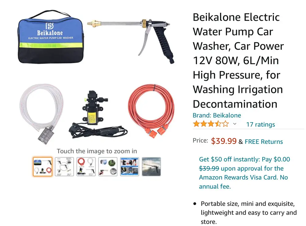

I have the one mentioned above, but like this one with a metal lance.

Buy a portable pressure washer as stated. Also if you're following these people through the mudholes, they stir up all the debris and your radiator picks up all the garbage. It's happened to my buddy numueros times. 3 pioneer 1000s in a row and the 3rd machine was picking up all the gunk. Go slow through all the big mudholes that doesn't require you sending it.

Wow, I’m mad I didn’t think about this 😂
