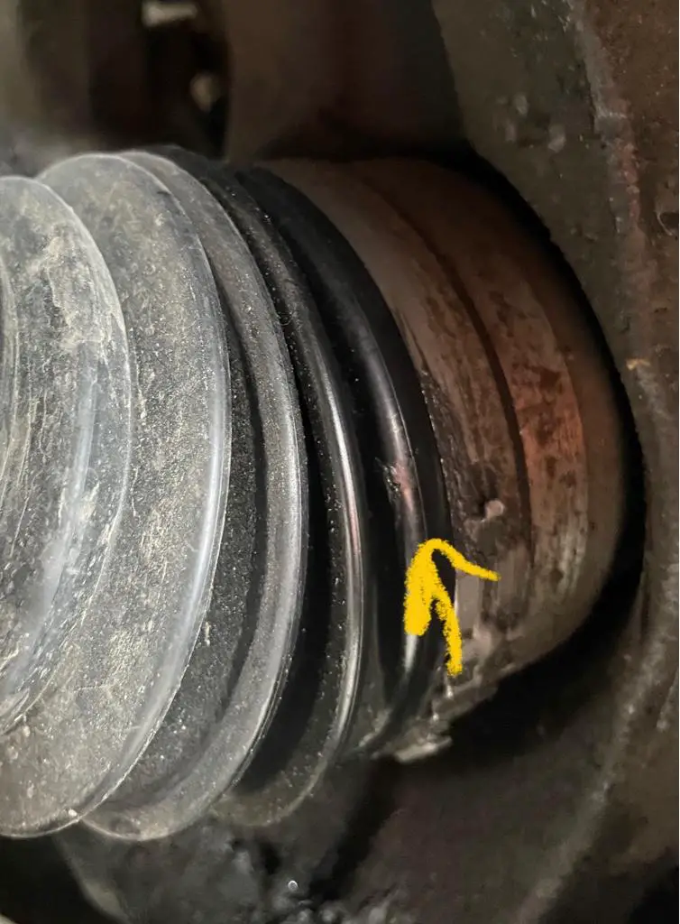

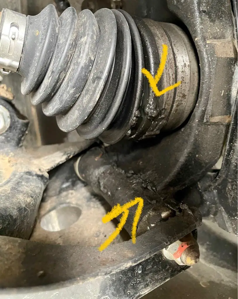

I noticed there was a bit of grease on the axle boot behind my rear passenger tire. The other tire is clean with no grease. Is this something I should be worried about? F24aa8ad31605c64e429313bf8cec370

I noticed there was a bit of grease on the axle boot behind my rear passenger tire. The other tire is clean with no grease. Is this something I should be worried about?View attachment 333937
I would clean it off real good and look for a hole in the boot. If grease is getting out water will get in.

I'm fairly certain I won't have to take bearings out and clean them since it's a small hole and it hasn't been there long.
You shouldnt have too.
just get the standard boot, grease and band kit.
Or if you want to be a Guinea pig, get the one u posted and do a video of it and post it here so we can see how it works.
