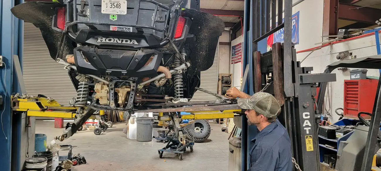

I put the forklift against the frame and pulled tight and tried tapping on it, we tried tapping on it as we turned it, and we also tried putting an air chisel with blunt end on it to vibrate it out and nothing is working

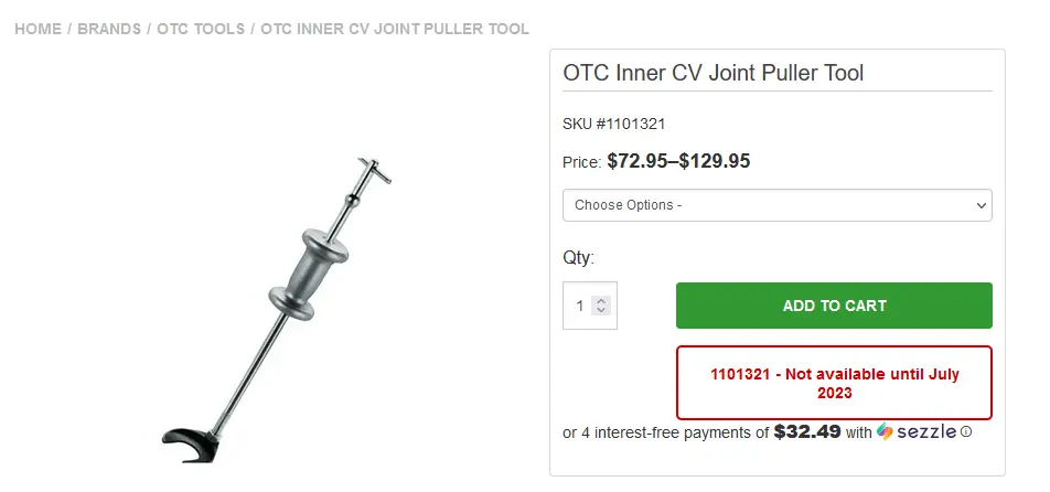

Any chance something like this will/might work?
I am not familiar with how much room in on a Talon diff.

I had to give the prybar (post #3) a few really good hits to get mine loose (idea shown in the video). You're working in a well-equipped shop, I'd copy the slide hammer in post #3.

Not enough room to slide the black piece in there.
It doesn't have to get between the CV and diff, the 'black piece' jaw is wide enough to straddle the CV taper. The grabbing U shape only has to be deep enough to get past the centerline of the CV diameter on the tapered surface.
Yea, its too tight for that. The opening isn't wide enough to get it back there. But I work in the steel industry. I am going to have one of my customers laser cut one that will work for the future needs
