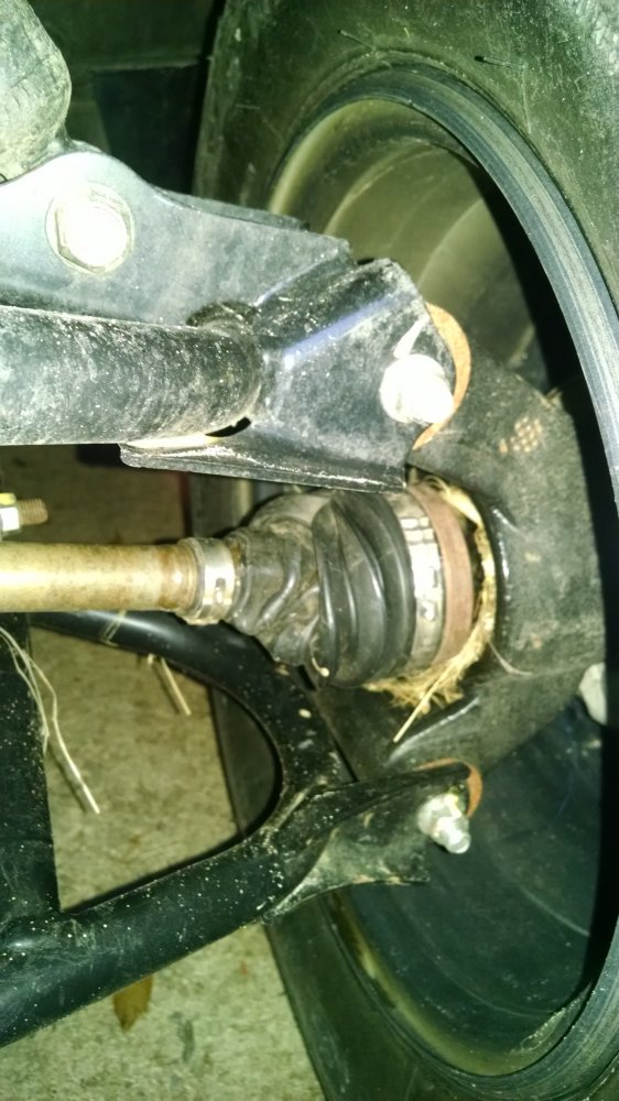

Mine use to do that. I replaced all the rear CV boots and it doesn't do it now. IDK if it will work for you but it fixed mine. I had holes in my boots so thats why they all got replaced.
Mine use to do that. I replaced all the rear CV boots and it doesn't do it now. IDK if it will work for you but it fixed mine. I had holes in my boots so thats why they all got replaced. New grease. oh 700 tho
joey400ex
joey400ex
Mar 18, 2015
49
31
Right rear boot has a dent, I did not even think about the U-joint being bad? It is more of a loud pop that you can feel. Can the U-joint go bad in just 6 months?

I pulled the dented boot off, it still has grease in it and I could see some water beads. I added grease the CV joint and the noise has not changed, is the rear end a positive traction? When I am in reverse and have the wheel turned as far as it goes either to the right or left on concrete there is a popping noise in the rear, it does this on both side depending which direction I go. I checked the axles and there is no play in them and they have grease. I only have 90 hours on my P500. Can this popping be normal, once I straighten the wheel the popping stops. I did change the rear end oil and it looked fine. Any thoughts or suggestions? I drive in a lot of water in my hunting club but find it hard to believe the axles are going in just 6 months.
