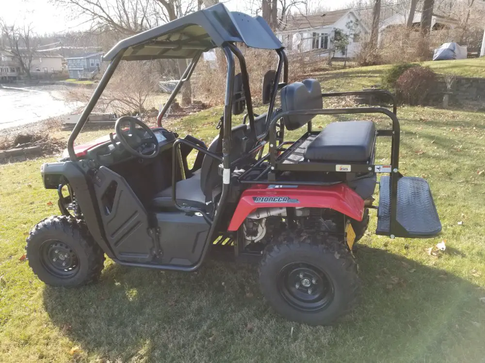

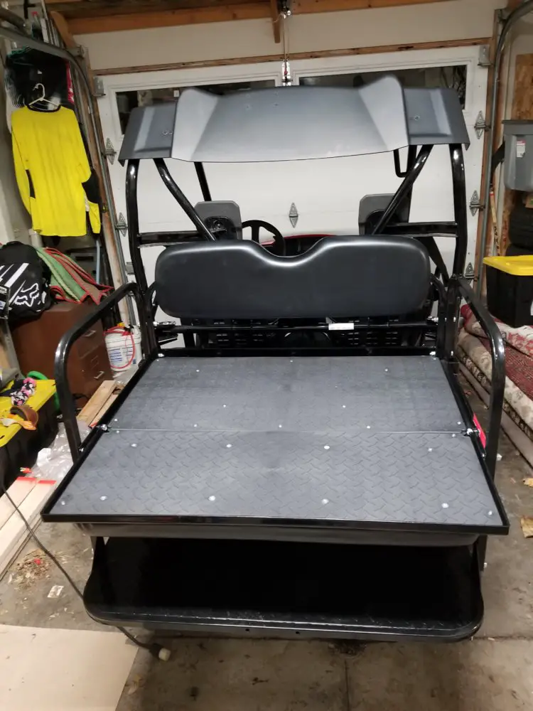

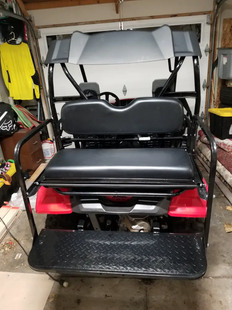

Built this for people carrier and also can throw a Bambi on the back.
About $60 in parts
Seat was about $280
Hours of work!
Works great!

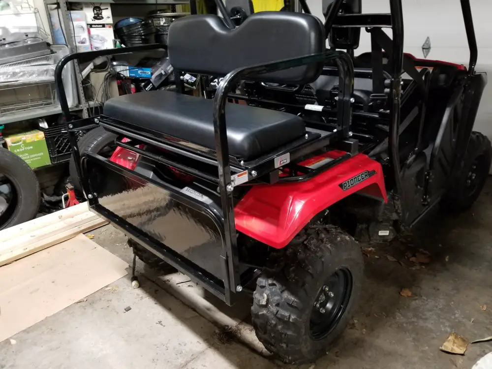

Can I ask how it attaches to the rack, I am looking to do the same thing but wasnt sure how it attached.
the seat is a club car seat i am assuming?
I used U-bolts to connect the seat to the frame on the P500. I drilled holes in the frame of the seat to match the u-bolts.

Single bolt conduit clamps to rack also a possibility for quick removal.
