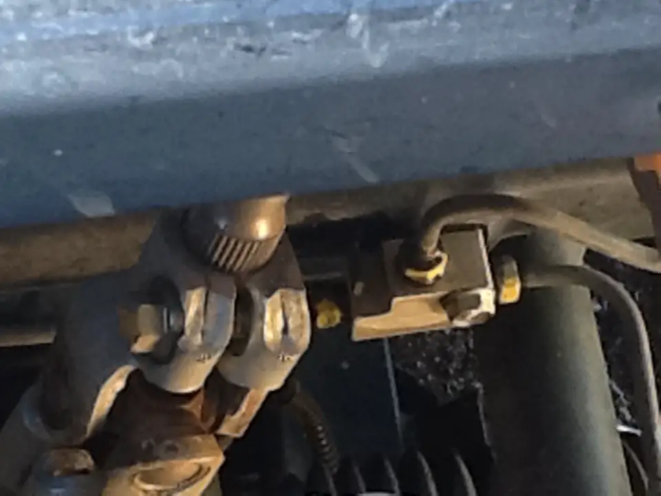

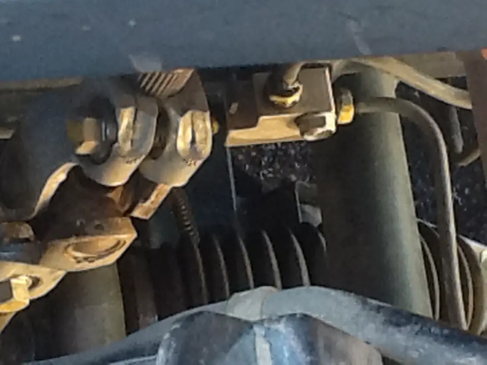

This is what I found today on my 2017 pioneer 700-4 with power steering.i only have 1700 miles on this unit.
