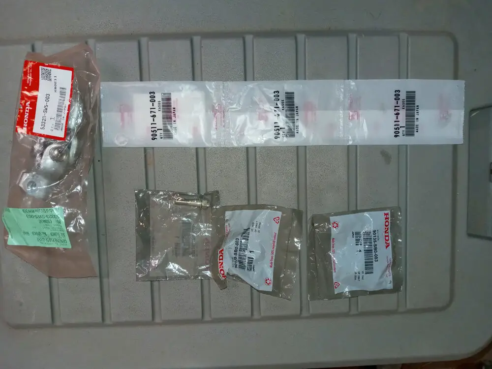

For those thinking of doing this: I said I would update about parts availability. They shipped, and got them Friday from an AUTOMOTIVE Honda parts house.

So the parts number for the Steering Joint B on the Honda recall doesn't come up. what is the correct number? I plan on just doing this myself.
Thanks
Interesting. Wonder why they have a different part number? Maybe to keep track of the work?
Anyway...use the numbers I posted earlier. Says on my 700 that all the joints are the same number.

I should have updated this a few days ago, but I installed my parts. I was in a bit of a hurry, so I didn't get pics of the whole thing.
Even after removing the joint, a new bolt was tough to get started and tighten in the old joint, even though the threads look perfect, so I'm going to guess the joint gets deformed as well as damaging the bolt.
I'm thinking the alignment jig is simply to provide Honda with visual evidence this repair has been done properly. It's pretty easy to hold the bolt on the center of the groove while snugging it down.
