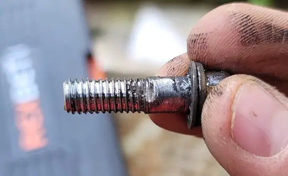

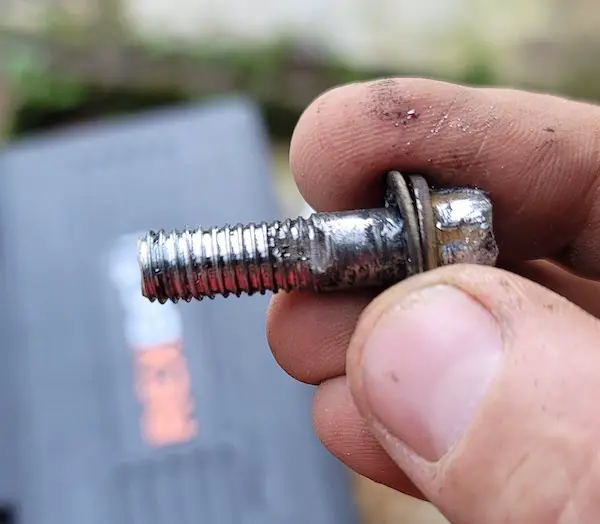

joining this party!

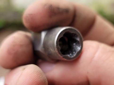

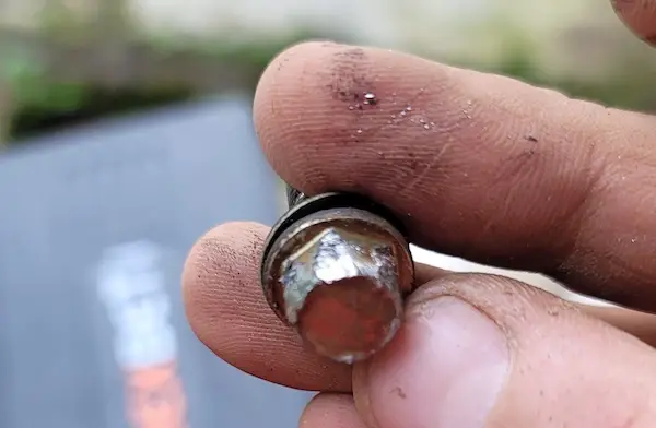

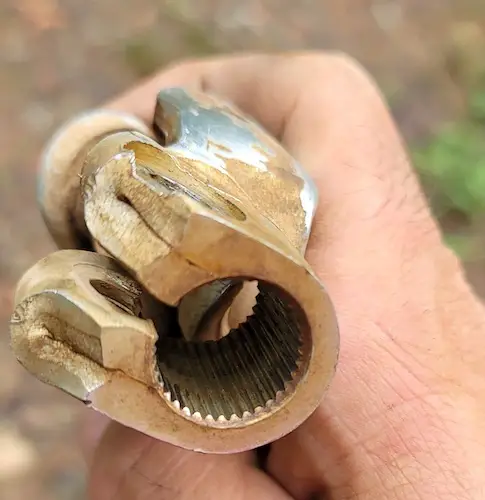

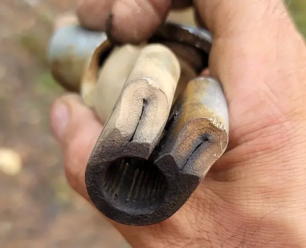

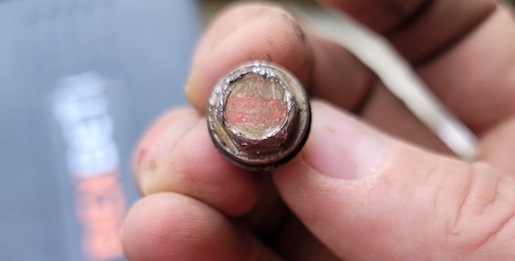

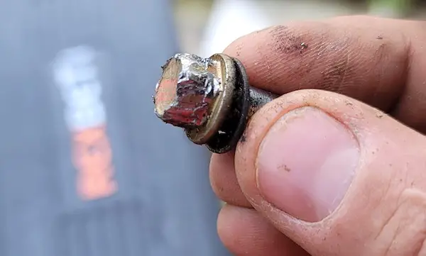

Ordered the parts, seems the joint-knuckle is on backorder till early October.
Started removing side and front fender last night.
Had easy access to the lower joint-bolt, tried to remove it and it was so tight that the head stripped.
Funny side effect is that after attempting to remove the bolt, the steering is now working normally again.
ch33br0h
ch33br0h
Jul 7, 2018
130
369
Jardín, Antioquia - Colombia, South America!

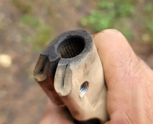

wow.
The amount of force to get that bolt out was intense.
Last year I purchased a set of these and today I finally got to use them REXBETI Bolt & Nut Remover
Also intense to see how stripped the inside of that joint is, but somehow the shaft that goes direct to the steering assembly looks to be in good/great shape.
now, the waiting game for the parts.

I broke 1 of mine off. Then ruined the knuckle trying to drill an extract the broken bolt. I already had 2 used knuckles from ebay on hand.
