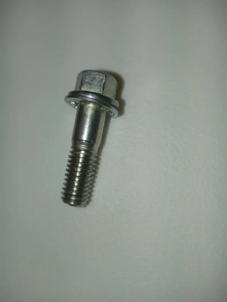

So went and checked mine, and yes...there is some tiny damage to the bolt.
20200906 200114
It's hard to tell from the pic, but it's there...trust me.
It looks like what happened is that the groove in the splined shaft didn't get aligned with the bolt hole properly. Bolt 1 and 2 have a "fixed" hole, while 3 has basically a flat side for some length of the shaft, with the ends returning to normal shaft shape. The ideal is to let 1 and 2 be tightened, while 3 can float and let the other 2 settle where they may. That's why it gets tightened last. Perhaps #3 was tightened 1st or some other out-of-order sequence, which ultimately forced #1 out of position a bit, and the impact tool forced it in. This damaged the bolt a bit.
Thing is, even after i aligned them, the #1 bolt will not tighten by hand as instructed in the video. My guess is that the pinch clamp gets distorted a bit when this misalignment happens, which may be hondas real concern. Mine appears fine, but steering stuff isn't anything to jack around with when you drive along shelf roads next to deep canyons. So i'm going to replace it. Yes...me!
The joint is about $100, with the bolts and washers being a buck or 2 each. It'd honestly cost me $40 in gas easily to get it to my nearest dealer, and I'd GLADLY pay the $60 extra to NOT have the guys at the dealer work on it.
If you're thinking the same, better get on it, as the parts might get thin. Strangely, while RMATV does have the joint for $112, the bolts are apparently on back order. Good news is, these parts are also used on autos, so i ordered them from a car parts place. I'll let you know if they are on back order.
It looks like what happened is that the groove in the splined shaft didn't get aligned with the bolt hole properly. Bolt 1 and 2 have a "fixed" hole, while 3 has basically a flat side for some length of the shaft, with the ends returning to normal shaft shape. The ideal is to let 1 and 2 be tightened, while 3 can float and let the other 2 settle where they may. That's why it gets tightened last. Perhaps #3 was tightened 1st or some other out-of-order sequence, which ultimately forced #1 out of position a bit, and the air tool forced it in. This damaged the bolt a bit.

I had the same thought about fixing it myself rather than taking it to a dealer. I haven't taken mine apart to inspect yet but I did order the bolt and washer just incase. With only 103 miles on it, I hope there's no damage yet.
How many miles are on yours to cause the pictured damage?
9,555
43,563
I think the damage was done at assembly at the factory. Nothing was loose. Mine has 89 miles.
Parts:
53323-SW5-003 Joint B (1)
90135-SB0-003 Bolt, steering yoke (3)
90511-671-003 Lock washer (3)
Yep it is there. The first bolt in the video above barely even has a spot on it and they say it is damaged.
The they show 3 more with more damage. I wonder if the bolts were manufactured out of tolerence? If they were a few thousandths to small they might let movement happen which starts wear.
I don't think it has anything to do with the bolts themselves being manufactured wrong. I think the damaged bolt is an indicator of improper assembly. On mine, the small groove in the steering shaft was misaligned with the hole. Not radically...but enough that the splines got boogered a touch and let the bolt get damaged.
It seems like maybe #3 in the video got tightened 1st, which forced #1 slightly out of position, but still had enough to let whatever impact tool get it started and run it home, which marred the bolt and deformed the clamp a bit. I'm sure @HondaTech will have more on this...
