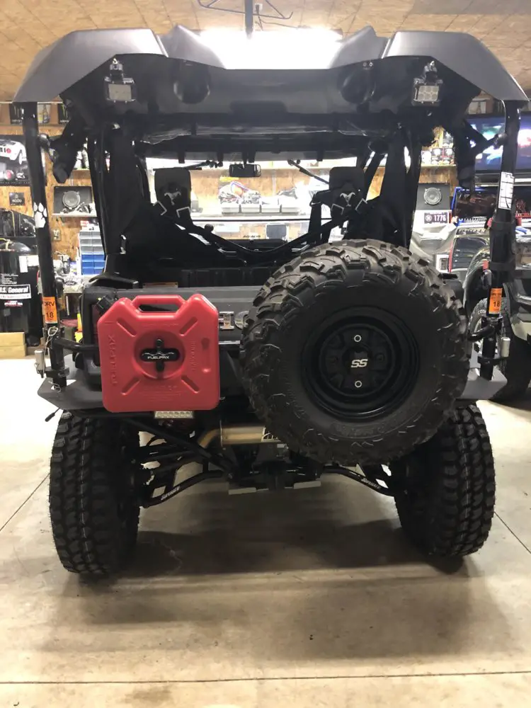

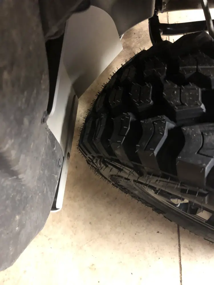

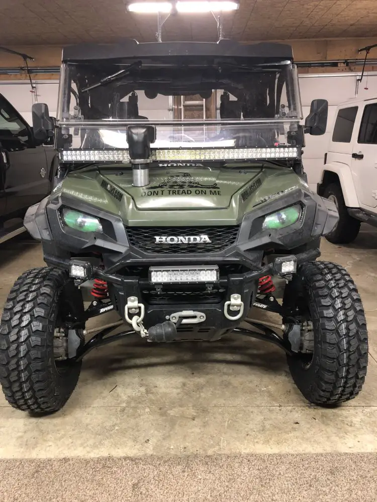

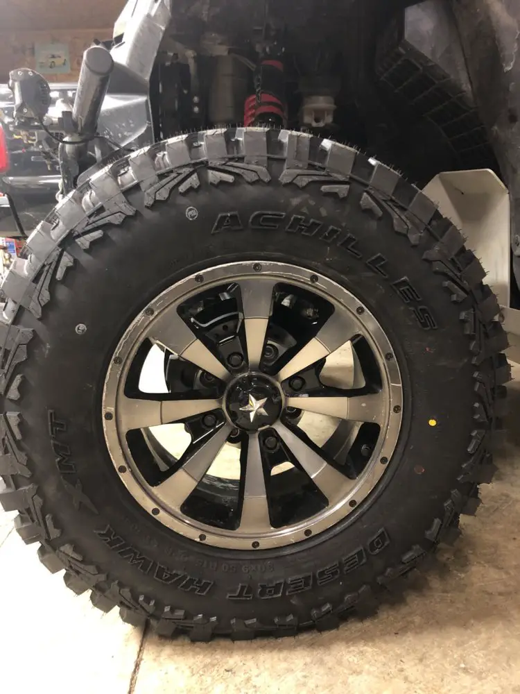

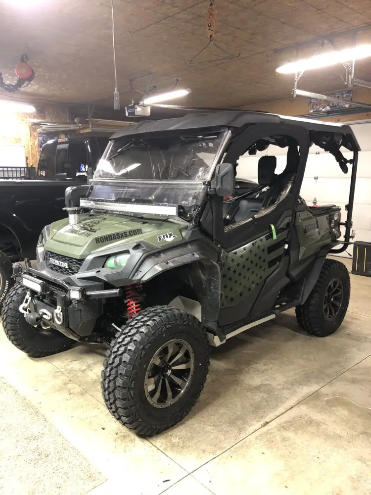

I got Er’ done! Looks kid BA IMO. The true 30’s are Marked difference in appearance. It’s looks super beefy. They clear good as well. Just need to make some fine tune adjustments to the arms but I did a good job at the eyeball o_O test. I’m on call this weekend, looking at some warmer temps here so I won’t be too busy. Should be a good thing to do on my down time. Now for a big ol brew for the finished job!

I got Er’ done! Looks kid BA IMO. The true 30’s are Marked difference in appearance. It’s looks super beefy. They clear good as well. Just need to make some fine tune adjustments to the arms but I did a good job at the eyeball o_O test. I’m on call this weekend, looking at some warmer temps here so I won’t be too busy. Should be a good thing to do on my down time. Now for a big ol brew for the finished job!View attachment 95664 View attachment 95665 View attachment 95666 View attachment 95667

Hard to tell on the one pic, but those are my old motoclaws. I haven’t weighed them but the Achilles felt like they weighed the same.
20,363
116,574
Love all the side tread new wheels too !
Yeah that was a pleasant surprise when they arrived. I honestly didn’t know they had them when I ordered them.

Your just running satv arms and fox shocks no lift right ?
Correct. I had a lift but with the SATV arms they strongly suggest different CV joints. To be honest, with the arms they pretty much took the place of the lift. I think if I left the lift and got longer CV joints I’d be screwed getting it into my toy hauler unless I chopped the top. Some day but not at the moment ;)
