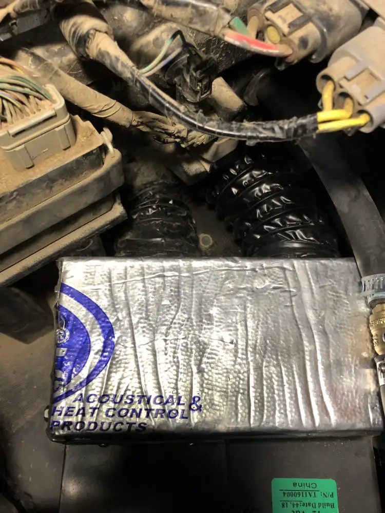

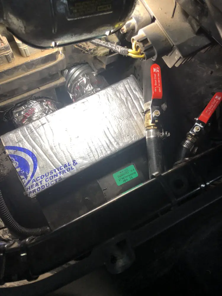

I got my heater done. What a Beotch that was. Tight spaces. Impressed with the air that blows out of it. The antifreeze was blue, anybody know what that is and do I need to use that ornis it the same as universal green?

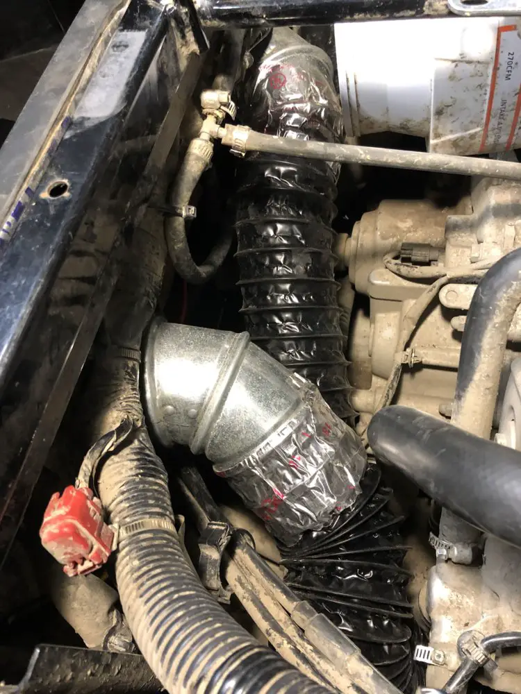

I got my heater done. What a Beotch that was. Tight spaces. Impressed with the air that blows out of it. The antifreeze was blue, anybody know what that is and do I need to use that ornis it the same as universal green?View attachment 98501 View attachment 98502
The blue is a Honda blend. You can buy quarts of Honda coolant on Amazon. You can also get gallons of premix.
It should be available off the shelf locally as well. Honda street car dealer, Honda Powersports, any decent parts store. Maybe even Wally world.
Curiou how that black flex duct will hold up against heat and rubbing on engine components. was there an option to stay closer to the floor or was that the only way through?
That was the only way through. Now that I’ve had time to think about it and some rest, I’m gona try and re run the aluminum flex.
Thanks bud. I’ll get some of that today. Never had to sea with Honda stuff while working on cars. My expertise was with the big 3. A lot of green, orange and yellow.

what if your first duct went out right under driver seat... literallyrun1st duct 180degrees over heater box and out righ there... maybe leave more room for long duct heading to passenger seat?
There’s not enough room for the duct to come out under the electrical computer there also too many OEM wires coming out in that general area. I got a few more 3” elbows. I’ll make it work tonight when I get home. I think it will be fine with the aluminum flex. It won’t get hot or be an issue I believe. Also got some perstone 50/50 ready use Honda antifreeze, it’s the blue stuff. Was hard to know if it was blue till the parts guy was interested and cut the proof seal lol. It was at carquest and I’m sure at any other parts store if u need some.

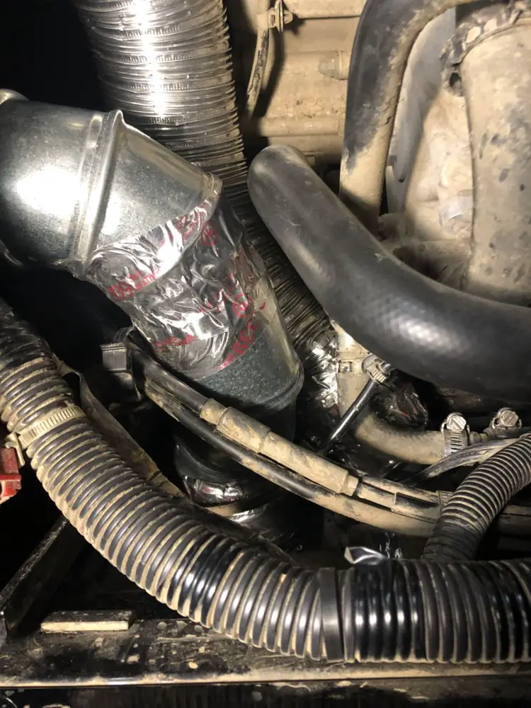

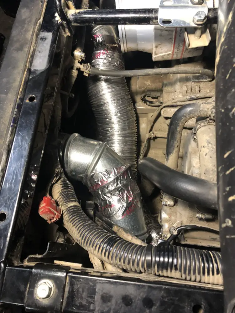

Ok MInty’s here’s the finnished product. Worked my bag off on this tonight. What a complete whore! Can I say that here? Oh well..I tore out the black vinyl that’s a complete saggy joke and fire hazard and relplaced it with some 3” aluminum flex and one with 3-3” elbows. I had to reposition the heater to make that work. Mater of fact, it’s the only place it works. Also to note, there is only room for your fingers for smack tape to seal your seams. (For those of you in Reo Lynda that’s Foyal tape) Stuff works great. It’s now safe as ready to rock doc! Just need to run it, burp it and bleed it.

Ok MInty’s here’s the finnished product. Worked my bag off on this tonight. What a complete whore! Can I say that here? Oh well..I tore out the black vinyl that’s a complete saggy joke and fire hazard and relplaced it with some 3” aluminum flex and one with 3-3” elbows. I had to reposition the heater to make that work. Mater of fact, it’s the only place it works. Also to note, there is only room for your fingers for smack tape to seal your seams. (For those of you in Reo Lynda that’s Foyal tape) Stuff works great. It’s now safe as ready to rock doc! Just need to run it, burp it and bleed it. View attachment 98659 View attachment 98660
Awesome, I hope you don’t have any issues with getting the air out. Do you have pics of all the other water connections, or are the two I see there the only ones?? Thanks
