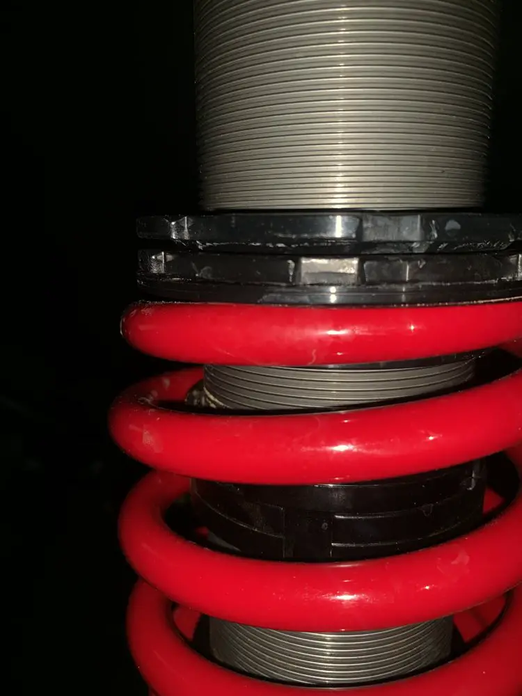

did you get a chance to do pictures of crossover setting? Thanks
I took one last night. Not the best picture but it looks like they are about 1/2 inch from the top with no signs of coil bind.

so you are moving the ring up to 1/2" gap between flanges BUT not changing the overall length of both springs. Since this basically adds to preload on tender But softens load on Main Spring, does ride height go down?
Ride height does not change. The ride height changes with the pre load. The ride is defiantly smoother on slow choppy surfaces. If I was running the sand dunes I would put it back to the original 1 1/2" from the top.
You should be way past coil bind the front spring is 5.9" and the rear is 6.9". Just measure and add up all the coils, they are at least 1/2 of the length. Both springs compress all the time until the crossover contacts and then just the lower. The only way you can tell when they coil bound is to see wear on the paint. Maybe you have not hit any bumps that have been big enough. One way to tell I would think would be to wrap tape around a coil thick enough to be able to see contact.
