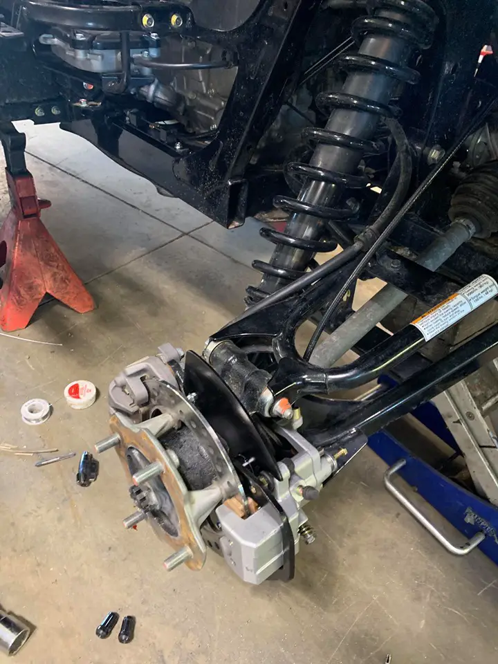

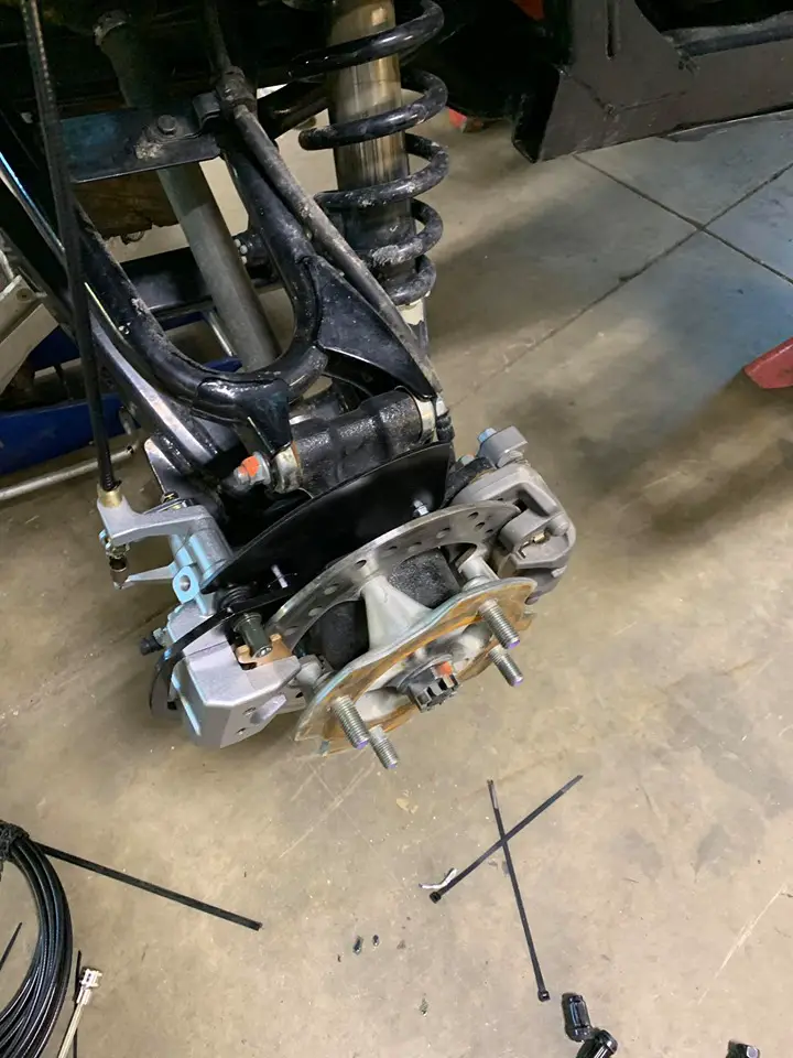

Update, Just dropper my 1000-5 off to Dan to get the parking break kit installed today, They are all custom cut and fabricated onsite, they also have kits for, Polaris,Can-Am etc.
D3 CUSTOMS
11363 3RD AVE NW
Grand Rapids MI,49534
ask for Dan, Tell him Scott sent ya..
616-291-4196
WWW.D3CUSTOMS.COM

Are all the inspectors that anal about it?
Will it be hand/foot/electric actuated?
Will take pics when it comes back, its going to be hand operated, Inspector told me there is 600 in the system only 10 or so have passed.

Has anyone in MI received a legal MI plate yet for a Pioneer? Can you list all modification you did. I am aware of DOT windshield w/wiper & squirters, turn signals, horn, DOT tires, license plat light, and mirror. It seems emergency brake as well?
Yes the one in the pic was just passed this week after getting the parking brake kit, I will list later after work.

Trying to get a parking brake on mine for street legal purposes too here in michigan. What does he want for his kit ?
Its not a kit, there are no kits, everything in fabricated in house and the custom brackets are Lazer cut and installed,cables etc. its around 1k out the door. Will know exact $$ when I get mine back this week.

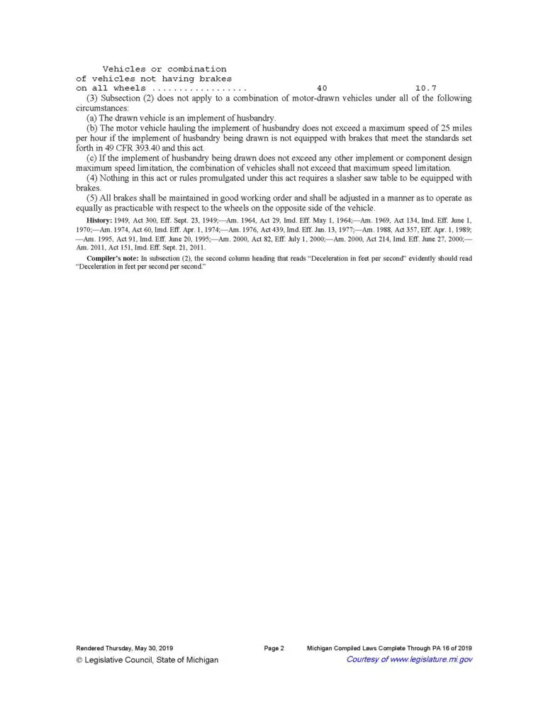

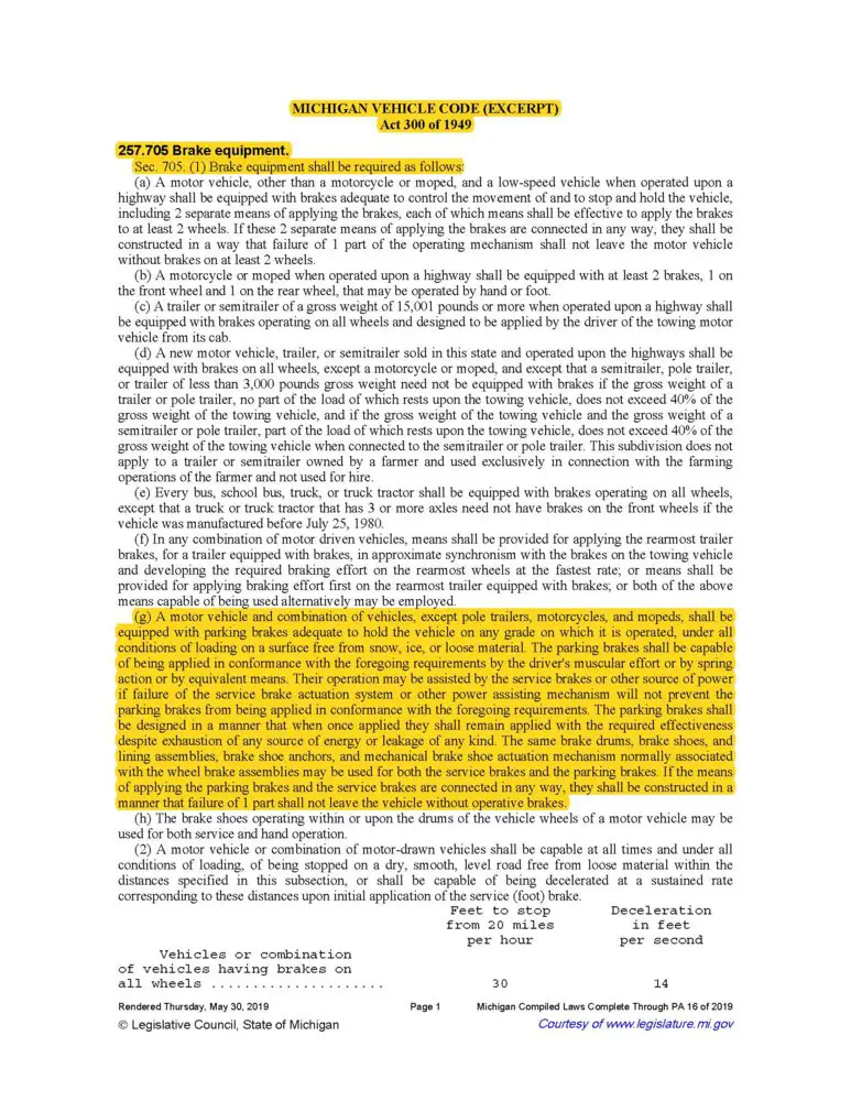

Yup not cheap, But I went through the whole process only to get screwed by state inspector and its worth it to me to be able to drive right down the dang road and wave at the cops as the pass the other way, all my trails no say no ORV but I can take a street legal truck or jeep down them.
Here is the part you need to read.
View attachment 133187 View attachment 133188
I agree that its gonna be nice to ride the back roads and other trails that normally would be closed to orv's without fear of a ticket but it turned out to be very expensive , more so than I thought !
