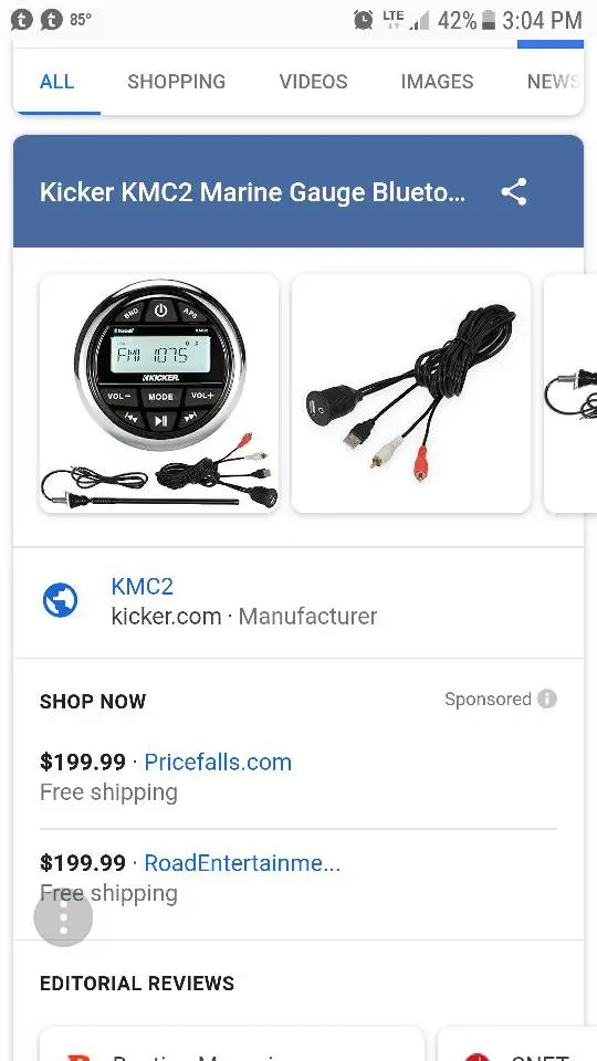

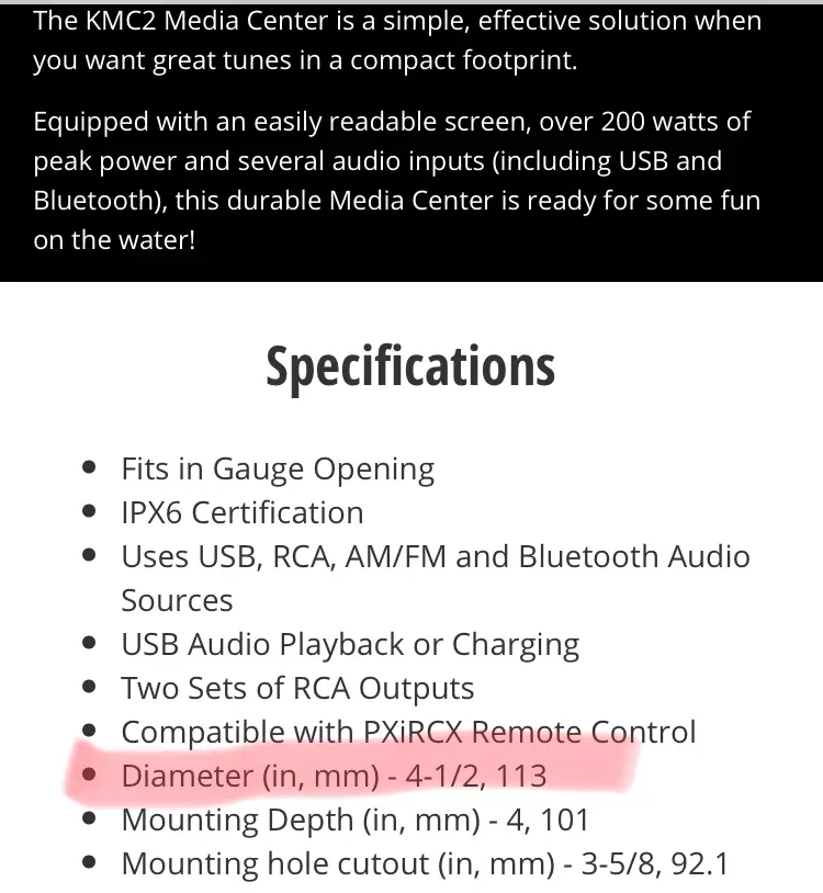

I think my kicker had two ???

I found Fusion Marine radios, the MS-RA70 looks like it'd be a perfect fit and well sealed for the application. Maybe I am out of the know but I've never heard of them, seems like they are a very popular radio overseas and have just started to make a "splash" here.
