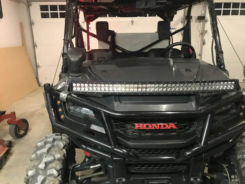

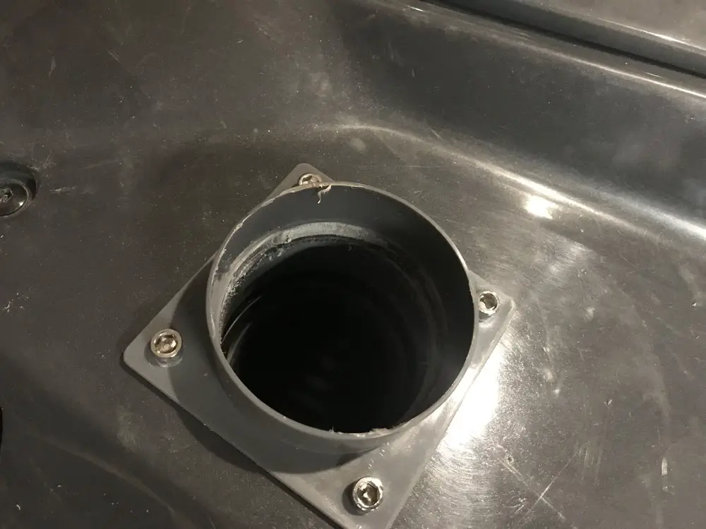

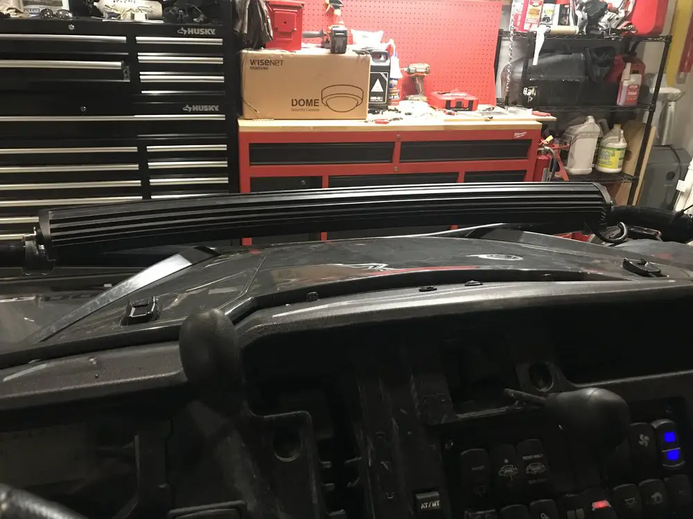

I wanted to drop the lightbar and clean up the front of the machine to make it easier to see close in on technical trails. The through the hood snorkel forced me to have the lightbar mounted higher and more forward than I wanted to be able to get the hood off.
I grabbed some flex intake duct and bulkhead fittings and ran the intake through the right front fender. The fitting and snorkel on top of the fender is temporary until I weld up a new snorkel so it sits more level and is braced off the ROPS since it’s so close to the side.
View attachment 74602 View attachment 74603 View attachment 74601
With this setup I dropped the lightbar to about ⅛” off the bumper and, ⅜” off the hood using the weldable clamps. It gets it down and as out of the way as I can and still remove the hood. It also doesn’t shake like before and should be a more stable mount for the VIRB.
I really want a GOOD 18” lightbar that will sit right down on the upper bumper bar but I’ll save that for another day.

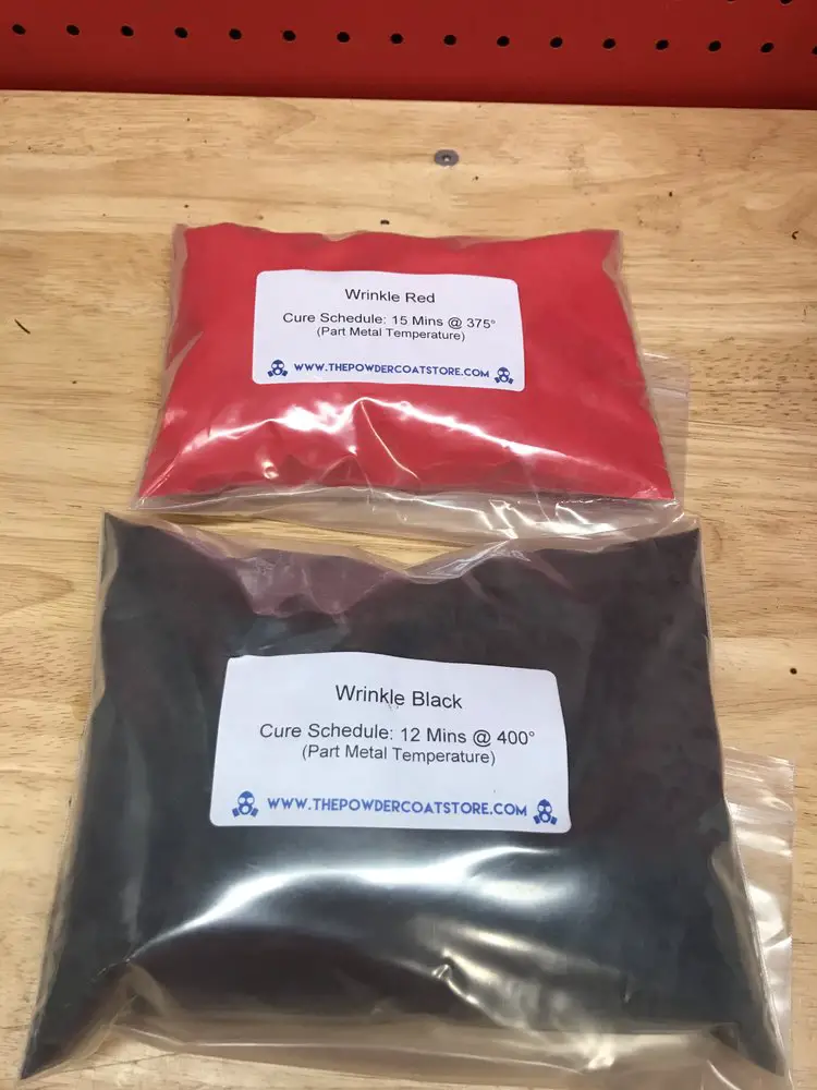

My powder showed up a few mins ago so I can get the all the mounts and a couple other things power coated tomorrow.
I really like where you put the snorkel. I never ran mine through the hood because I didn't want the hassle. I may have to try this design out.
32,051
Thanks I like it better its way easier to see right in front with it there but it took a min to work up courage to cut the fender but I made sure the hose would fit several times before I took a drill to it to mount each side.
I am going to make a better connector out of metal and powerdcoat it. I think the plastic bulkhead connectors are too brittle

Can you post some pics of how you routed your snorkel to the fender. I'll likely be doing that shortly. Thanks
Reactions: BWAF
32,051
It goes under the fender and has this same bulkhead type connector on the bottom.
This is 3” flex intake from Advance Auto
and cheap plastic bulkhead connectors. I’m working on a 3” steel bulkhead connector at the moment if I can ever get the time to finish it up. I may make a steel snorkel and brace it off the ROPS to keep from tearing up the fender if a big branch gets it.
