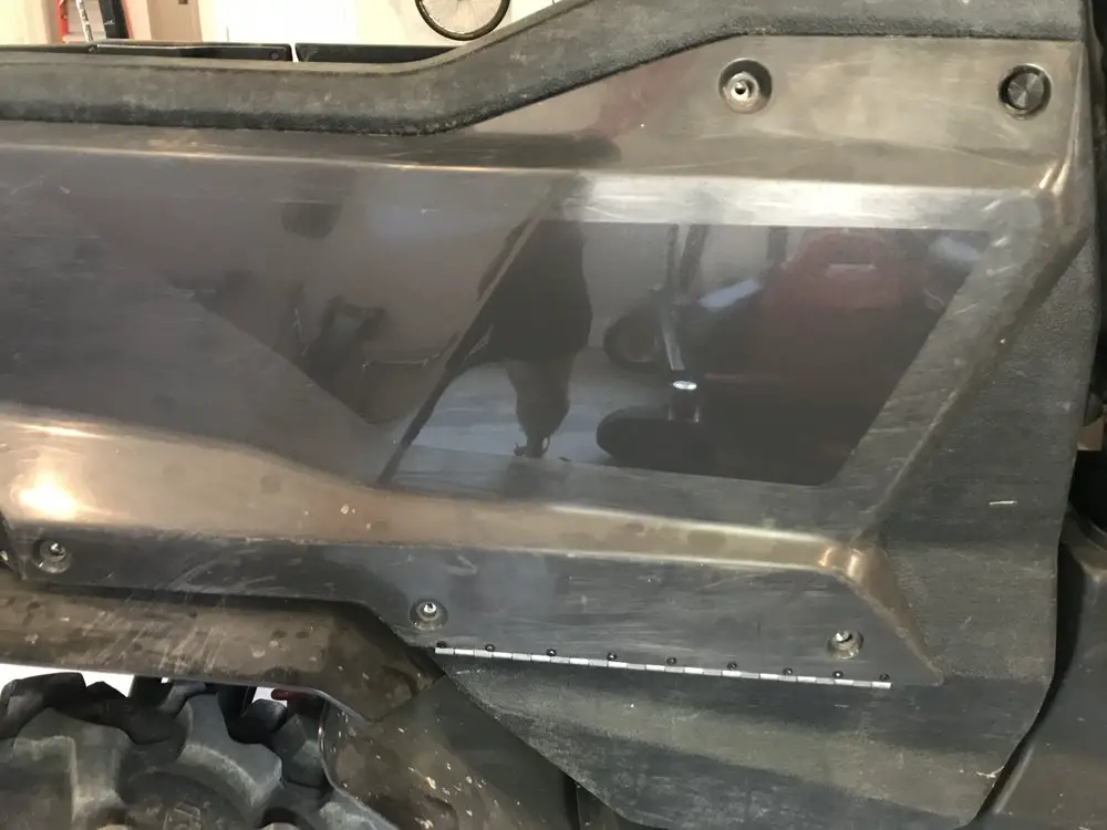

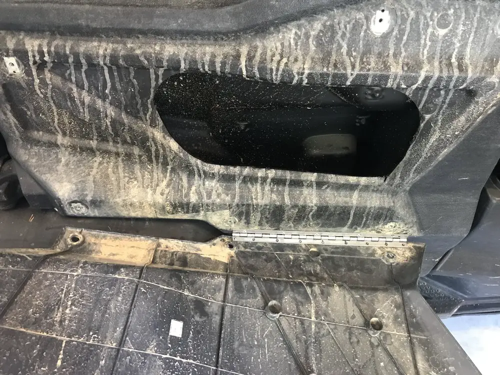

Decided to copy @joeymt33 door mod and I cut holes in the rear doors. Wow those things are cavernous. All the gear I usually carry in the bed can now be stored away in the doors once I get different storage bags that fit better. Hopefully it stays cleaner, the extra gear weight is much lower, doors don’t rattle, and the bed is free to be cargo or people much easier than before when I had to rearrange everything or pile stuff on top of other stuff.
The ONLY a downside I see is if I am leaned into the door panel that has my recovery gear stored in it. I may keep a short tree saver and block in the glove compartment.
I ended up mounting the stainless hinge to the plastic panel first. Then remounting it to the door taking a piece of masking tape and lining it up along the bottom side of the hinge marking each end then removing the panel and lining the hinge up so that it was in the same place. A few rivets later and she’s done it was quick, maybe 30-45 mins.

I am going to have to do this, that is just too much wasted space not to take advantage of it.

After watching Joey “clown car” stuff out of them I knew I was gonna do it when I got home. It was amazing how much space is in there. I feel like I should fill them up. One side will hold what I carry with room to spare, the other is going to get the water pump and some other things I don’t carry because of lack of space. I may even move my tools out from under the seat.
I was considering making a bed storage box but now I don’t think I’m going to because of all the space.
I think I’m going to be in the market for a bed extender and modify my spare carrier slightly.

Do you think a scissor jack will fit in there? I have pretty much decided this is the route i want to go as well

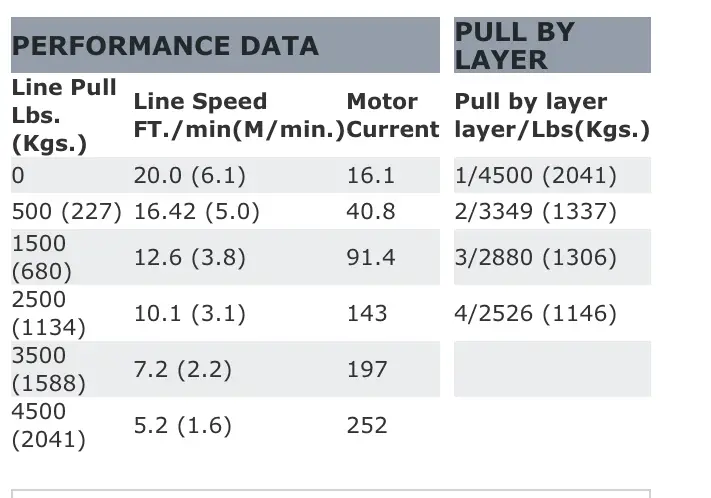

So my AC only clamp meter died last week and I picked up a AC/DC clamp meter. Kline CL-800 for reference. Which I checked in manner below.
My 750ma Battery Tender is putting .69amps/690ma into a battery.
My Craftman 115v source jumpbox/charger on 2amp charge is reading 2.2a/40amp fast charge is 39.1/200amp jump is 194.6 so without lab testing equipment that’s about as close to confirmation of meter accuracy as I can get.
I answered some questions I had about electrical draws and confirmed a suspicion.
A 4.9amp draw at 13.4v for the 40” “240w” amazon special which I suspected was BS from beginning considering the 16ga wire coming out of it. It’s getting replaced...takes up too much space for so little draw. DANG it the RoughCountry looks appealing.
1.2amp draw for the 18w cubes(close enough)
1.6a for bilge fan.
0.6a for Whips about right.
1.3a for rock lights, which is also far less than 7a it should be for (8)9w draw lights.
11.7a for WetSounds AS-8 sub and Surge 6 bar which tells me the amps are not working to their full capacity due to the Bluetooth switch low line level output when split. It’s still loud though so I’m curious how a different audio feed to them will change the draw as they are fused at 50a combined. Edit: (Sail-Unlimited Gravity Remix) The meter also may not be fast enough to measure spikes with music...
Winch maxes at 13.9a just free feeding line in.
Snugging the hook stopper to the fairlead peaked at 28.93.
With about 10-15’ of line out of the rear winch (both are Viper Midnight 4500lb) dragging itself up a 27* hill with brakes on I maxed at 60.18amps, I’ll try to stall it later and see what it spikes to. I’m more worried about the structure than the wire but I’d like to know what it draws just to know.
Winch is somewhere in the guesstimated ballpark of what Warn posts for their 4500lb winch.
1.6a for bilge fan.
