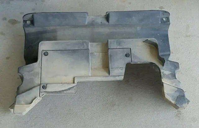

I took this off a few months back to relieve the heat issue
Glad that this worked for you but it had the opposite effect on mine. It made the heat pour into the cockpit worse than ever before and from places that it never had before. It is obvious that the type of accessories that are installed on your machine will effect what works best for your specific machine. I found so far that leaving the top half of the Honda 2 piece tilting windshield installed and removing the bottom half during hot weather gives me the best results. It works well even during slow speed riding ( Between 10- 15 mph) and by leaving the top portion installed you still have some protection to your head and face from bugs, limbs and debris being thrown up from riders in front of you.
I have the Honda Hard roof, Trail armor skids, Honda hard rear panel. On my machine removing the plastic shroud that you show in your post also caused the front of the dump bed on my machine to get so hot that you could not leave your hand on it for long. I am positive that riding around with the shroud off for long would have warped the bed plastics.
I have roof, split windshield, and hard rear panel. I have no problem with heat as I use to. I also in the beginning checked my bed all the time and no heat. Today it was 100 and I rode around my ranch for 2 hours and it was just fine. Sorry it's not working for you. Maybe the skids are holding heat in???
You are most likely correct about the skids holding the heat in. I have the 1/2 inch thick Trail Armor skids and have noticed that where the exhaust pipe is nearest to the skids on the passenger side in front of the rear tire they are warping because of the heat. I will try to get a picture of this and post it. The bottom line is we will all have to experiment and see what works best for our machines with the way that we have them set up. Posting this info will be helpful to everyone.
