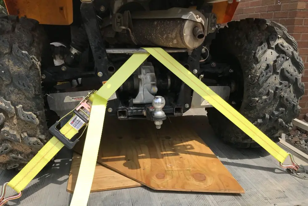

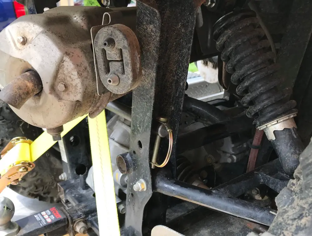

I've tied my P500 down a number of ways, but have not been happy with them. I've finally settled down on using the heavier 1500lb working load ratcheting strap from Menards as the ratchet is so much better than the smaller ones. I use one strap across the front bumper. This is what I'm doing now in the rear. I welded a head on one end of a 13/16" diameter steel bar and slide it through the frame holes. I put a pin on the other end so I could remove it. A single strap works well. This gets the ratchet away from the tires and makes it much easier to secure.View attachment 137644 View attachment 137645
why not just strapping over the hitch receiver?

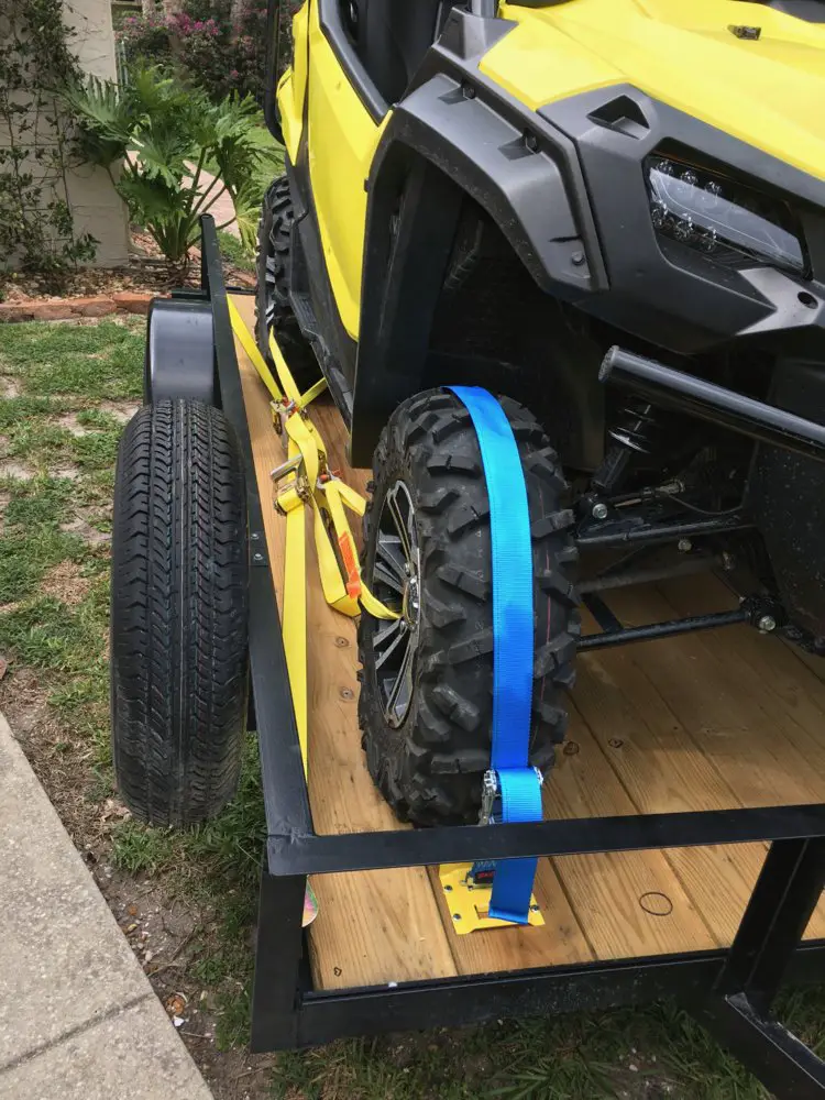

When I was trailering my ATV, tie down wasn't a problem. It couldn't go anywhere and l only had to stop forward and rearward movement. 30 inch solid sides on a 5' by 8' bed. When I bought the P500 it would not fit. A new trailer (5' by 10') cured the problem leaving me with the question "how do I secure this sucker to the trailer". Because I wanted it against the front trailer rail I strapped it so there wasn't any rearward movement, compressed suspension. This didn't work out very well as I had straps loosen and 2 times come off. I then straped from a-arm around the center rail support back to the opposite side a-arm. That cured my problem, no forward or aft movement. Nope! Now the front bumper is bouncing up and down on the rail where before it only rubbed.
I next talked with a friend that drove a car carrier and another friend that owned a tow company. Both said they were required law/rules to secure to the axle or a-arms or frame and could not compress the suspension. Tire straps could be used as long as fore and aft movement was stopped.
I next searched the forums and read the back and forth on how "I secure mine" and the reasons why I do it my way and why I don't use other ways. You've all read it, so no reason to repeat it.
I did see the Erickson securing system and liked what I saw. Bought a set for front and rear at Tractor Supply, on clearance. I strap one or both rear tires for short trips and all four for long trips. I have had only 3 problems with this system. Two of which were operator error, read that as "I screw up". The third time I only strapped the front tires and found the rear could and did bounce, on a ruff road, to the side against the rail causing some problems when unloading. Again I should have known this could happen as the front tires no only go around they also turn left and right.
