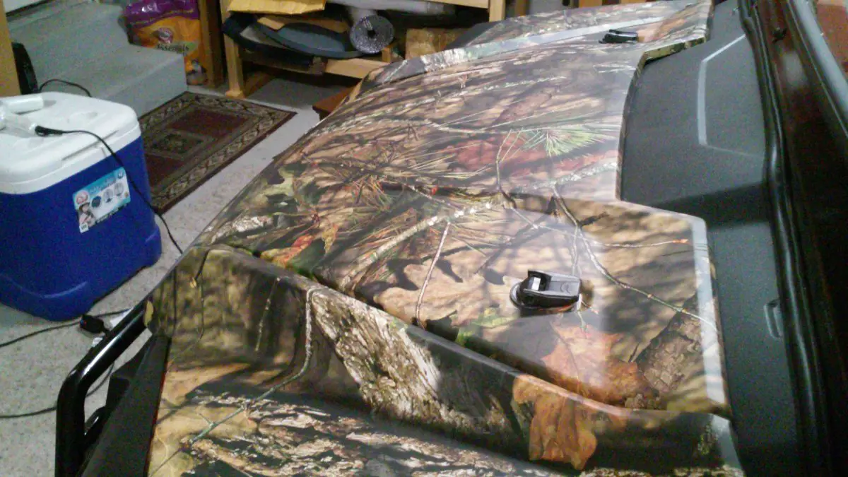

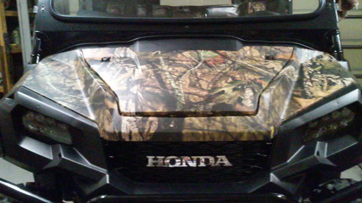

That wrap looks great!

Thinking about getting mine wrapped eventually.. Did you completely remove the front section to wrap or left it on?
I LEFT IT IN TACT BUT REMOVED THE RIVETS AT THE FLARES AND REMOVED THE BOLTS IN UPPER CORNERS AS TO FINISH THE WRAP. FLARES ALLOWED FOR MORE ROOM ON THE SIDES BUT FRONT WAS TIGHT FITTING. IT WAS MY FIRST TIME EVER DOING A WRAP AND I MUST SAY I DID A GREAT JOB FOR A BEGINNER. VERY FEW MISTAKES AND THE BEAUTY OF CAMO GIVES MY MISTAKES A 3 D EFFECT. HAHA JOKING. :rolleyes: MAKE SURE YOU HAVE A WARM PLACE TO DO THE WRAP 75 DEGREE OR HIGHER TOO COLD WILL RUIN THE WRAP AS IT MAKES FOR A TOUGH INSTALL . HEATERS AND HAIR DRIERS.

That is cool man! I traded in my Tyrex with camo and really liked that too! Is there a thread on cost etc?

Thanks for the info man... you did a great job..
