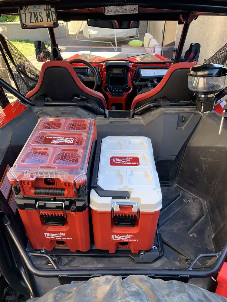

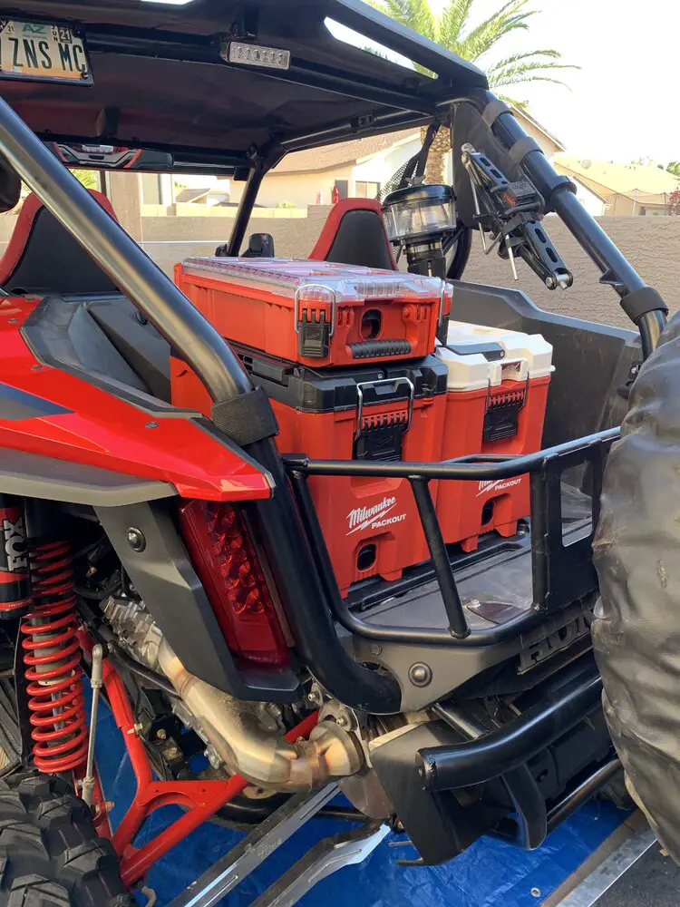

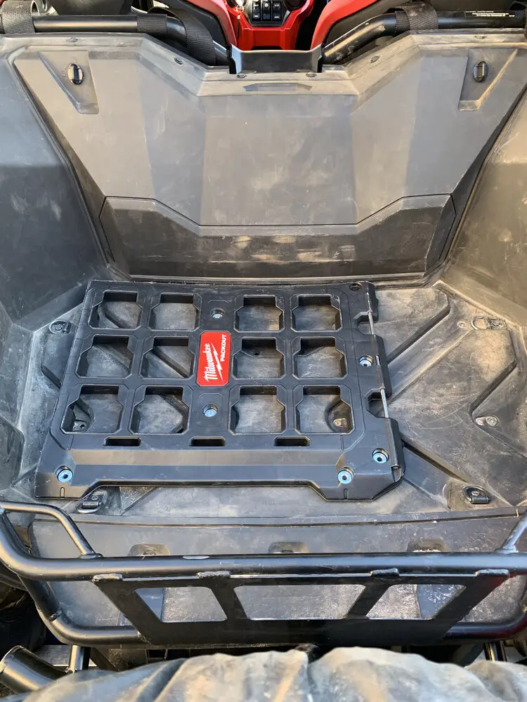

Did the Milwaukee set up and love it

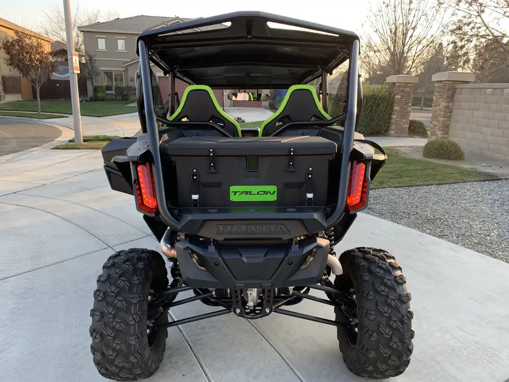

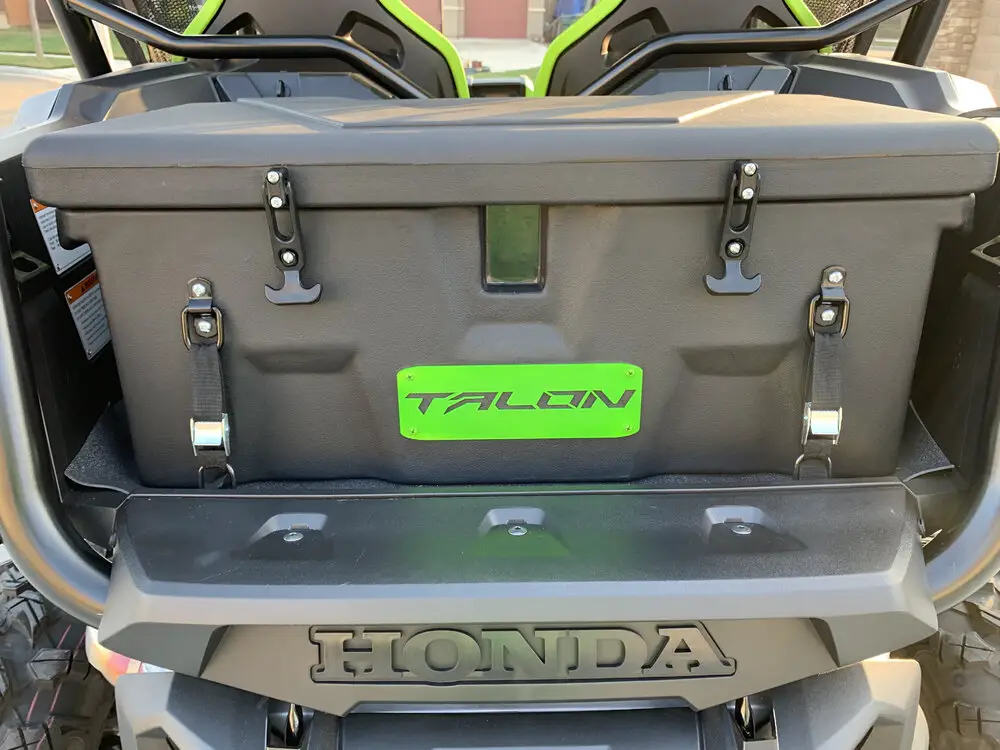

I've got the moose box. Fits great with my Dirt Road Fab tailgate extender. I can fit my rtic 30 soft side cooler between it and the extender and still have room for a vp gas can if needed.
I mounted 4 hooks on it and use mini bunji cords on the back through the factory tie downs. In the front of the box I used 2 of the bunji cords with the balls through the factory tie downs and then looped over corner on the box lid. I also put some rubber weather strip on the bottom to cut down vibration. Box doesn't move even hitting high speed bumps.
I think the tractor supply box might be taller, but this one fits everything I need and came with keyed locks. Overall, I'm satisfied.

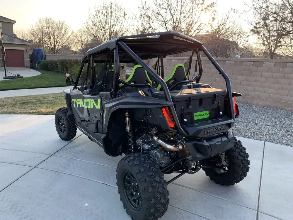

Same talon I have... I am planning on the TSC with very similar mods. Where did you find that color of paint (what it matched or just a rattle can? And did you get the talon plate?
That looks sweet!!
Rattle can
That looks sweet!!
rattle can. It took a little of both.
Make sure you use a good primer.

The season is over here, I didn't get enough miles in to have any feedback on the extra weight. My trails are snow packed and icy now so I can't carry any speed. There's no doubt the tender springs will need a higher spring rate if not the main springs too. I have the preload set too high causing the tenders to coil bind trying to get my ride height back up to stock. I can't lower the crossovers, they're bottomed on the threads (that would stop the coil bind). I have a trip planned for Arizona shortly and hope to get it revalved and sprung at Weller. No hard date set so I can't make an appointment yet.
It's important to note that I'll spend a lot of time solo exploring in the desert, I've set up for that and I'm willing to make the compromises caused by the weight. Some think it's an awful setup but it's my Talon. :cool:

I got it installed and opted to go with a hard cooler vs a soft. It almost fit sideways but would require trimming a half inch of the inside, so instead I’ll just keep it in this configuration (maybe buy a second one). It fits 9 bottles of water which is plenty. It was only $13 at homedepot, so I may get a second one for dry snacks. I’ll just keep a blanket folded against them to keep them from shifting around.
