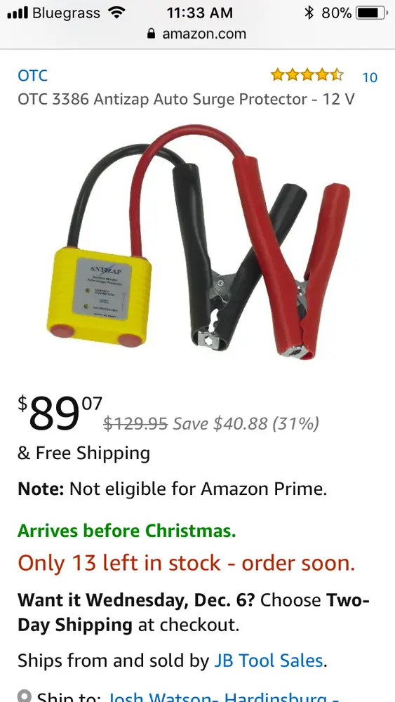

Anybody ever use these? Several different ones and prices.
23FE6703 8A08 405B B0F9 6A19374B2720
https://www.amazon.com/OTC-3386-Antizap-Surge-Protector/dp/B000F5JLP0?tag=sxsweb24-20
9,380
42,635
Never even seen one before. OTC is a pretty rep company, but my problem is you can just disconnect the batt for free.
On a modern car with tons of modules that sometimes need to be "reinitialized" after a battery disconnect, i can see it being more useful...but then again, you can just use a memory saver device for about the same money and (to me) less risk. To me, its kinda hard to justify.

We use them where I work building custom work modules on base chassis. No issues I know of.
