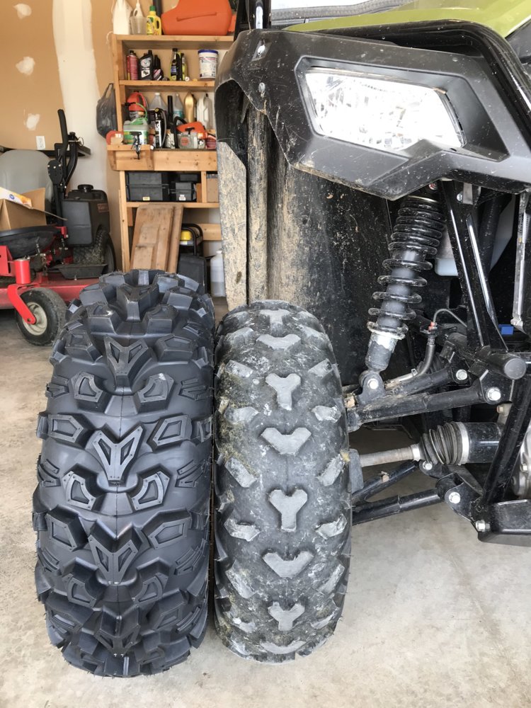

No tire rub at all, I think I gained 1 1/4” to 1 1-2” ground clearance. You can get nicer wheels on your budget I just couldn’t find any I really liked for the extra $$$. It handled and got around better as well.

I did 5+2, here’s a pic that shows how offset works.
B07322EE 04BB 406D 8665 B4BC578B73B9

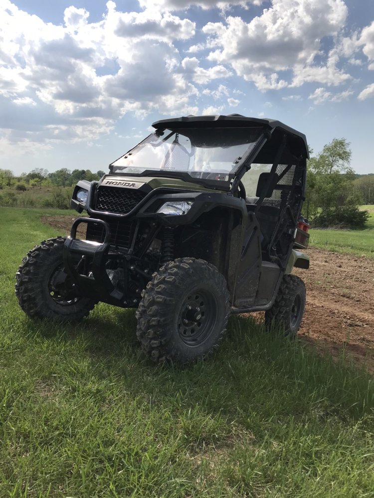

This is the setup I had on my 500, it was a little under $700. 12” ITP steel wheels 5+2 offset with 26x9-12 Sedona mud rebel rt’s on all four corners.
I highly recommend this tire, it’s a go getter and it’s 8ply radial.
View attachment 106946 View attachment 106947
Looks like the snow melted and things are greening up nicely over there. :cool:
