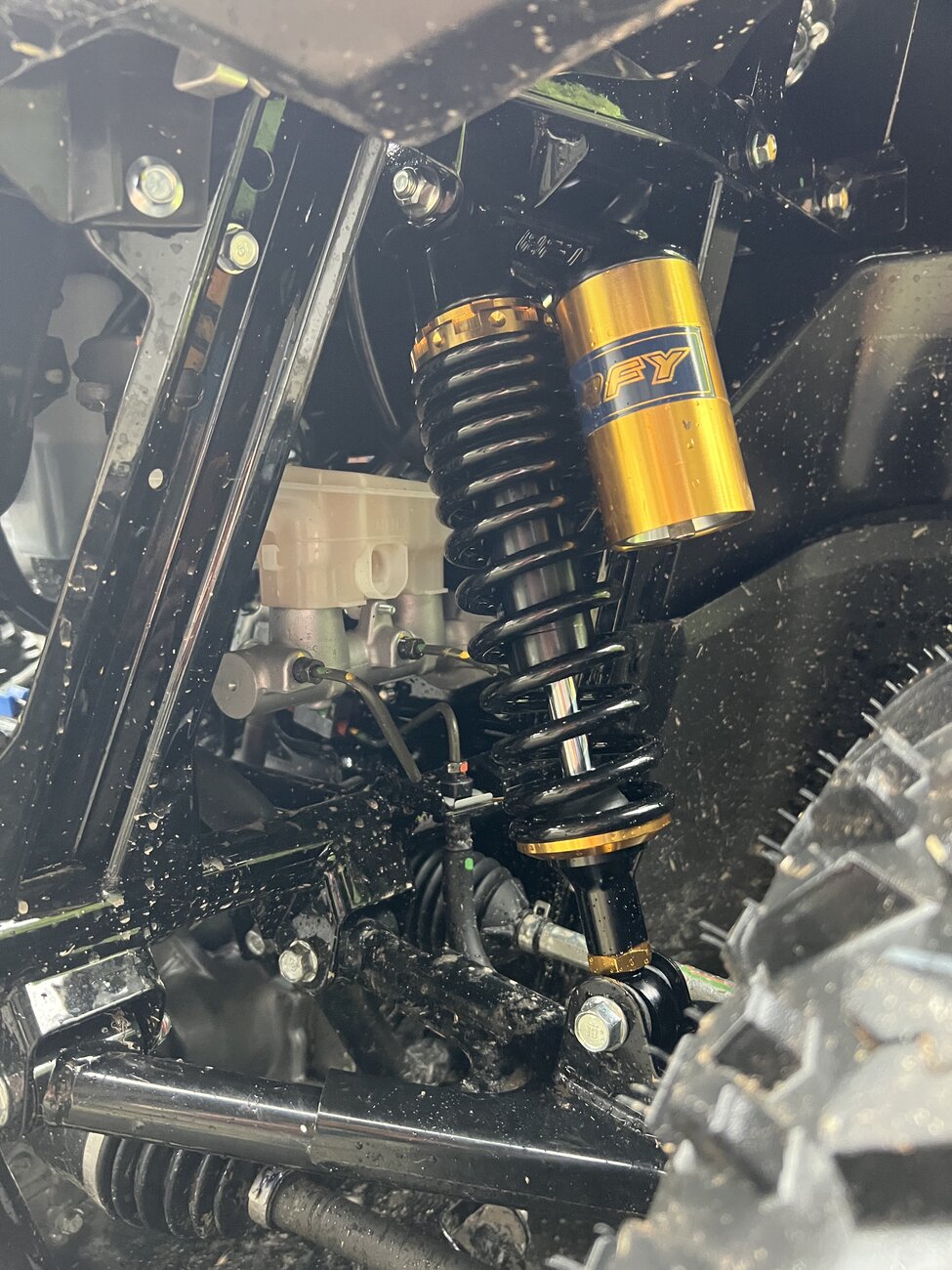

Bit the bullet and put the $79 Newsmarts 340 mm Nitrogen Gas Shock Absorbers on my 520!
Initial test run was a big success. Able to handle higher speeds with much improved ride on semi-rough terrain. Much better than the stock shocks.
Quick install. Needed 10 mm washers for spacers as the eyelet is not as thick as the stock shock.
