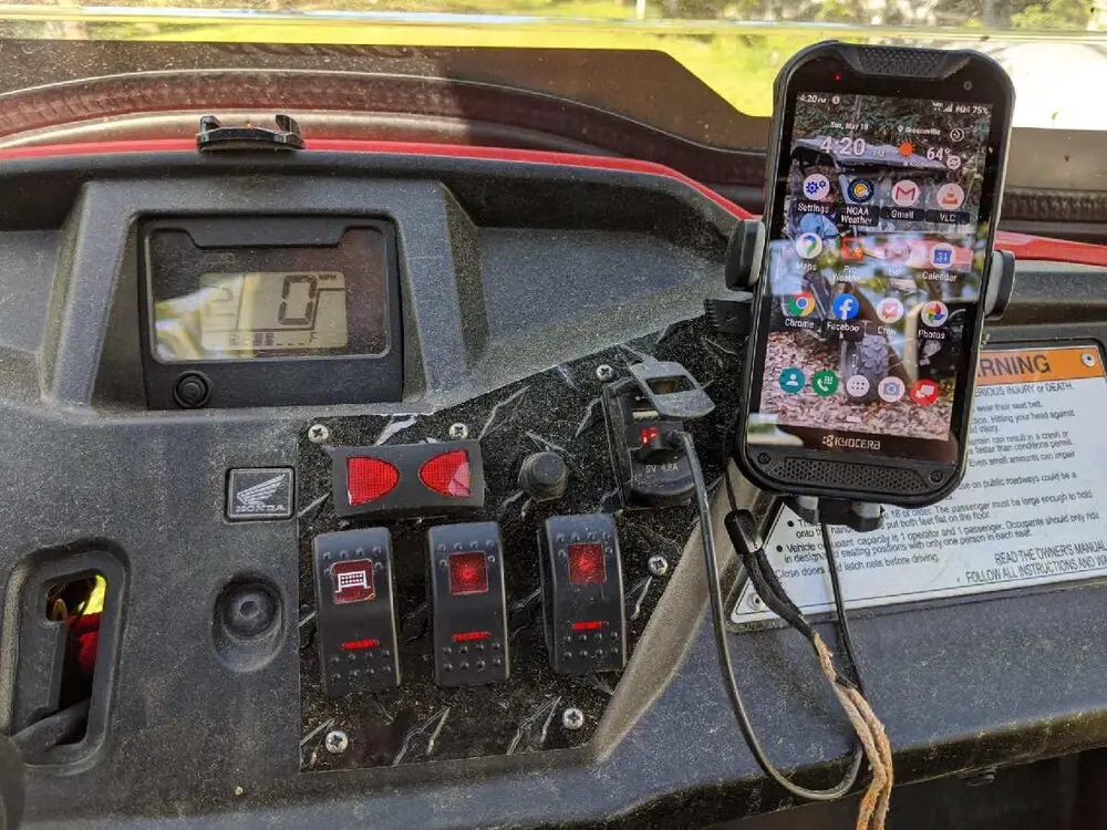

Dash1
Small red button above cup holder is a momentary windshield washer switch (love having a glass windshield).
Rocker below cup holder is winch switch.
Remote winch plug is next to rocker.
Dash3
Left (Red when on) push button switch is for rear LED work light
Right (Red when on) is for front LED light bar
Tablet Ram Mount holder just right of info / speedo
Round switch control below mount is NOAM NUTV5 controller
Below controller is a mini RCA input plug
Difficult to see (follow cord) Noco Genius smart battery charger dash plug
