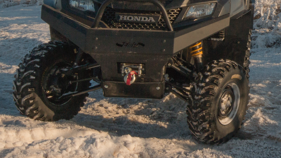

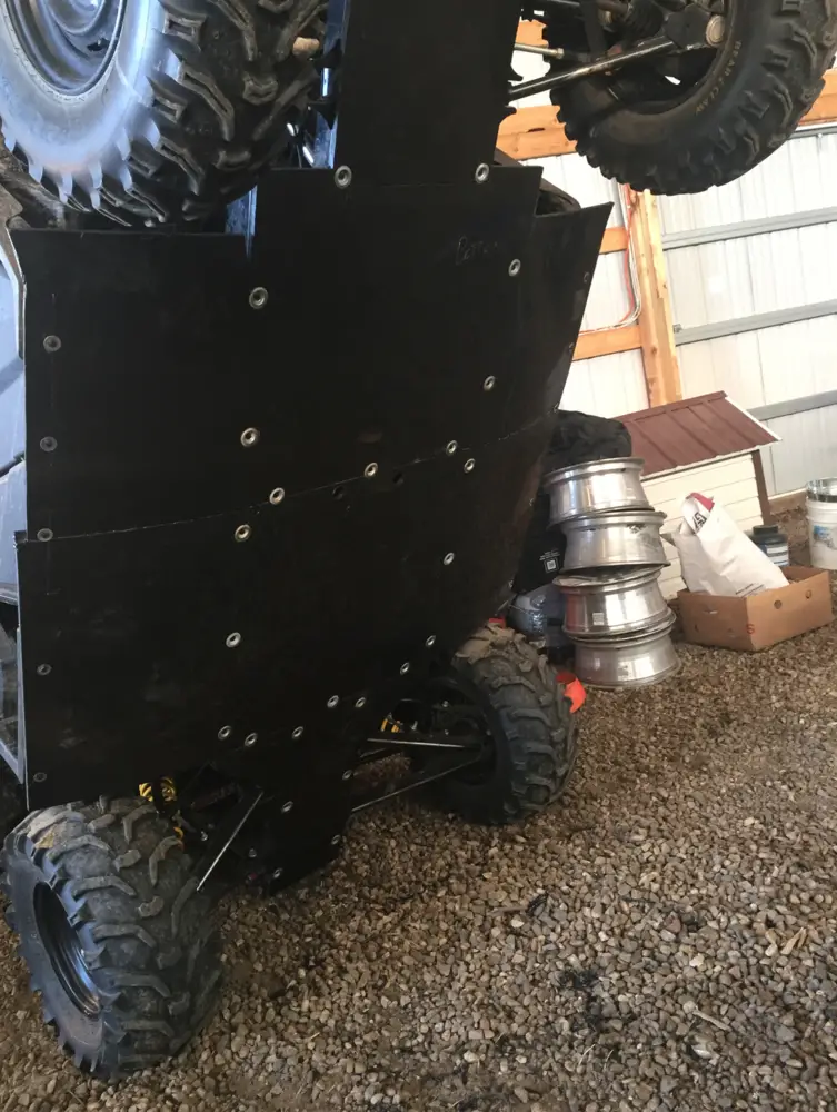

I looked at all of them, my choice if I had bought was the SSS, but with shipping, exchange and such, I opted for b building my own out of 1/2" buckboard. It took a couple days but honestly I was messing around and didn't care about time. The material cost me about 300$ for 2 sheets of board and I have LOTS left to mess with. I want to make A-arm guards. The one picture shows some trimming left. The other to show I formed it over the bash plate on the front.
I would make it again in a heartbeat. Now that I understand cutting, which was just a sawzall, and measurements to overlap the sheets like the SSS brand, I could make another in a day.

I have the cardboard I used for mine as a template. Using the old one only would leave you short.
What I did was stand my machine on end, then use cardboard from a large box and make the template. Its the same setup as the SSS. Another picture of the During with the cardboard on.
Then I bought some skid plate washers from a local ATV wrecker, bought 40 new grade 10.9 bolts and went to town. I used a router to overlap the sheets by 3/4", drilled a 7/8" hole after recessing the area.
Then on the outer rails, I used nut-serts, same thread as the main sheet which are m6x1.0. Given your location, I would recommend looking for a single sheet of the UHMW HDPE as they are sheets that are 5x10 where I needed 2 sheets of 4x8 to get what I needed.

Also I Ended up trimming the area ahead of the rear wheels more than shown and the front where its curved, I cut off. Bending the front in the cold up here was a challenge.
