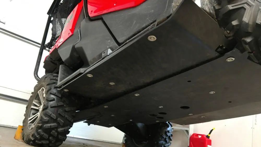

I paid $300 for a 4x8 sheet of 3/8". I made several phone calls and surfed all over online. Supplier was Ideal Plastics in Little Chute Wi.
IMG 20161230 111528928 IMG 20161231 124332310 IMG 20161231 124504316

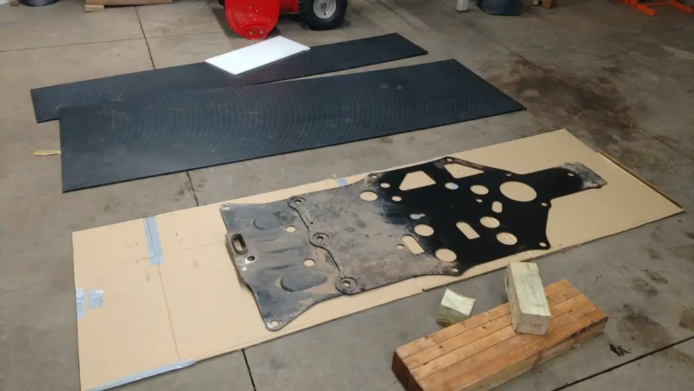

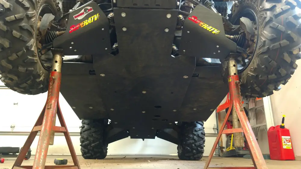

Happy Monday to all. So I have decided on 1/2" black Puck Board for the material. I found a supplier that sells the sheet for 147$ each. So I went for a drive on my birthday and bought myself a birthday present, 4 sheets of Puck Board. 2- 1/2" and 2 - 1/8". My plan is to make the template out of cardboard, bolt it up and see how it fits. That I completed this morning. Here are the photos.
In considering which design, I looked at the commercially available products. I decided to loosely base my design after SSSoffroad.com. I think they have a great design, and I wish I could have come up with the money to buy it, but the exchange rate despite his very generous discount for first responders put the cost outside of what a Paramedic in Canada can afford, but my hats off to them!!.
So I have 4 parts. The area that extends out the side, I will call wings. MY plan with those is to have a lip on the front and rear that curves up to accept mud flaps. A heat gun and some patience I am told will allow this product to be shaped easily. This should come in handy when I make the flaps/flares.
So my question to everyone reading my ramblings, what are your thoughts? Any tricks? Tips? I am going to put a hole for accessing the oil plug and filter, but what about other holes for cleaning? SSSoffroad.com has only a hole for the oil plug and the breather.
With the left over, I want to make A-arm guards. I have some rough templates not pictured, any input into those would be great. My plan for that is to make a template of the shape out of wood or something that will stand up to some heat, lay the cut parts over the wood and put in the oven. I have not researched the temperature yet, so if anyone has ideas about that, I am all ears.
So thank you to everyone who reads this and for your comments. I welcome them before I take a blade to the board.

The biggest reason I ordered a whole sheet of UHMW was to avoid splits in the skid plate material across the width of the machine. My concern was if you caught a log or rock with the front section of the skid plate, it would get caught up on the leading edge of the next section. If you have enough to faateners to eliminate flex in the material maybe it won't be an issue.
Ems-Cam
Ems-Cam
May 22, 2016
252
336
Alberta
I had been concerned about that as well, but I have a plan for that. I will cut the sheets so they have a half lap scarf joint. That way its flush but the joints are not simply butted together.
Plus a sheet of UHMW that was 5x10 was more than I paid for all the board I bought, and harder to work with by myself. Screen Shot 2017 01 16 at 121542 PM
Oh and the joints would have the attaching bolts going through the joint.

How are you going to machine that shape?

I have a router with a straight bit that I will set to depth and use a fence clamped to the board as a guide for depth.

Looks very good!
All aftermarket plates come in 4 peace anyway, mine DIY was 3 , I used one 4x10 f UHMW sheet.
99% you will be fine, dont worry too much about moving plate over plate if you do a good job of flushing your bolts.
I would make more room on the rear and trim off, see marked with red line, also make sure you drill holes along frame to drain dirt and stones
