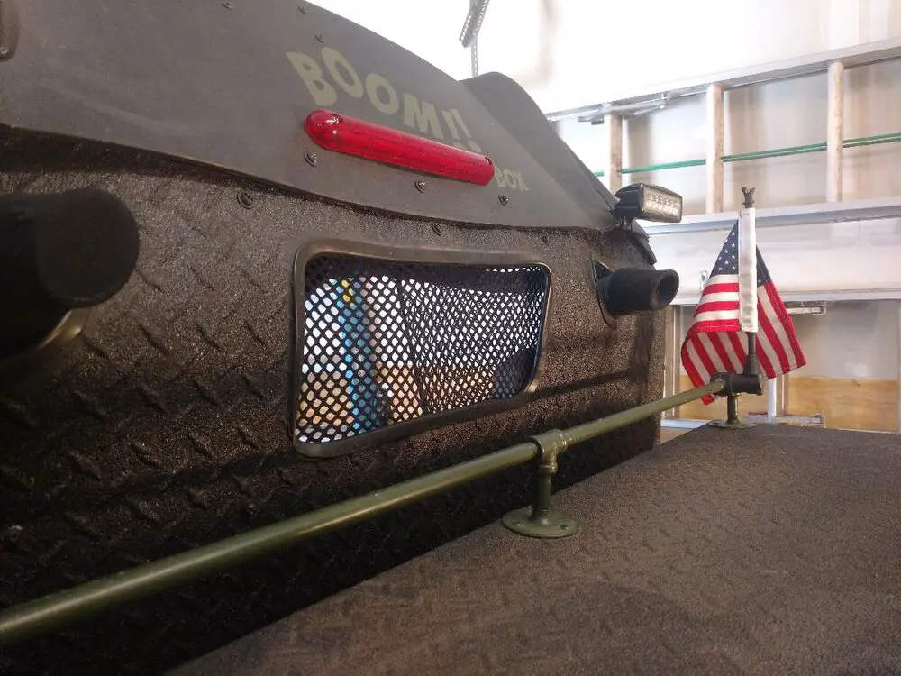

A little more and smoother air. Did exhaust tip same day and motor feels and sounds 'freer'. Snorkel noise at first was a little annoying but now I don't notice it. The fartin in a mud puddle stock tip was worse. Now at upper cruise rpm's it sounds like a single should.
