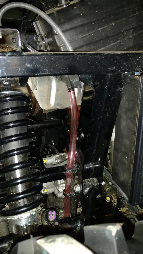

Please en light me what is this (pink tube) and does it need to be snorkeled? :)
And another question, all hoses , from what I see front and rear tranny connected tho the frame 2" above top rim of tires. So if I'm not going into water above tire then no need to snorkel all those tubing? Correct?
The pink tube is the airbox drain. It should have a one way valve on the bottom, so no need to snorkel it. Correct on differential vents. But if you need an airbox snorkel, that's deep enough to snorkel the diffs and fuel tank...
