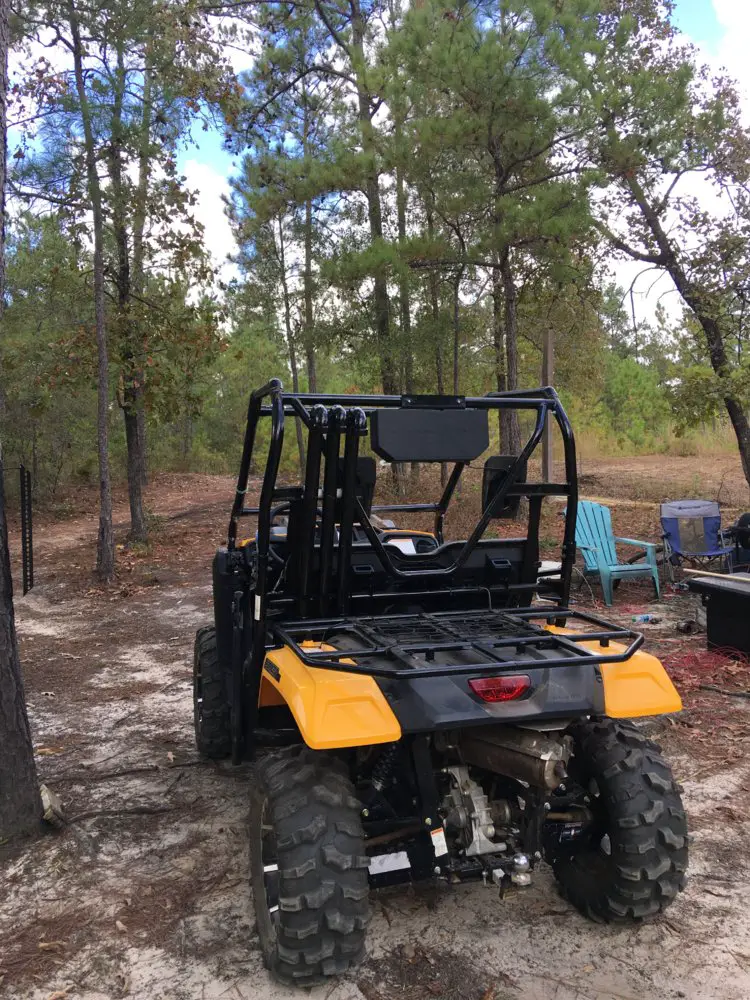

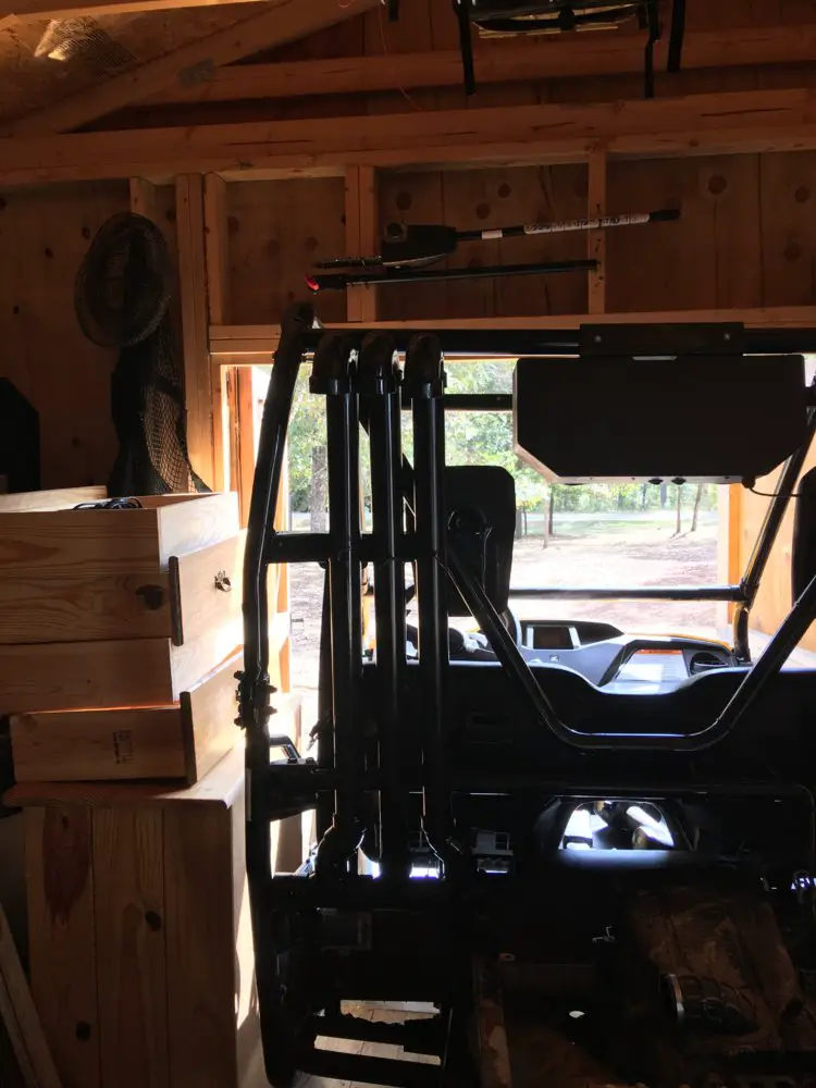

Just got it mocked up on my p5
Had a feeling this question would come up so after studying it for the last week here is my thoughts . I picked the triple stack in an effort to simulate the baffles in the stock snorkel . The extra fittings should create enough air turbulence for proper fuel mixture so that I could take the snorkel all the way to the air box instead of just cutting it in also I chose 1 1/2 pipe for the snorkel and adapted it up to 2" at the air box
that looks really cool! One of these days I'm going to have to get around to doing this... I have a back window, so I'm thinking I want to have the air inlet inside the cab.
