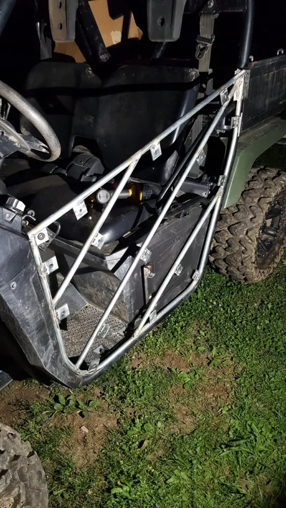

Well update on the doors in have everything needed to finish i just ran into a problem with the swing hinges ugh !!!!! !!! this rough fab sh!t sucks dirty center city balls ( yea that bad) so its down to modify the doors for the hinges or well start over lol so heres the update UGH!!!!!!!

I'm glad I not the only one that had set backs, just take your time and don't try to get it all done in one day,I spent 2 months on my rear seat addition ,ended up making my own hinges and latches.Believe me I know it's hard not to get it done fast, you have no idea how many hours I spent thinking what if I tried this or what if I tried that.I'm sure with your thinking outside the box ideas it will turn out great.Don't give up on us we're all looking forward to the finished product.

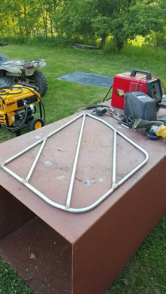

frame complete

Looking good, now the tuff part, making the other one match, been there done that.It can be a b****!
That welding table is awesome
3/8 steel box lol olny weighs about 600lbs lol

That's what I was thinking, just leave those fixed panels alone. Might have to kick the hinge out a little to achieve the correct angle for door latch.
Very cool.
Is this the problem with the hinge? Have to kick it out to clear then fixed panels or...?

no it was the distance between the frame and the door and then the angle and then the size hahaha but i gotter

it was always going to be outside of those with the stock side rop still in place

thanks @Chooglin tomorrow if its not a wash out i have to copy and paste onto the other side takes 4-5 hrs per door
