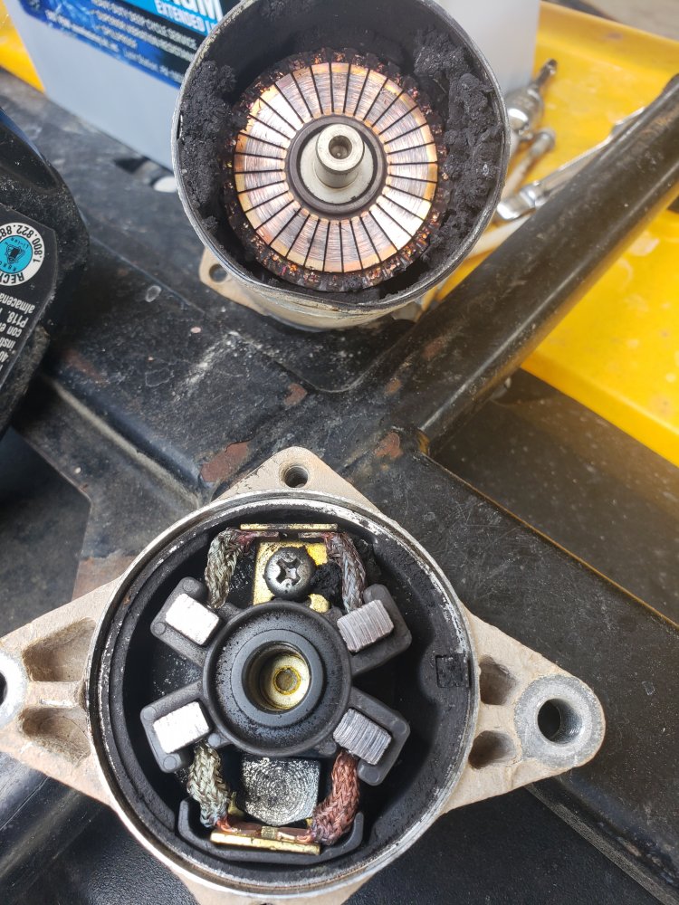

Sounds like the starter has come apart internally. I bet if you removed the two case bolts, the magnets have de laminated from the starter housing.
I'm guessing it isnt supposed to look like this..haha! Any suggestion on starters other than OEM? I'm assuming this was OEM but not sure, still learning as I go. I'd like to avoid another starter change in the future if possible.
Next to trace down the shift error.

My starter went out completely at around 1000 miles. The magnets inside were all shattered.

Wow, that's bad! Mine started making an odd noise so I opened it up and two of the magnets were "free range" Got a 45 dollar replacement on Ebay(I think that's where I got it), and then noticed I was slowly losing oil after rides. Well turns out my cheapo starter had turned into an "oil bath" starter. Swapped the can from the cheapo over to the OEM starter and good to go.
