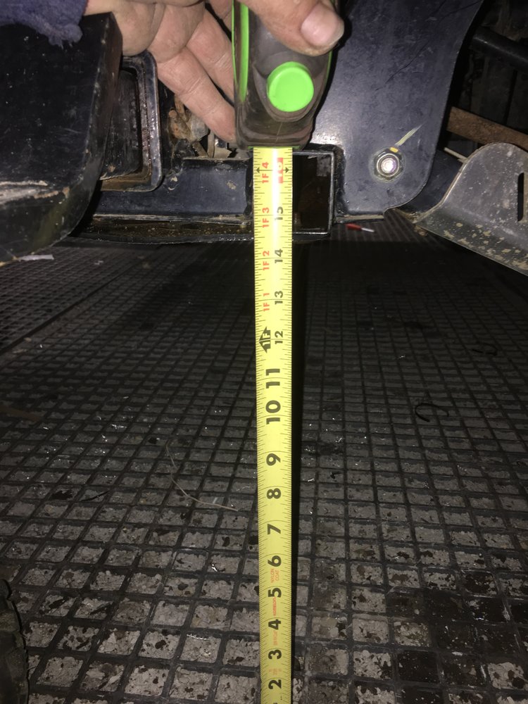

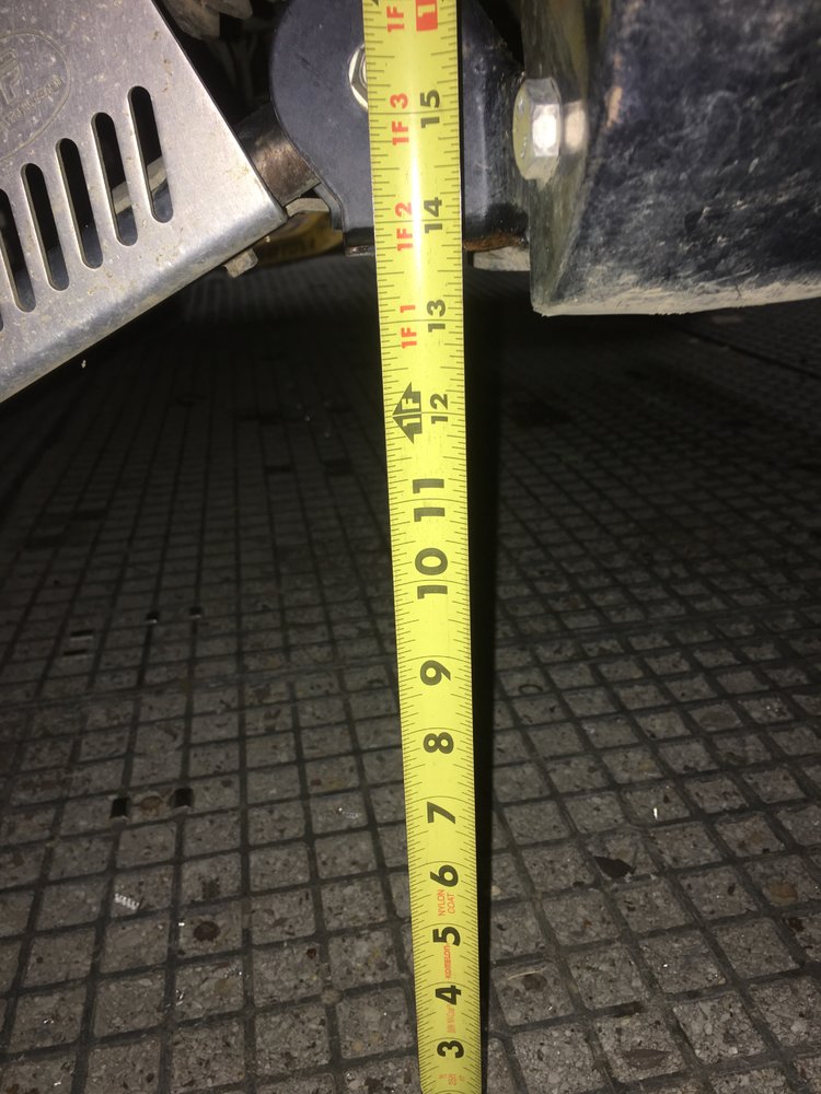

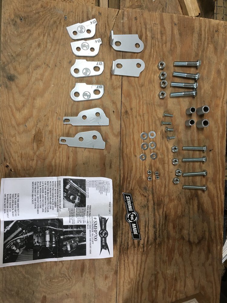

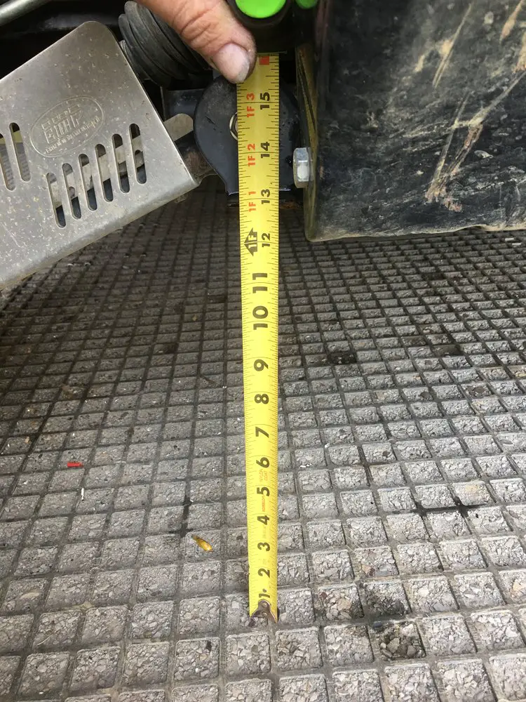

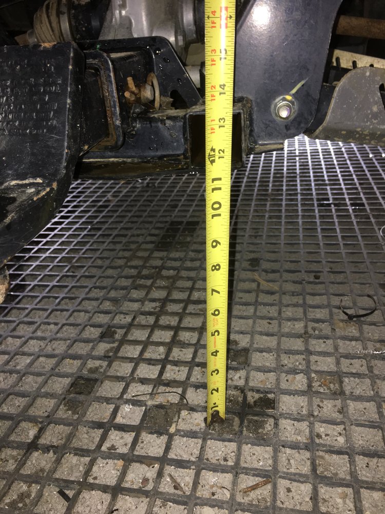

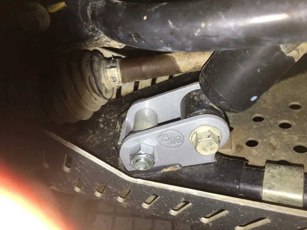

Installed this lift last night.Pretty easy and about 3 hours later I'm very happy with it.gave me 3 more on rear and 2 more on front.I will test it out more today or tomorrow.If you get this lift hold the pics up to a light and look through the paper they are mirrored images for some reason.the fronts were very easy and the rears are a little more difficult and require more unbolting.fronts you only have to unbolt the bottom shock bolt, on the rear you have to unhook stabilizer bar and top a-arm bolt.

still in transit it says...I wont be able to install till Friday night....The lift made the stock shocks feel better too me....but I will have to test them on trails.My tires don't rub anymore on fender flares,and my azz aint sagging is a plus:DI like the stance better too.

Ok I haven't yet received my Fox shocks yet but I have had some time and gave this lift a chance.The ride is great and has made the stock shocks feel like the way I hoped the Foxs would.By bringing the bottom mount in further it makes the shock work easier to hold the weight better by havening less leverage out. But remember I still have my stabilizer bar connected. The ride is fantastic now and the stance is taller.I ride the same area a lot and have had this machine for 3 solid years.makes 28 inch tires work easy with no chance of rubbing the mudd busters bolts. I wished I had got this lift the first year,cause I probably would have been happy with stock shocks and a 1 inch spacer.also I lost 2 inches of width.I will post after fox shocks are on.next Mod will be power steering

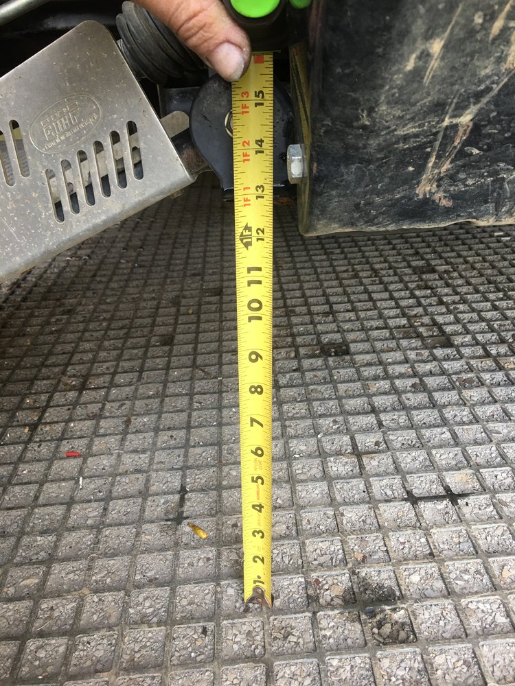

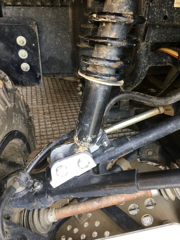

Old thread but anyone looking into the strong made lift for the p700 I strongly recommend. Lifts machine about 1.25”-1.50” and keep cv angles in a good position and not in a bind. Maintained the factory ride quality and helps with the front shocks that like to bottom out.
This is my pioneer with the strong made lift and 28s.
