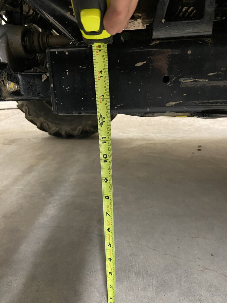

Ordered it Monday and here it is by Friday! That’s pretty nice. Couldn’t find any good detailed pics of the install with close-ups or more measurements than what it lifts so I thought I would order it any so just that. Maybe tonight or tomorrow night!

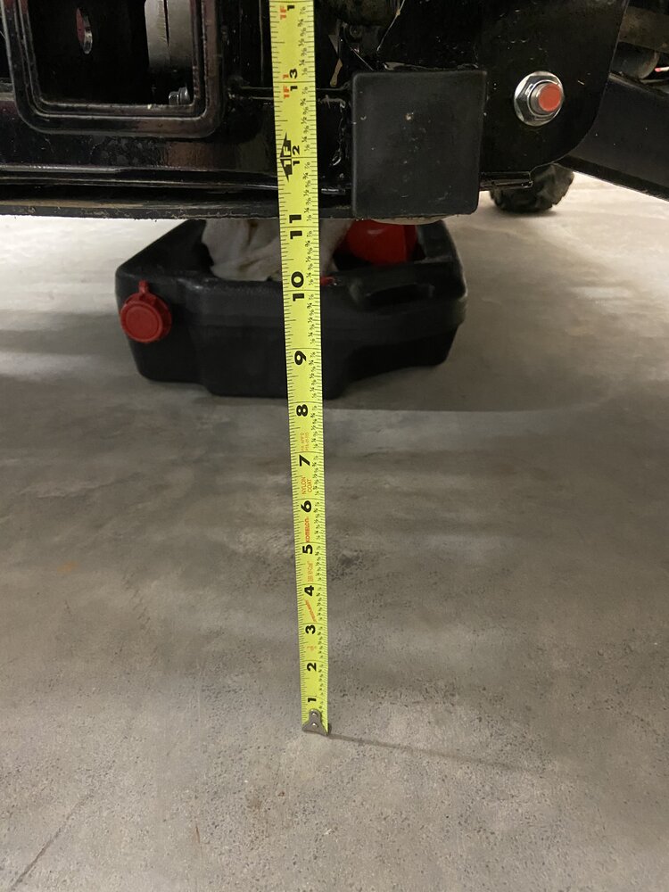

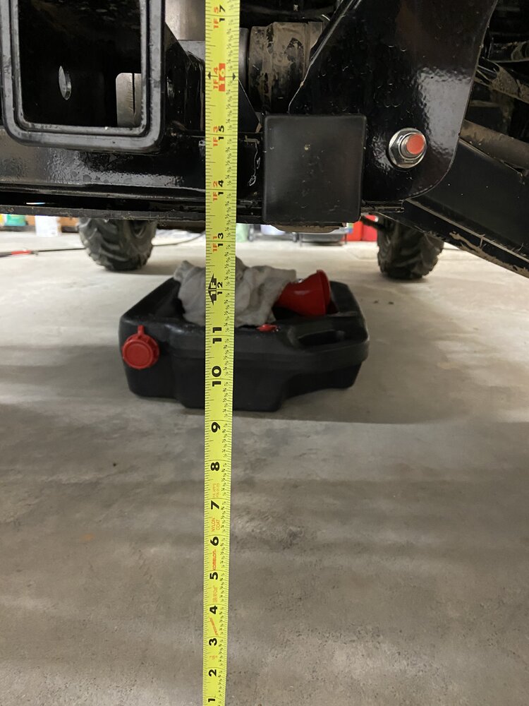

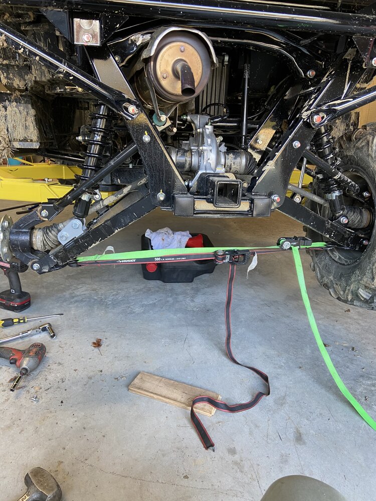

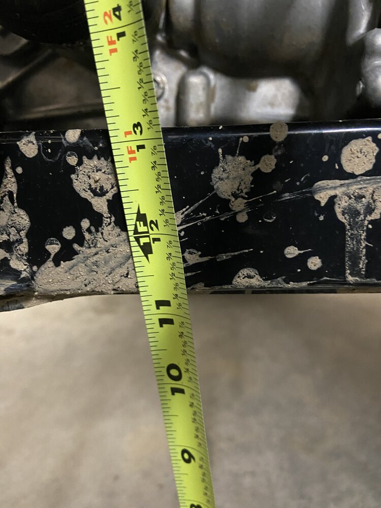

I finally found where someone else went over this setup as previously stated. So I’ll keep it short. Install wasn’t bad at all. Instructions could be better but luckily just looking at it helps. On the rear some people removed the upper a-arm bolt to let it drop down more(nothing said in instructions) but I used ratchet straps to pull it down a littler further and that worked. I gained 1in in the front, and 2 in the back.
