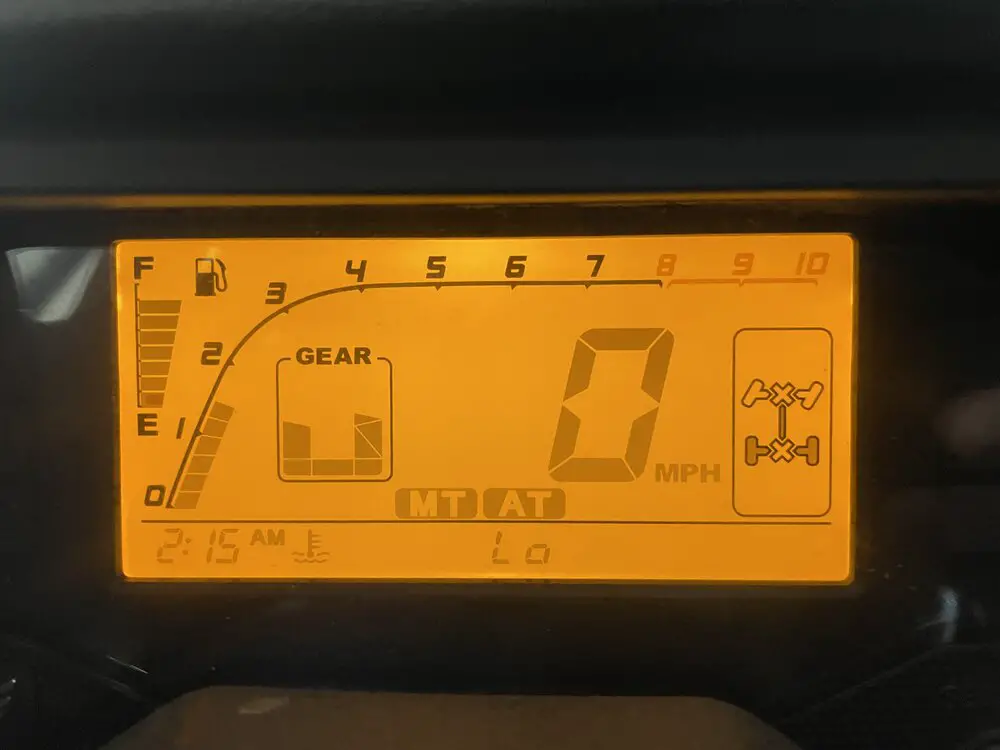

I installed new ECM I guess that’s what you call it
Everything Is running OK and shifting OK but when I’m in park I have this on my dash the gear symbol is halfway on and then I have a manual and auto symbol on never had before
I called the dealer they said it was just plug and play is there some transmission relearn I don’t know about?
View attachment 265895 View attachment 265896
You have to do a clutch relearn. The new ecm needs to "learn" the clutch freeplay to engage properly. The "u" means the oil temp needs to be raised by letting the engine run. Then youll need to shut the key off and start the relearn procedure.

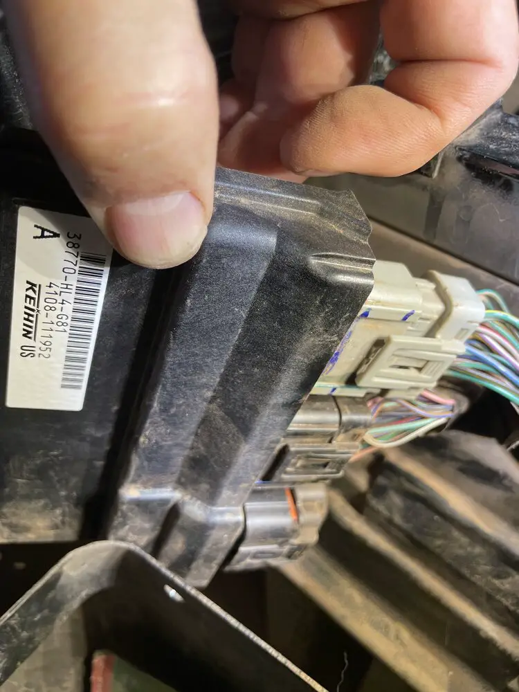

Thanks for the quick reply, I guess they're calling it the PCM (ECM/TCM)? IT's about $270. Part# HL4-G82 Does that sound right?
Sorry to bug you with all these questions, just don't want to waste $$ and time at the dealer if I can do it myself.
I attached a photo of the part PCM/ECM
Mine was HL4-G81
Also check your fuel injector wire harness This problem is intermittent and well-known

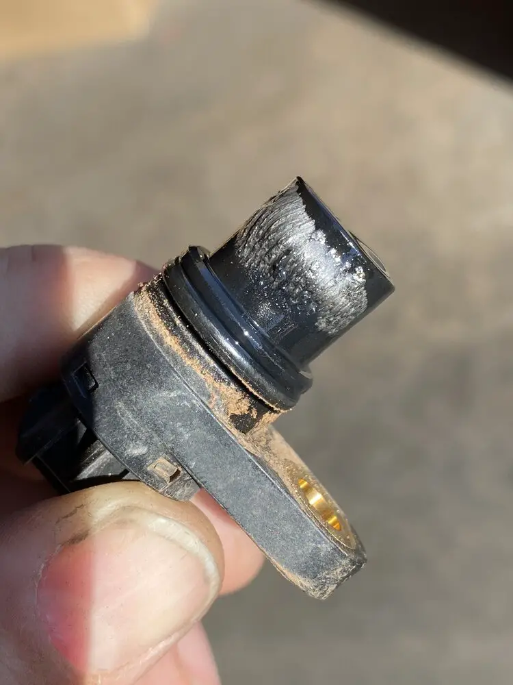

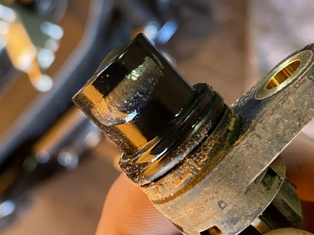

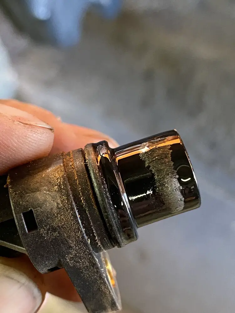

Got my ride back from dealer they could not reproduce the symptoms of it being stuck in first gear they did some troubleshooting but did not find a definite answer
codes they did get suspect it was a battery issue
They said the battery tested good but suggested buying original factory battery also they checked the speed sensors and they did find some odd wear or metal on the sensor here’s a photo of it
We also discussed information about the ECM under the driver seat overheating as I discovered in another post on this website about Customer having the same issues
if it happens again I may order a new ECM and see if we can control the heat under the seat
If anyone has any input feedback is appreciated
View attachment 231728 View attachment 231729 View attachment 231730
