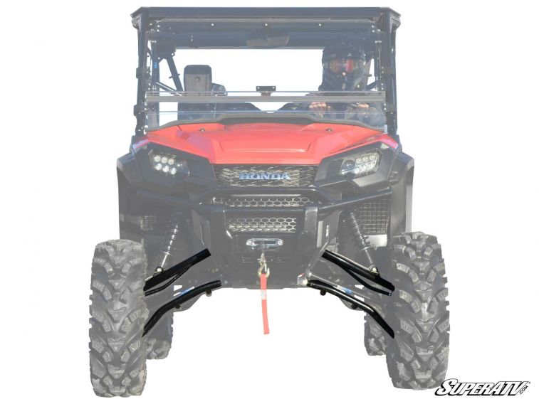

I can't seem to get SuperATV To call or email me back, Does anyone know if The A-Arms move the Axle forward, like the forward arms? I plan on running the A-Arms without using the lift brackets to get more travel and also width. Anyone also do something similar? Plan on doing 814 shocks as well.

I'm going to say 95% yes. There images are of 32" tires. And it looks like it would clear the fender.

I really can't tell if it's clearing because of the lift or because it moves the axle forward. It's been three weeks with several calls and emails with no response.

Exactly, that would have to be forward or you would not get 32” ers in. I have 30’s and I needed just the standard forwards to make those clear.

I wish there were 2 or 3 inch extended arms. I would buy then. Seems like they are adding 5” per side.

Yes, There would definately be a market for 3" Extended arms and maybe a little more travel for the 814s, id like to push the rears arms a little more further back then whats currently offered to give it a tad more wheel base. I rode with a guy with a Teryx4 and he could walk up some of the steep stuff, while I was raising tires on the same line.

It is the same A arms they sell separately, so yes they offer 1.5" forward on front and 1.5" back on rear.

They are not the same a arms offered separately, they push machine to the 72" width. I found out they do add some wheelbase but haven't figured out how much, most people running the 6" lift are also running portals

I am almost certain it's the exact same A arms, they want you to or expect you to run 4+3 offset wheels, that with wider front tires puts you at 70-72" wide in front even with OEM a arms. They just bundle the 3" lift brackets, tie rods, axles, and brake lines as OEM isn't long enough at that angle etc.

The installation manual for the stock arms and 6" kit shows the length setting. Think the 6" lift arms were like 4.5"-5.5" longer on each side.

Yeah, I know. It’s over $2k, comes with axles and tie rods as expected.
