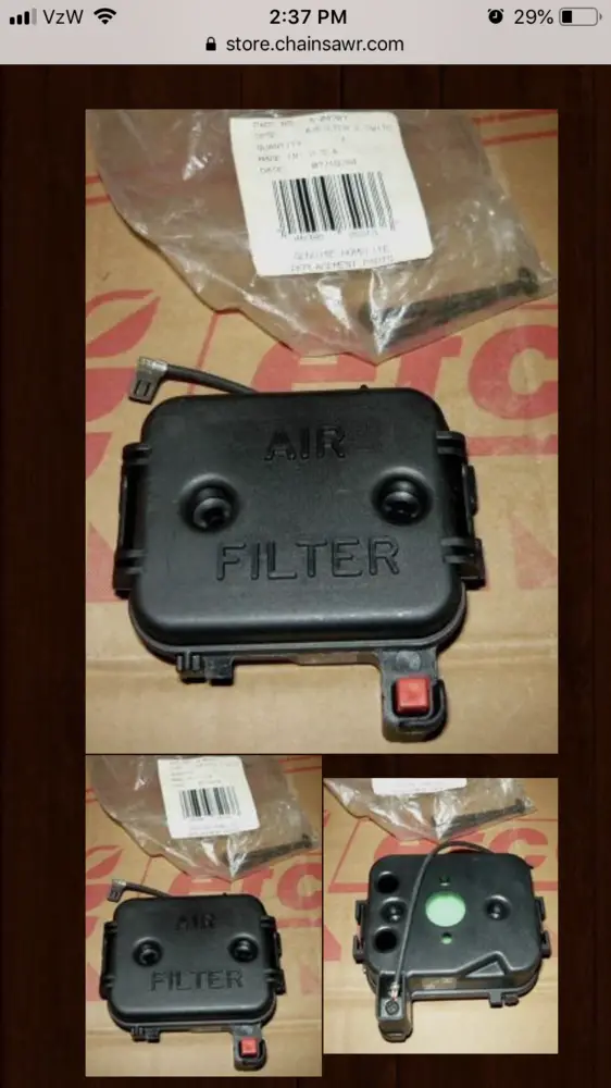

I also thought about building some kind of filter box that I could route all the vent lines too..
Modifying something like this. A central location for all lines.

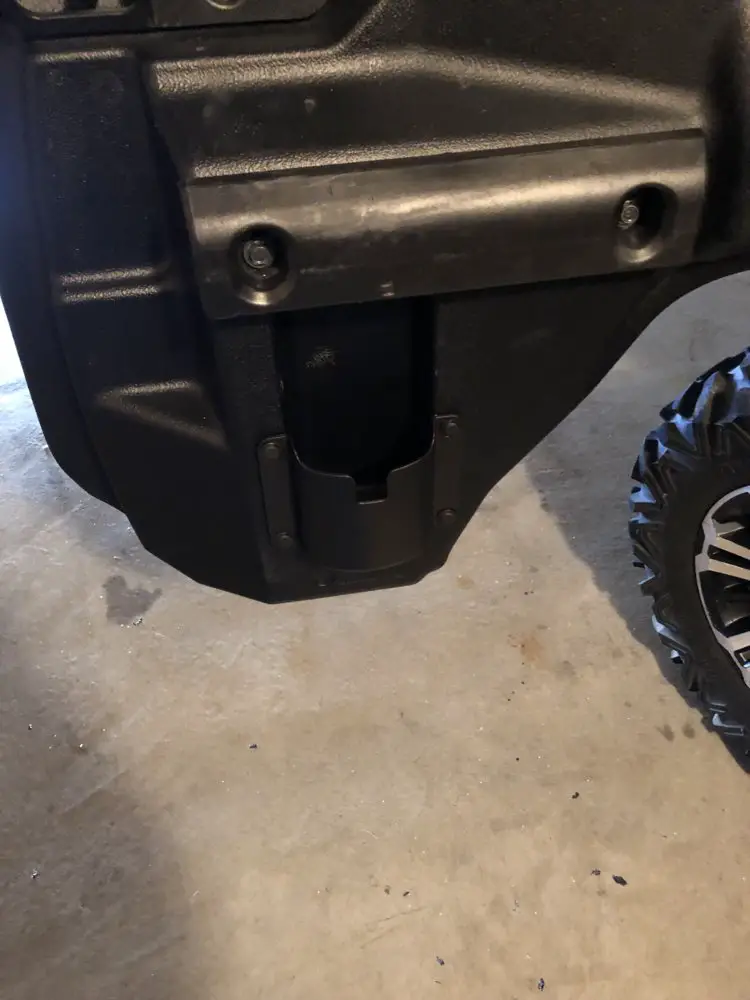

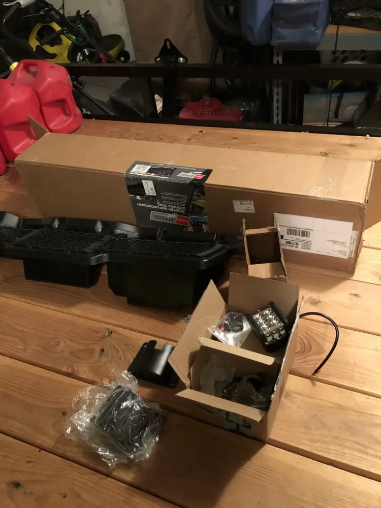

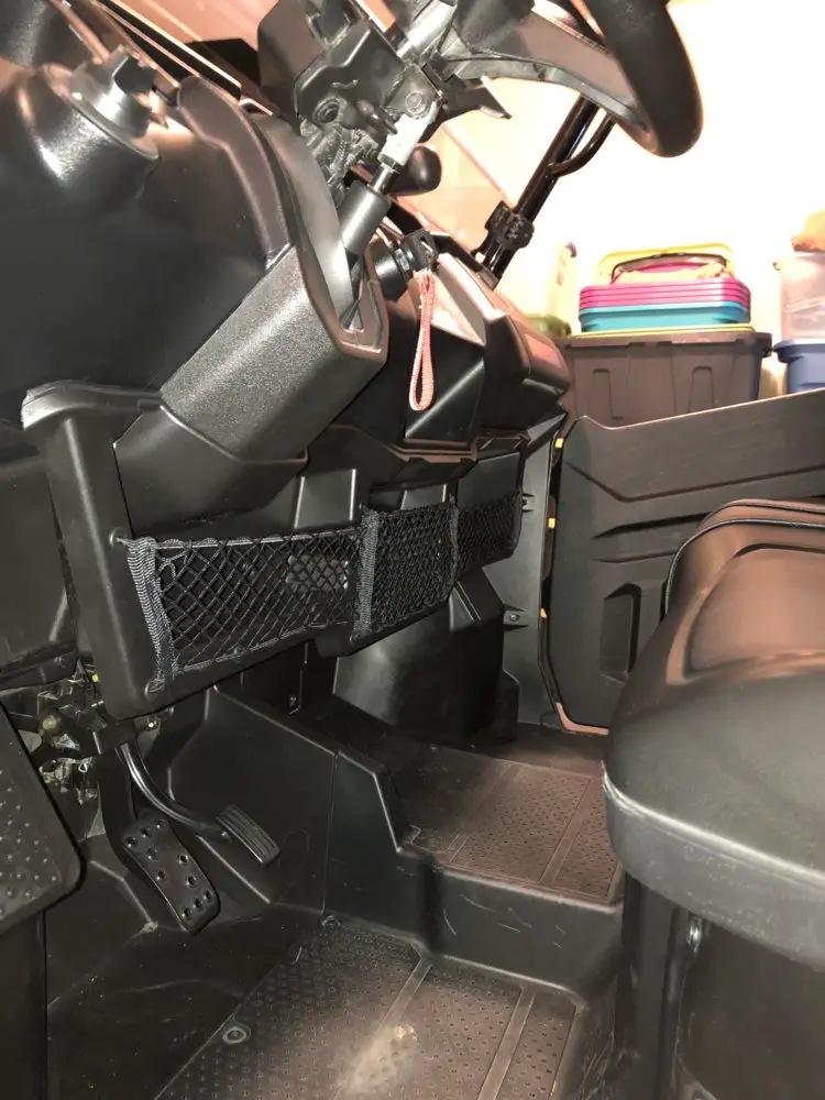

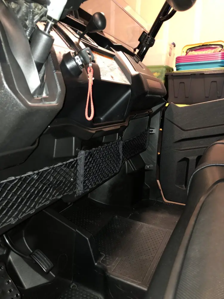

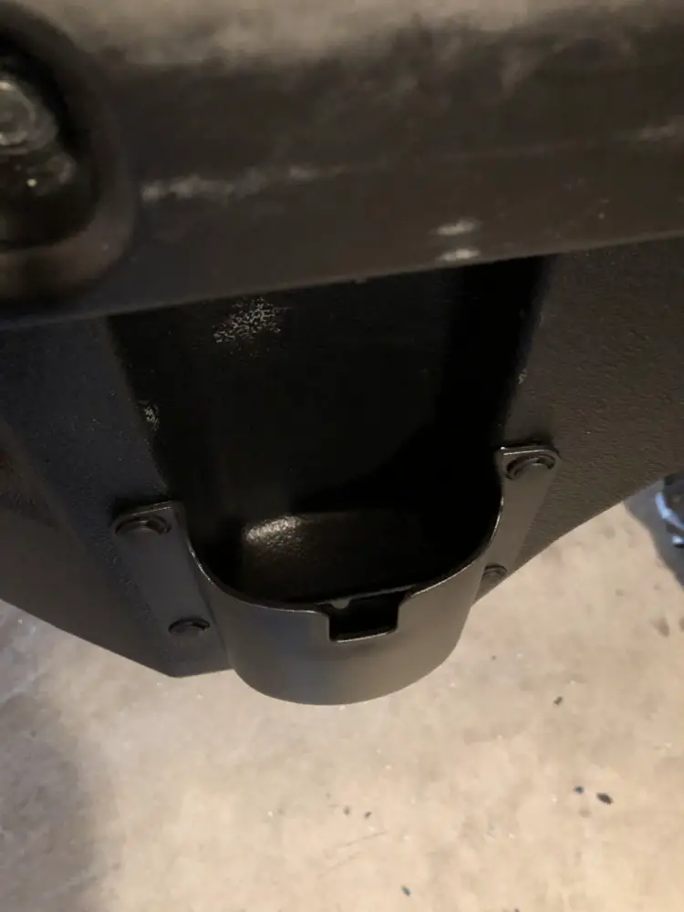

Got the under dash storage from Honda, and the door cup holders, NOT from Honda. These ones are a little bigger. Happy with all of it, seems well made.
Also got 4 pods and switch for the front bumper. Just waiting on the rest of my dual battery setup to trickle in.
View attachment 99059 View attachment 99060 View attachment 99061 View attachment 99062 View attachment 99063 View attachment 99064 View attachment 99065

I was also going to say the instructions say to use a 3/8” drill bit for the under dash storage and cup holders.. I used a 5/16 for a Much tighter fit. FYI.

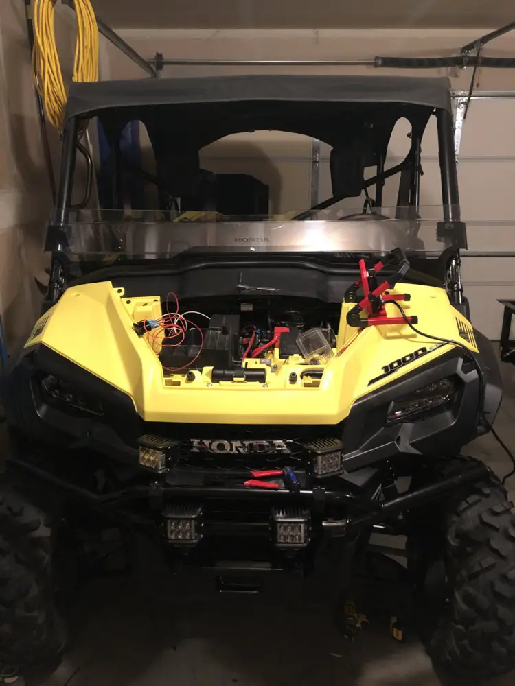

We have lights! I still need to clean up the wiring under the hood and find a spot I like to mount the Tru, Stinger and fuse box. I’ll start making my switch board inside the cab. Side note: the wife decided on the yellow, I was on the fence and it grew on me, I love it. The wife also decided on the color blue for inside the cab(switches and whore lights), I wanted green. Now that there’s power to it, I like the blue! Haha. Women.. Anyways, with these pods, I get damn near 180degree coverage, which is what I was hoping for. Any objections to using good 3M double sided tape on the fuse box to stick to the top of battery??? I’m not sure where else to put the damn thing. Haha. I have a spot in mind for the Tru, Stinger and relays(not like in pic.).
