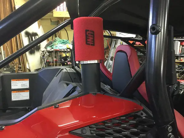

I took friends for rides, both of us wearing earmuffs. I dropped the muffs to say something at ~25 mph and was stunned at the mechanical noise the Talon makes, it was painful. I immediately gave up on any conversation. It surprised me because I'm usually wearing earplugs inside my helmet.
Snorkel - behind the passenger seat, no rear window - at easy cruising speeds, I don't notice 'much' intake noise but there is a drone. When I'm trying to push the skinny pedal through the radiator, it 'might' get really noisy but I'm pretty dang preoccupied under those conditions, so the intake drone takes a back seat. Regardless, I can't ride in a Talon without hearing protection and a helmet alone isn't enough.

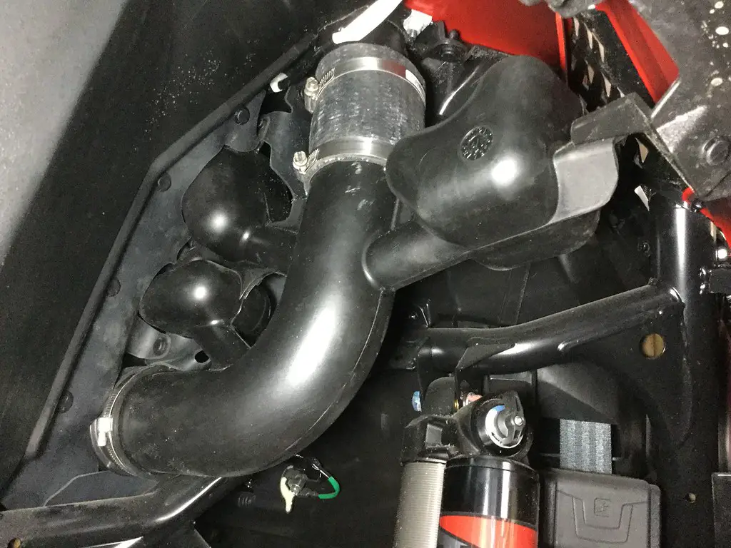

I copied Hondabob's snorkel idea because it keeps the goofy stock intake plenum. I'm not sure if it's for tuning or noise control, maybe both but I didn't want to remove it for either reason.
The goofy intake plenum, stock config -
Modded for the snorkel riser -
Outside -

Short version - maybe ...
Outside -
Outside -

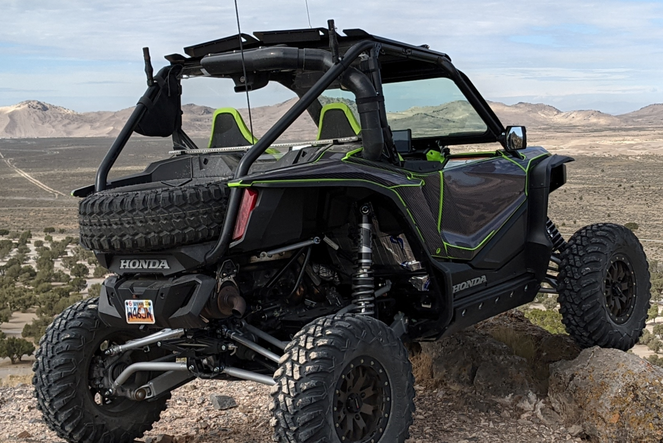

I am still happy with my Hondabob style snorkle, with the prefilter under the roof, in front of the rear window. I installed that before I ever rode the machine. 3200 miles and neither filter has needed to be cleaned or replaced. YMMV.

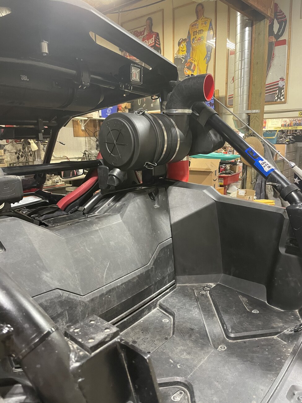

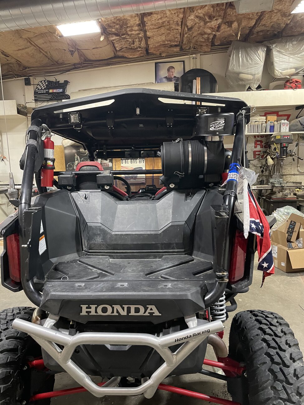

Donaldson canister - high flow - very little dust even gets to the filter and way cheaper than the S&B

This is the route I will likely go. Happen to have a PN for the housing you used, and do you keep the filter in the Donaldson as well?
couldnt find the part number. I remember they offer 3” and 4”. The housing was $80-$90, filter was $20-$30, the top spin was expensive $300. If you don’t have a turbo, you could prolly use a smaller one.

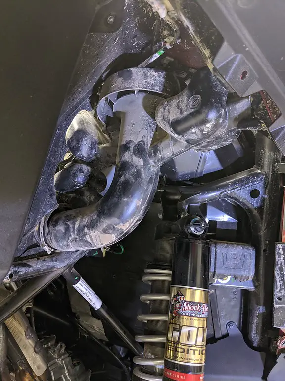

If you don't remove and throw away the Honda intake tube that attaches to air box there is no intake noise at all. That tube is engineered to quite intake noise. Hond Bob's intake uses the tube and I have no intake noise. I had an XP900 Polaris and it made a lot of intake noise right behind my head.
