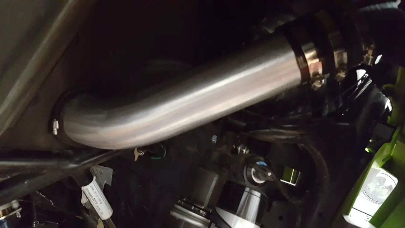

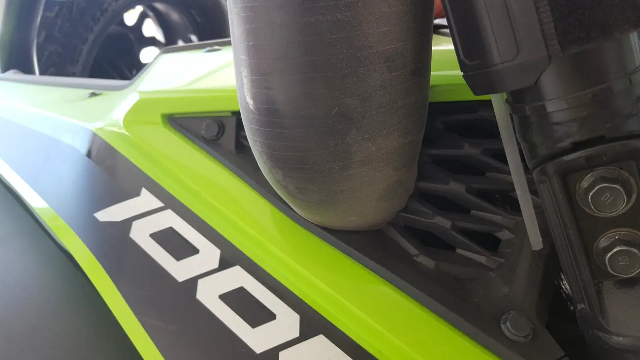

I ran 2 1/2 inch intercooler tubing through the small hatched vent on the passenger side rear fender (no drilling). You can get intercooler tubing part sets on eBay. I raised the roof on pipe nipples about three inches, which gives good airflow, helps mitigate dust, and gives room for the intake pipe to clear the rear window. It also gives the intake a view of good clean air from the front of the vehicle. The big ugly part in front is 6-inch ABS pipe from Home Depot with a rubber reducer to fit to the aluminum tubing. I put some 1/2 inch foam around the inside of the ABS to mitigate intake noise, and inside of that is a UNI filter. The UNI basically never gets dirty, and noise is not an issue. I don't really drive in the rain (Mojave desert) and trailer the Talon backwards for tongue weight.

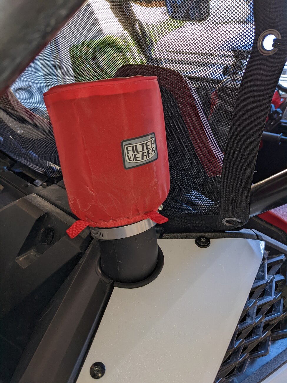

I kind of followed you and Hondabob on this one and came up with this version in the end. I'm very pleased with it. I can't say I notice any difference in intake noise at all really. I wear hearing protection either way anyway. I run a rear net as opposed to a glass screen and a flip up front windscreen (being in Arizona). This intake is a very sturdy set up and I retained the stock airbox with plenums, etc. I had to commit to cutting into "two" pieces of plastic for my stack to come through but I wanted the straightest route I could get. I have the Filter Wears cover over a UNI Filter.
PXL 20220209 222235513 PXL 20220128 004738949
42,070
322,785
View attachment 327224 View attachment 327225

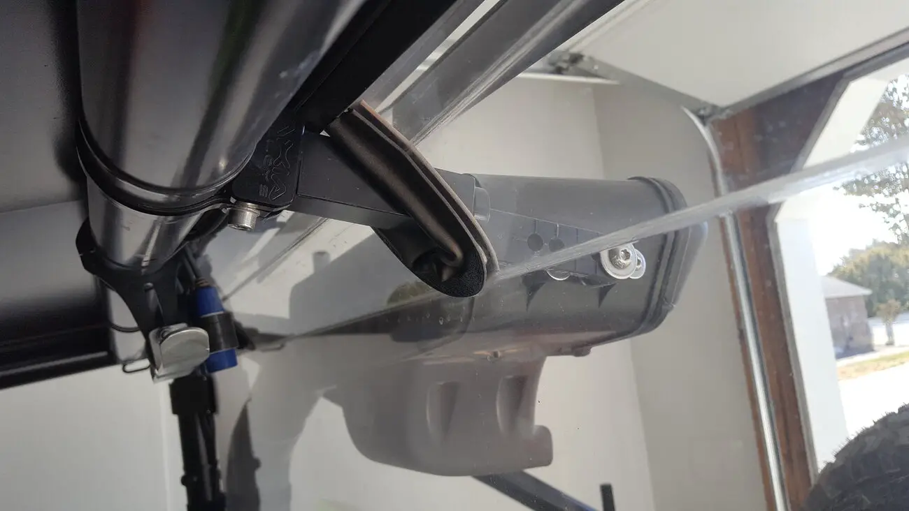

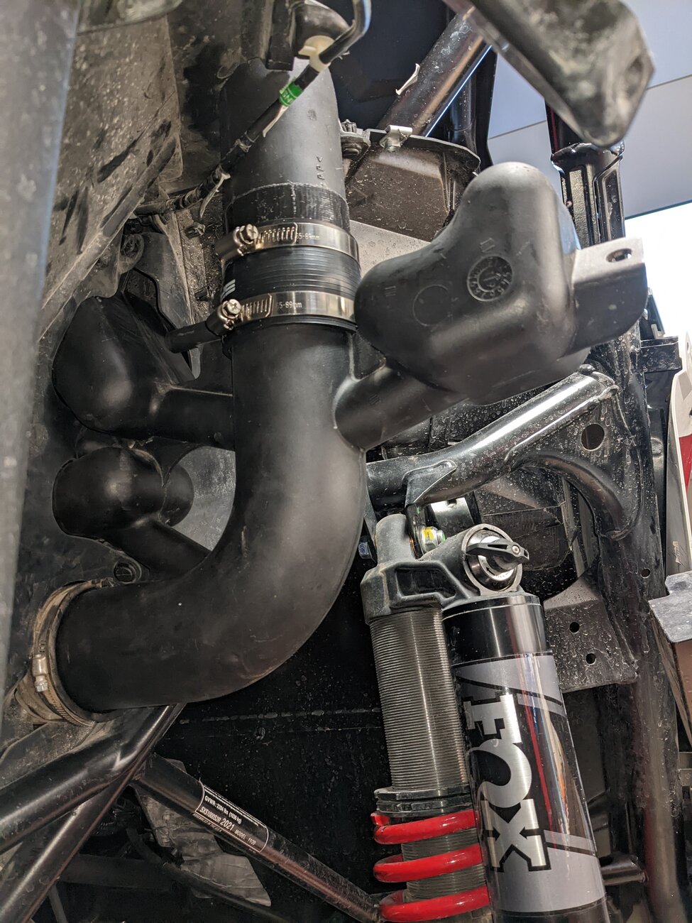

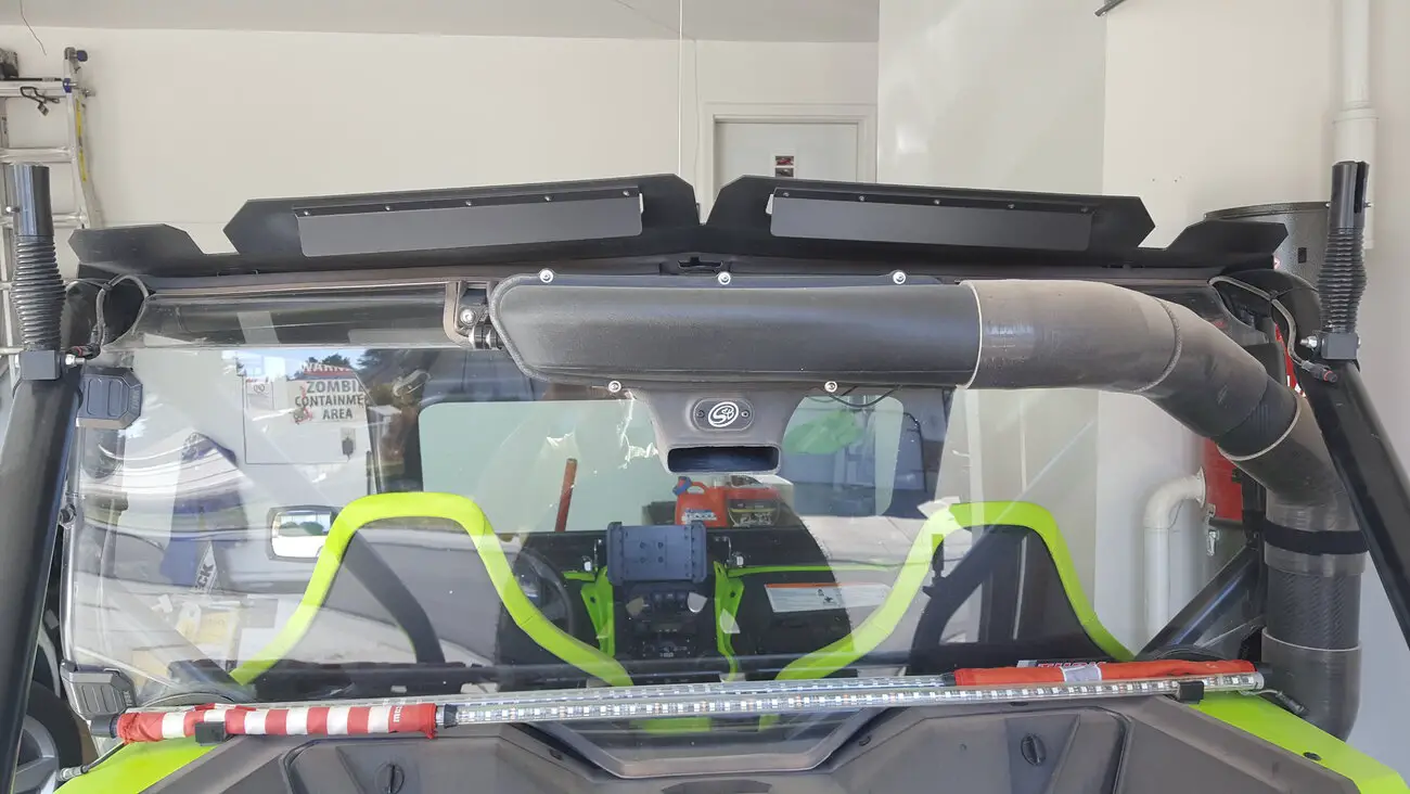

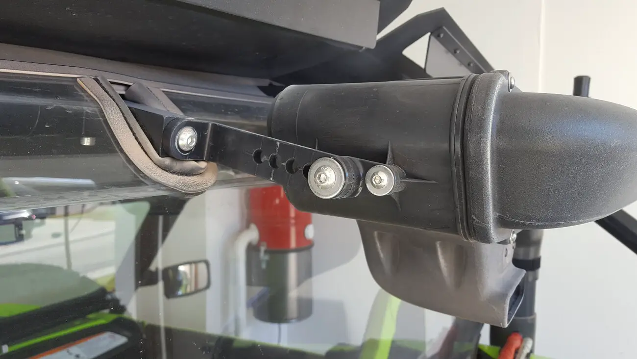

I was told by S&B that if you have a rear window, you cannot mount the Particle Separator as the window blocks access to the roll cage (needed for mounting brackets). If you do try and mount, a cross arm, such as an elevated spare tire mount is needed. Is this not the case??
You need to be inventive. I made extensions and mounted through the rear window. Works like a charm as long as you maintain at least 2" behind the window BUT with the new model (PS2), it requires 6" although the PS2 is not available for the Talon yet.
I got mine before there was even a Talon specific model. Used the Can-Am unit because it had 2" roll cage clamps and hard plumbed it through the side vent...

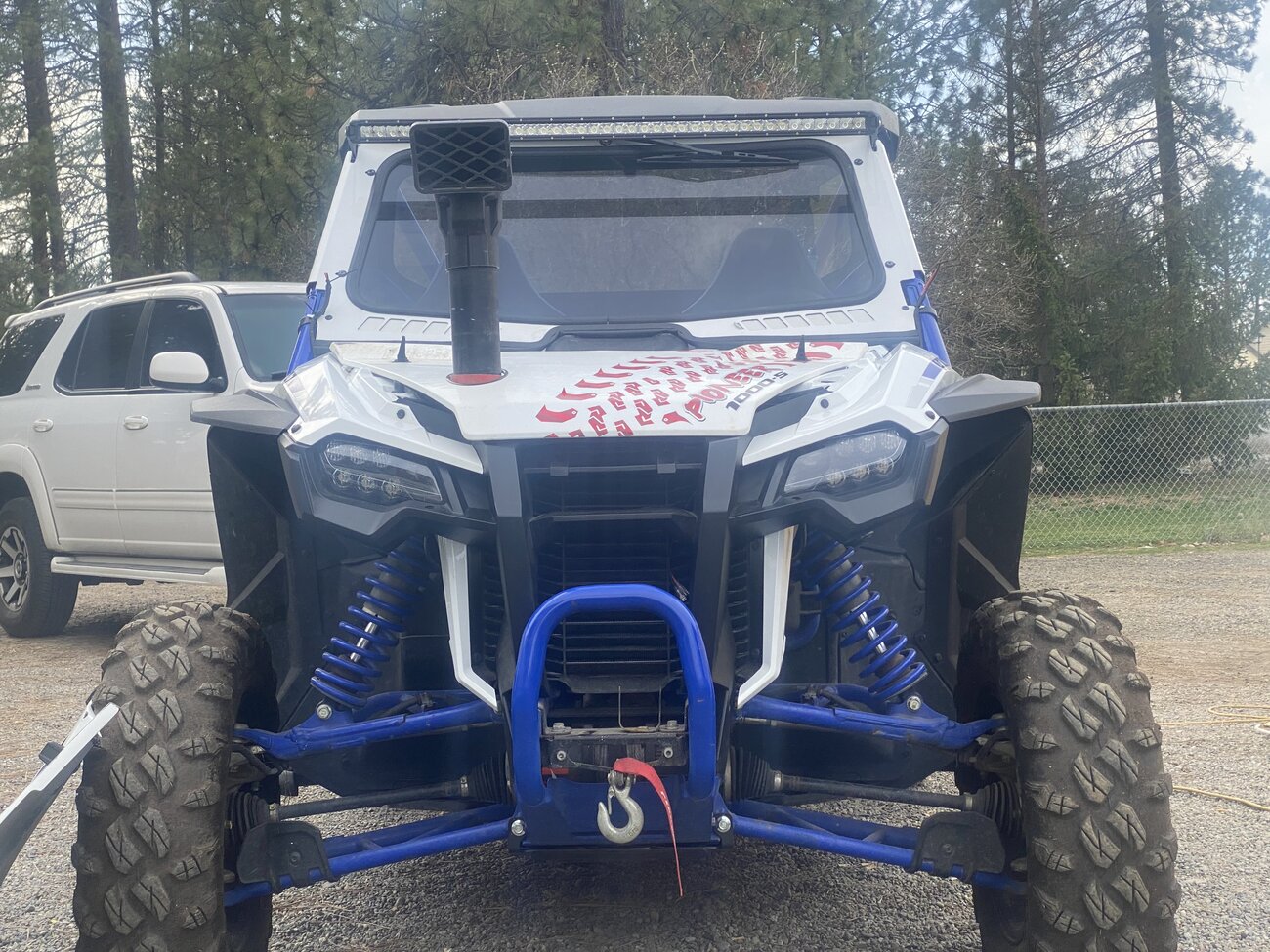

Did set the Pioneer hood and snorkel on the other night still thinking about it though.
A plus for creativity, but I seriously hope you didn't follow through with this. A lot of us followed your rebuild thread and your talon looks great with the end result. I'd hate to see that good looking machine ruined with that ugly pipe through the hood.
If I had easy access to a pipe bender and could do it right with 4” aluminum pipe I’d do it. Don’t want some conglomeration of crap for intake.
But I’m over the idea for now Rear prefilter coming.

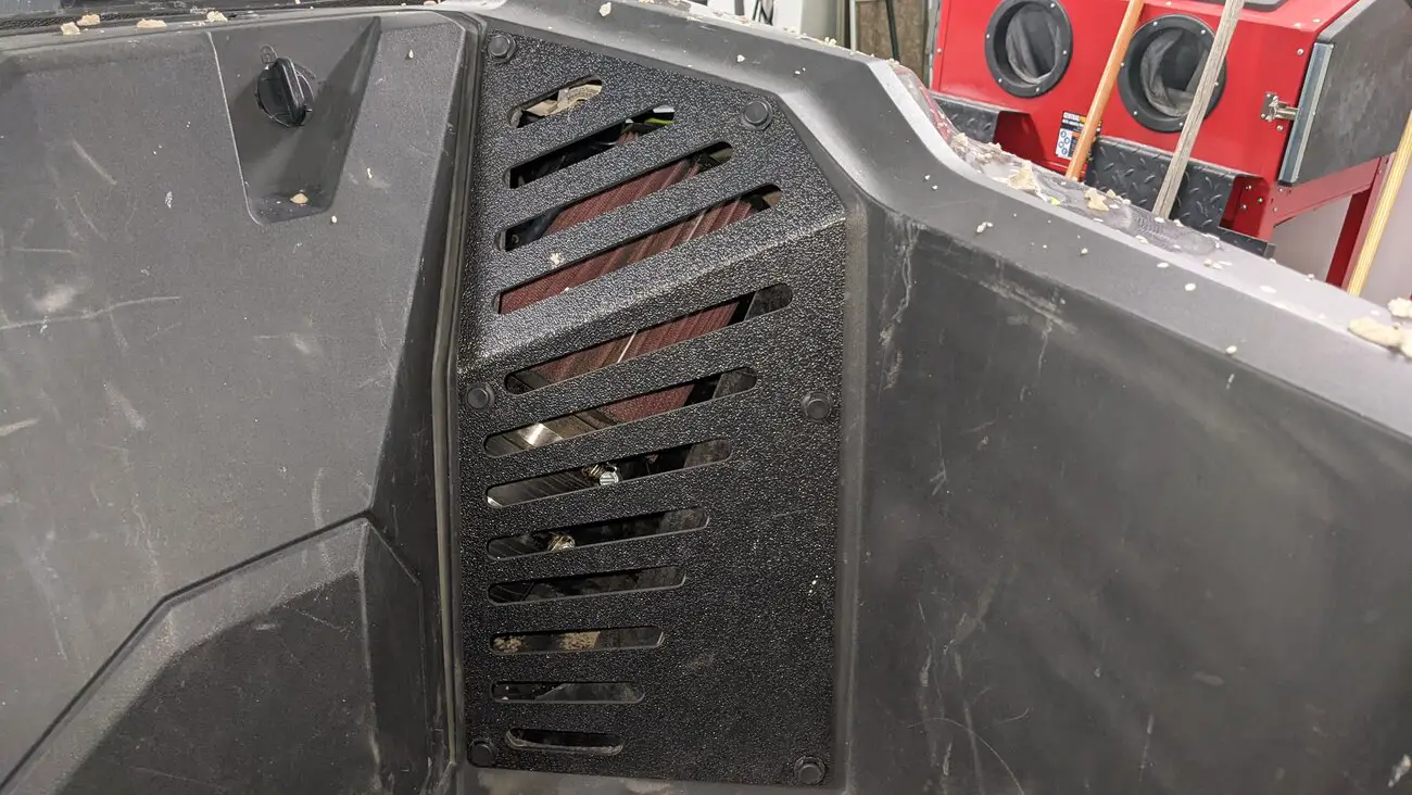

PXL 20220123 194111750
42,070
322,785
To be perfectly honest, I WAS an S&B fan until recently. I took it off and put a pre-filter because...
  • It blocked some of my rear vision and I could never get used to it.
  • It is bulky and personally I think they are a bit of an eyesore (but not as hideous and the KWT).
  • Was a little noisy (even with a rear window).
  • And the final nail in the coffin is a wire came lose on a real dusty ride, it stopped working and and it dirtied up my filter real bad. No power and the thing is nothing more than a real expensive snorkel.
I guess I am never happy. I had a pre-filter through the fender before the S&B but it was just too noisy at the dunes when wide open so I got the S&B. When I saw the BVC unit in the fender, I decided it would be hidden and quiet enough with the rear window so I fabbed one out of parts on hand. I was skeptical that it would keep clean in the fender but the louver keeps air flowing and to my surprise, it works really well, is out of the elements and is pretty quiet. For now, I am OK with this.
Not for everyone because it lowers the intake location a few inches but I don't do deep mud or water so it works for me...

Thanks! My CNC router made short work of the cover and I prefer it somewhat hidden in black but other than that, it is a blatant rip off from BVC :cool:. I had all the parts so I though I would give it a try.
