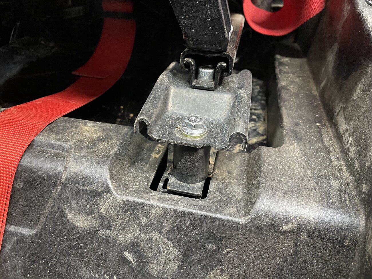

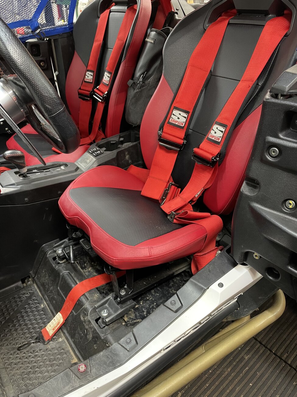

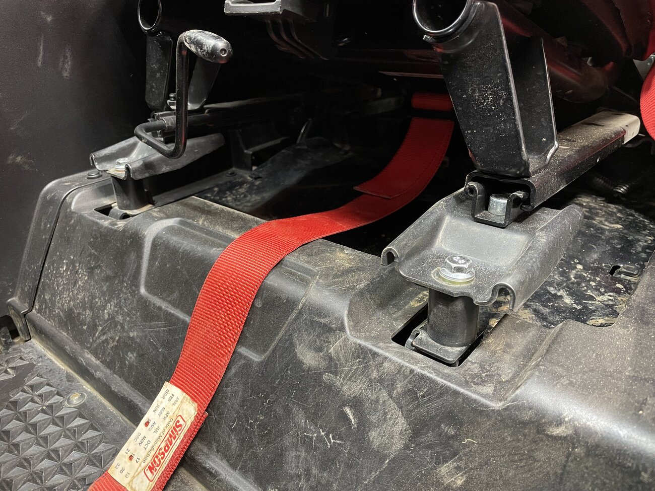

OK so I had to try the seat spacer deal. I cut 2 pieces 1.25" long from some UHMW PE Plastic Rod that I had left over from another project. Quite an amazing difference. Test it out more this weekend and decide if I want to try spacers on the rear of the seat also.

Terry, if Mrs. Terry is anything like my wife, you better do her seat as well. She didn't like that I was sitting higher then her.
