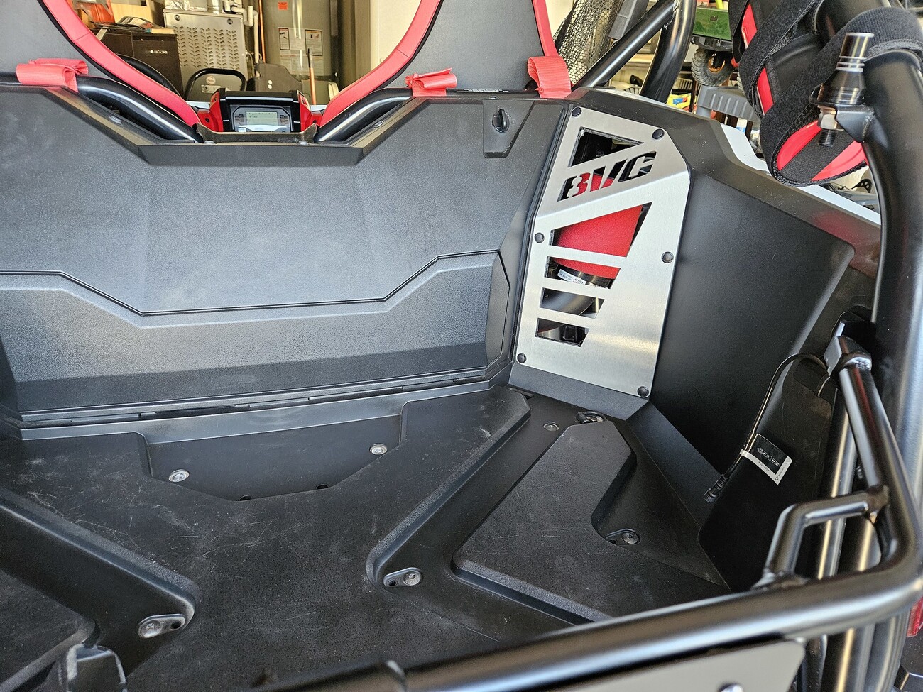

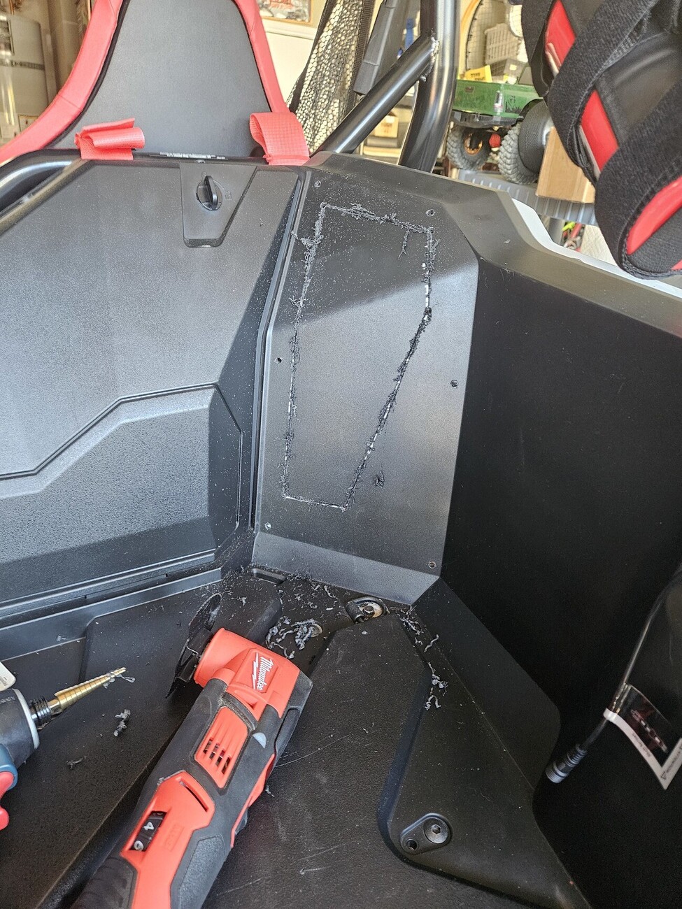

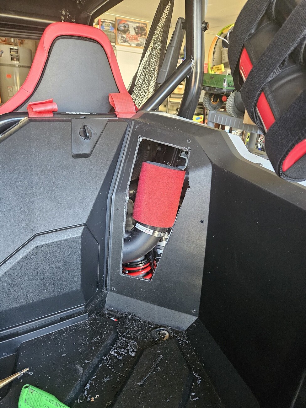

I may look into that 10-80 pre-filter later on. I must confess i didn't know it existed until You guys pointed that out :) oh well, i'm trying to learn as i go. For now i'm using the BVC cover with with a shaved OE snorkel and the Uni6300AST filter.
I did the cut already
View attachment 42838420240508_151547 by RAM RSM, on Flickr
View attachment 42838520240508_153345 by RAM RSM, on Flickr
View attachment 42838620240508_155906 by RAM RSM, on Flickr
What happens when u put packouts in there like the rest of us?
Might have a little room to still breathe. Let us know how quick that clogs up under there. Will be interested to see particularly at the dunes.

Sure i'll update as i go. I haven't thought about packouts yet. This stuff gets expensive very quickly, Damn.

Yeah thats dusty. Thought in one of your other threads u said dunes? My bad. Close enough where u will be lol.
We have sandy trails here and its gets bad. I have the Dirts filter set up and its up high not under the fender and dosnt take long to plug up. I have one of those skin covers for the filter, it helps some. Might want to look into one of those.
As for adding up 🤣😂 sure does! We aint joking when we say youll be re mortgaging the house soon! 🤣

The problem with that ^ is that the rear tire is still throwing all kinds of dirt, dust, sand, and mud up there.
I did the BVC on my '19. It worked good but was still in a horrible location. Filter changes were frequent but very fast and easy, plus it keeps the filter out of the rain. But when I changed from a storage box held in by bungee straps to the Moose box that I bolted to the bed, it became too much of a pain to change the filter. The Moose box had to be unbolted and removed to be able to remove the BVC plate. I went with the 10-80 Dirt sports filter on my '23.

My filter held up without any issues with the BVC cover, i don't see it dirty at all, the outer sock i added on top of the UNI did what it needs to do and i ordered a 2nd one cause i'll need it.
But, i can see the point where having to change that filter will be a tad more cumbersome and that dirt may accumulate rather quickly given the location, but more importantly for me i did cut a little too much of the OE snorkel down (closer to where the pipe has the elbow) and i don't like how the filter is held up in place so i ordered the 10-80 UNI pre-filter kit. I should have it this week. I'll pay especial attention when making the hole. It seems i'm too quick making cuts only to realize i f...d things up after the fact. I don't want to mess this one up.
Thinking to use a small drill bit and make little holes using the template they provide. I don't have anything that can make round holes so hopefully that will be ok..

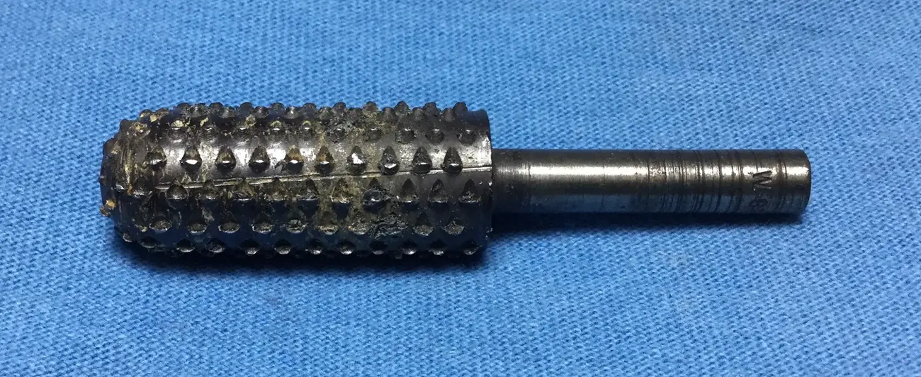

It doesn't matter how bad you mess up the hole, the 10-80 flange covers all of it.
But here's how I cut my hole (not a 10-80 Sports, he hadn't invented his yet) -
I R5KVWnT X2
I hZgkGhP X3
