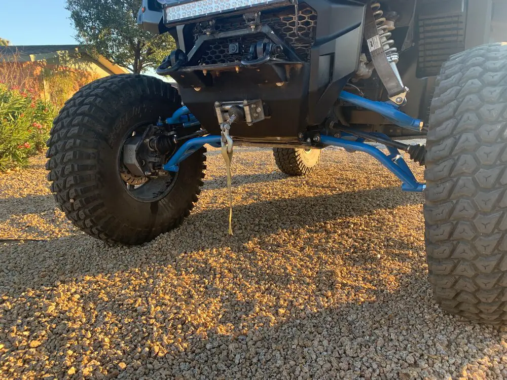

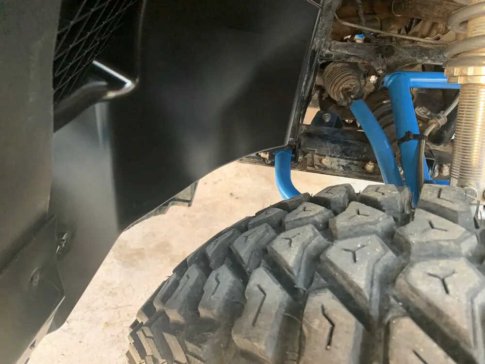

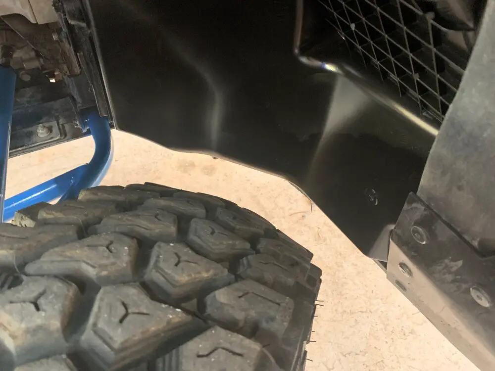

Well everything is installed, looks great and works even better. I have the 814 shocks (1.5" of lift) and 4" portals and easy clear 34.5" tall tires. I could probably go with a true 36" and not have any issues. I am very happy with the purchase! The last two pics are at full lock, look at that room!
