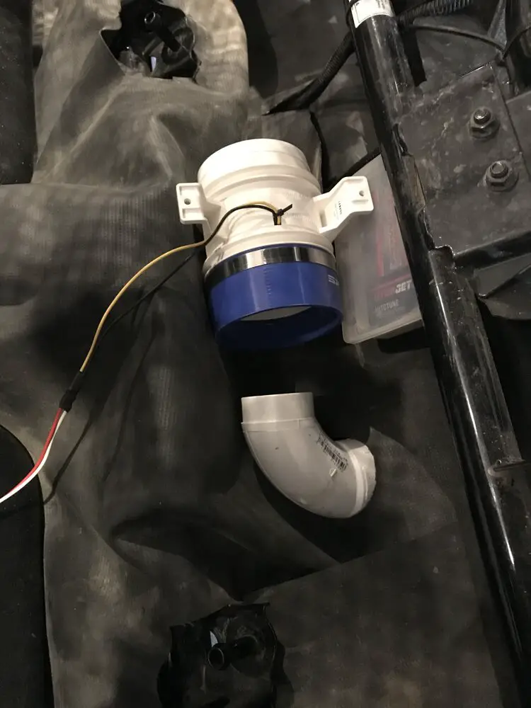

So i guess I got "too much time on my hands" again, as all my peers with kids tell me time and time again. I am in the process of hooking up an Attwood 4" 1749-4 "bilge blower" on the snorkel side of my air box. Just for kicks and fun!
On that note... This will not be forced induction for anyone with wild ideas on a $30 turbo. Hence the supercharger in quotes in the title. You cannot create boost with a fan. This IS simply a fan, and a fan moves air, does not force induction or create pressure like an air pump or compressor (like a turbocharger or supercharger). However, what it could do is help flow, or natural aspiration. Through my engine tinkering I have definitely realized how little these 500 heads flow. The last time I had my head off, I opened up the exhaust and intake ports and really polished the exhaust port and combustion chamber. It gave it noticeable gains and my PC-V fuel map is a little richer, so I know it's moving more air.
Doing the math with 561 CC, at 7200 rpm, that is 72 cfm airflow at 100% volumetric efficiency. So if this 235 cfm "fan" is even 35% accurate to spec, I should have less vacuum. Again not boost, but less vacuum. I did order a vacuum gauge but won't be here till Monday. I am also keeping my snorkel setup intact in case this is a worthless laughable test.

Right now I'm, just waiting on one PVC adapter. If I knew the mailman was going to be later today, I would have made the 75 minute round trip to Home Depot yesterday or this morning. But it should be here today. I am running the fan to the cig lighter temporarily and no "snorkel" after the blower in case I ditch the idea.

I also don't have a good way of time/speed testing. I tried to do 0-30 mph times, but my Lowrance fishfinder GPS is a good second behind, so I used the factory speedo and was getting 8.5-9 seconds with my "stock" snorkel. With the @906UP gears that should be 35-36 mph. To do comparisons with the blower, I'll just bring a passenger and have them accurately time the factory speedo to 0-30. The speed won't be accurate but it will be a good comparison with an on and off.
And right now waiting for one adapter.

My part came! Good ole Amazon I got a box of 4 adapters instead of 1 for $1.90 LOL. I did some 0-30 tests but very tough watching speedo and using a separate stop watch, etc. The difference was minimal and our times were all over the place, wasn't working out. Plus I should have played with my clutch setting, must not have much play as shifts seemed long. However, after running test after test, there is a moderate gain on low end. You could just hear the engine bogging much less. The two tests I did that made the most difference, and I wish we just recorded videos instead of playing with the stop watch, was 11-20mph (all factory speedo) in 4th gear going up an incline, and starting out in 3rd 0-15 on flat ground. Starting in 3rd before was a second or 2 of bogging. Now with the fan on it almost feels like starting in 2nd.
Today is a bad cold & windy day, but I'll post pics of the completed setup, and later this week I'll try to take videos of those tests.
One other note anything above an idle I have to drop my head to the seat backrest to hear the fan, which is perfect. Can't hear it under normal driving but can still check to make sure it's working without stopping.
So in conclusion I will be permanently wiring it in. For trail/forest road riding probably won't notice anything, but for yard work, crawling, towing/pulling, obstacles, or hairy slow hills, I definitely feel a gain! There are other 4" fans with higher cfm ratings I might try, this one just has a good brand name and is more compact.
