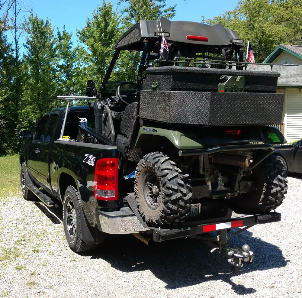

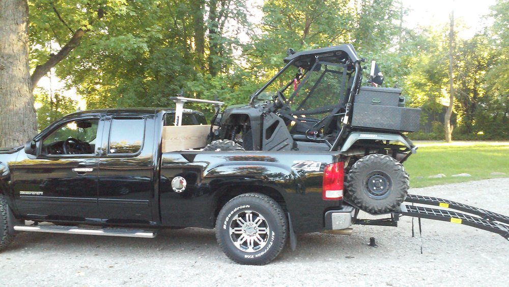

Loading into the back of a truck is a little hairy the first time, then it's no big deal once you've done it. Using the longer ramps makes the incline less but makes you ride those rails a little longer. I opted for the wide ones as that's what I was more concerned with. You'll need a hitch extension and, like Mudder said, some tailgate supports to pull the travel trailer as well. Or get one of these, won't need your tailgate and the extension is built in. Also helps with the ride height and COG. Sold as the Iron Man, I don't use it anymore and would sell this one.
View attachment 85937 View attachment 85938
I like the concept Trigger... thinking I might weld additional receivers on my class 5 hitch cross bar. Then slide in an assembly to replace the tailgate with the weight onto the hitch/frame. That way can use the trailer receiver to tow keerap if need be. Cool thanks for the idea, nice.
