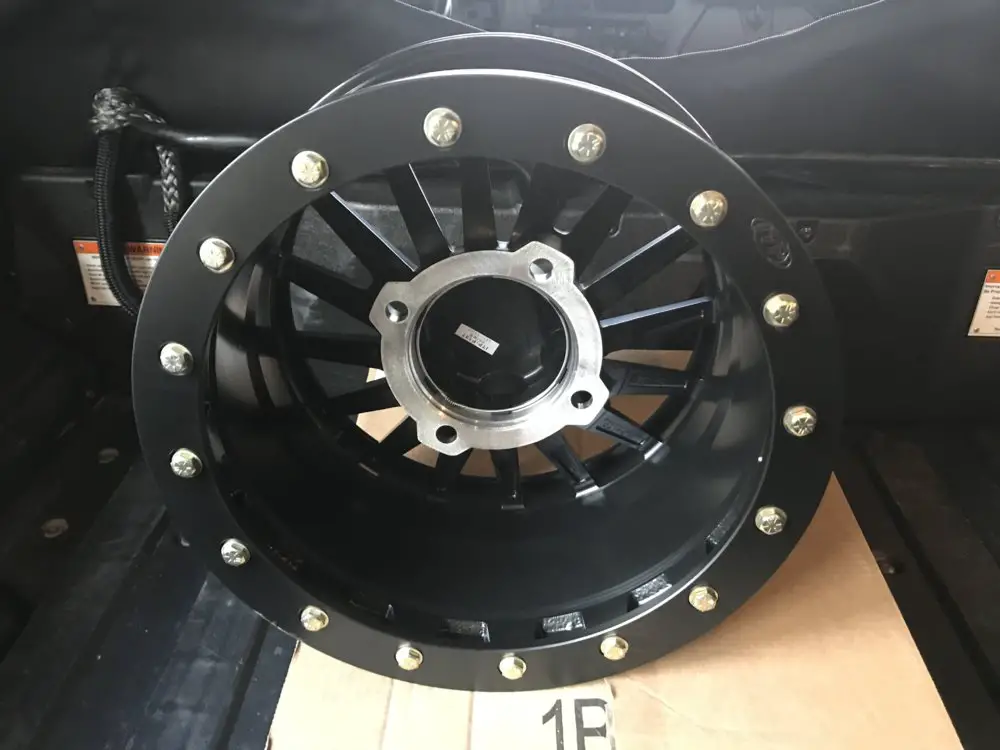

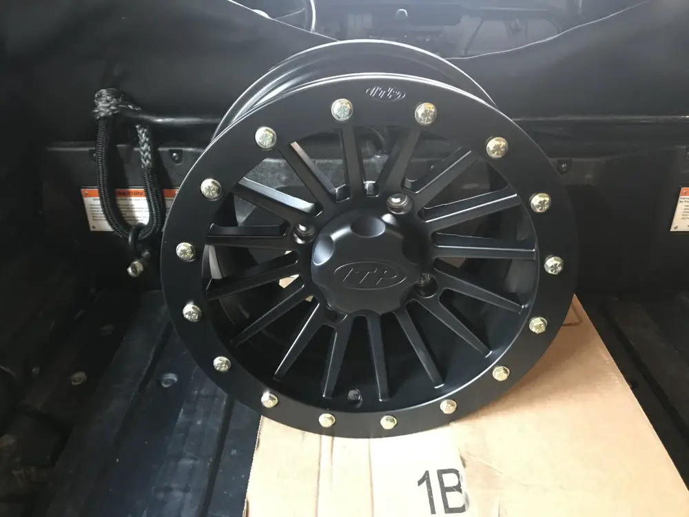

I have dual beadlocks, and So far so good I used bead sealer on mine and I do have a slow leak on one that takes a couple of weeks to lose down to 3-4 psi from 8-10.
BUT the rings have taken a lot of abuse that might have punctured a tire and sereral times I’m fairly positive at low pressure I would’ve pulled a tire off the rim.
If you do have a flat it’s an easy trail patch even from the inside. So I carry a innertube and patch kit(I figure if I am patching it I am not TOO worried about torque specs) along with my ½” drive impact wrench with a lug nut socket( I’d tighten them by hand but I’d remove them with it for speed)
Inner tube and patch kit is much lighter and smaller than a full size spare tire and cheaper too. I can fit it in the Fat50 ammo can under my seat with all the tools I carry, I don’t even have to take up space in my door storage.
ITP SD Dual beadlocks

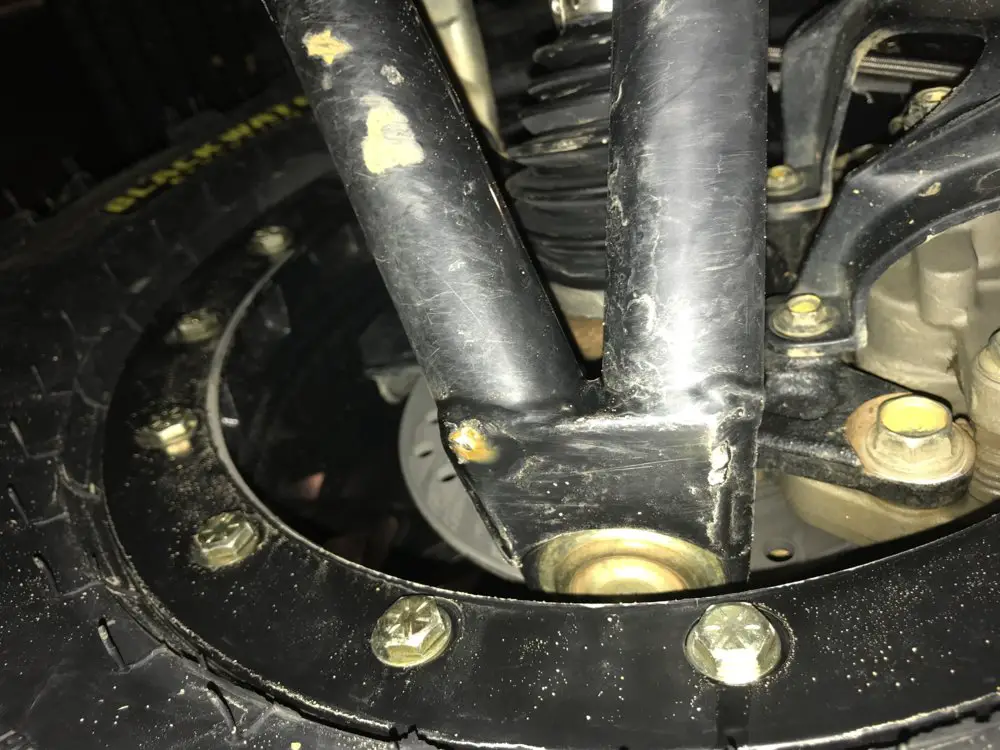

They did rub on my SATV arms until I added a 1” spacer.

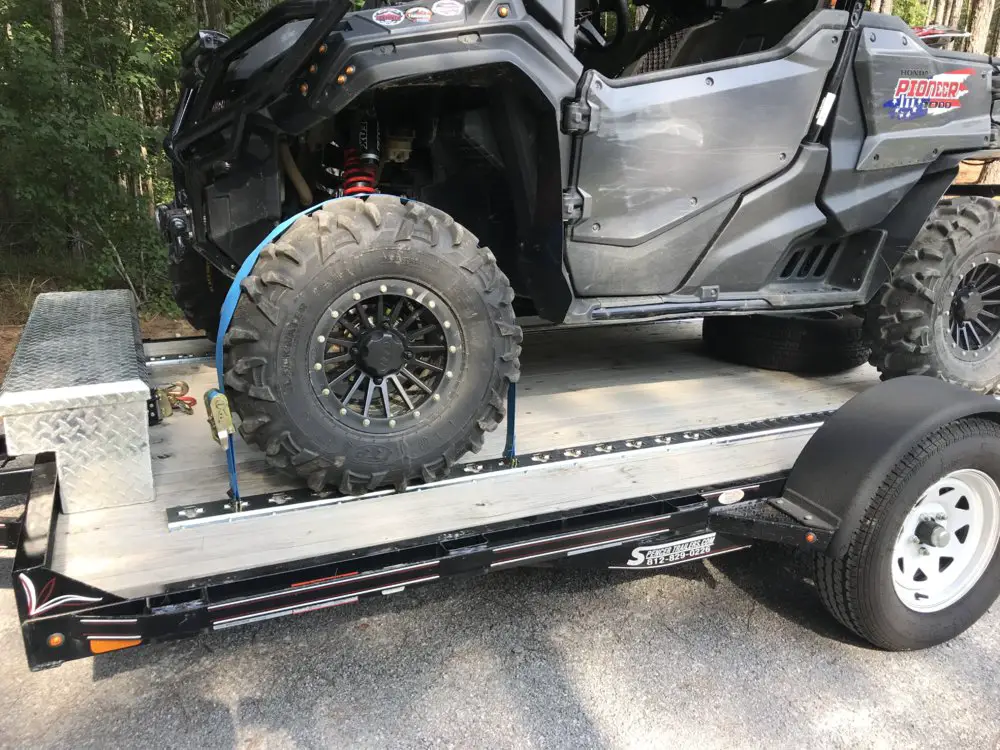

Thanks @ohanacreek . Btw, nice trailer!! :D
