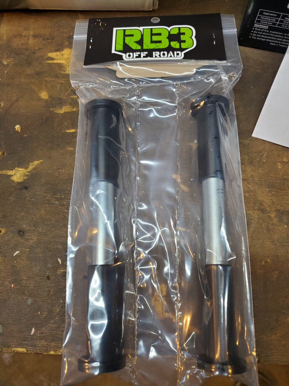

But, @ToddACimer Didn't you reach out to rb3 for some custom bushings for your setup?
I think he did. @RB3offroad lack of description and @ToddACimer review on their website had me a little confused on what exactly comes with the kit

these were the upgraded bolts for @ToddACimer please call me if this isnt what you wanted. my number is 480-389-7486
I received the 12 MM a arm special in the mail today. I called RB3 before I made the purchase to confirm if this kit came with the bolts or not. I understood that it would come with the bolts but it did not. Only the bushings and the metal sleeve is in the kit. Not a huge deal as I can get the bolts I need from the local Fastenal. I was just completely confused about this. Needs to be a better description on their website about what exactly is in this kit.

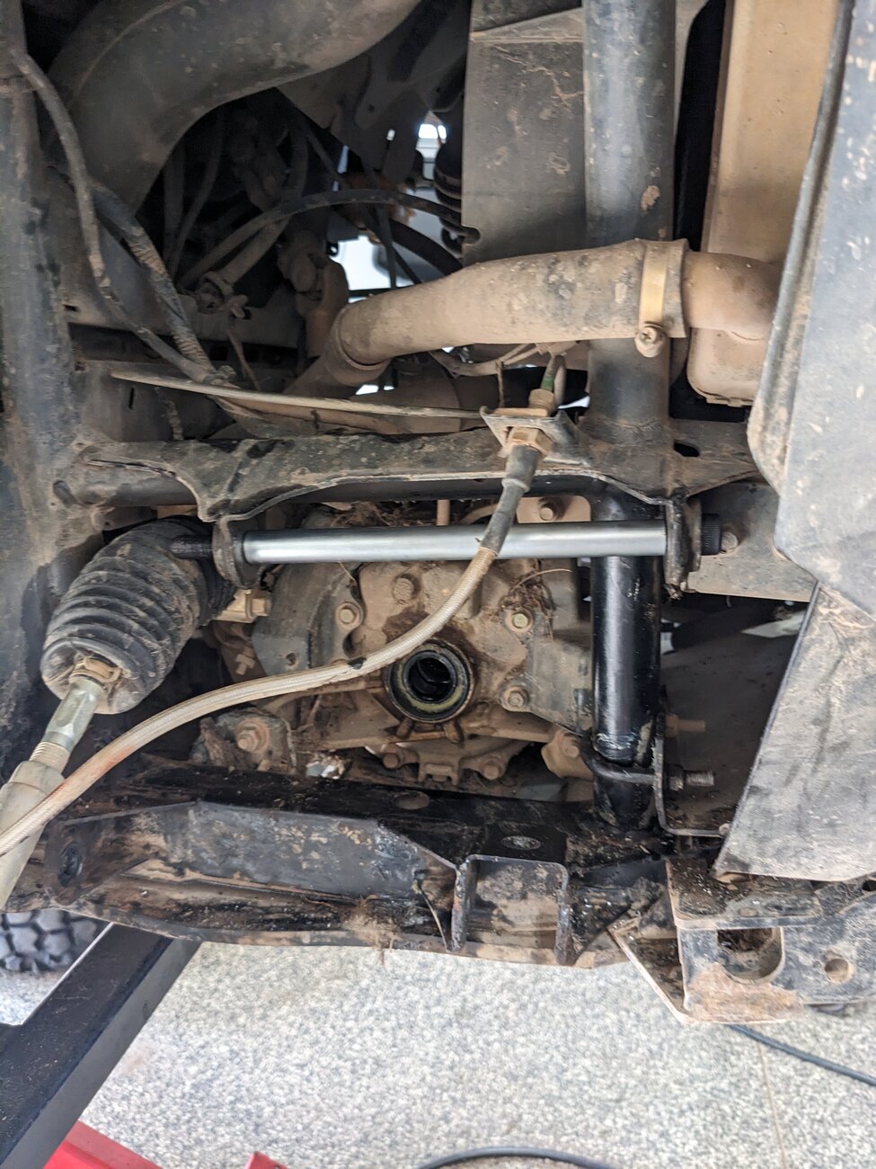

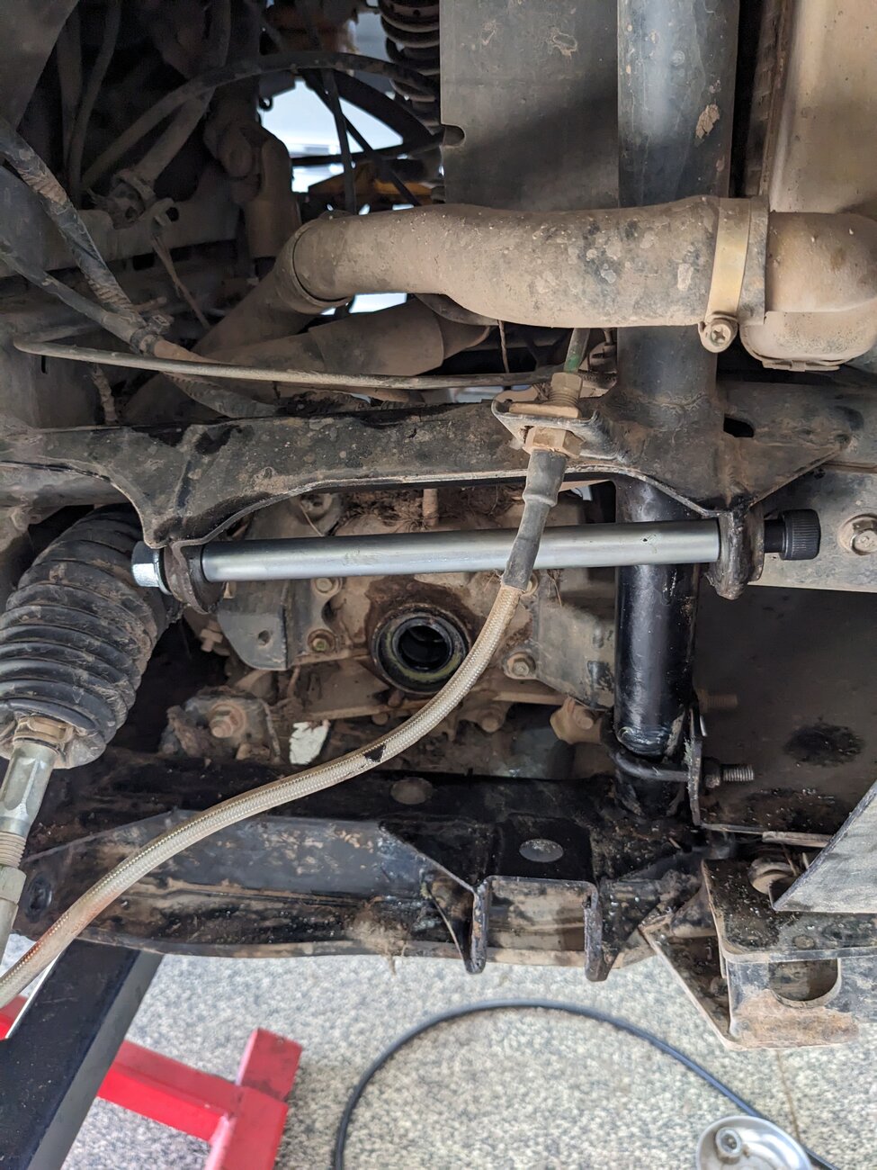

Passenger side is going together
The McMastercarr bolts measured out to .470 and were a good fit in the sleeves. I used a 1/2" unibit to drill out the a-arms tabs and got a nice round hole. One thing to note is my front a-arms tab weld washers are counterbored for m10 flange nuts rather than Allen heads so the m12 Allen head fit inside the counter bore. On the nut side it is larger OD than the counter bore. I'm going to look into a washer to fill the gap but I'll probably be ok on the flange with a double nut and red locktite.
Holes drilled and bolt in
Sleeve from @RB3offroad was perfect for my a-arms tabs and matched the OD of the m10 sleeve
Test fit on the flanged m12 deformed thread lock nut
Bolt and nut
@JenElio and @WagginTail . I provided the bolt and nut part number when I installed the parts on the previous page. I ordered mine without the bolts as I had already ordered them to check fit with my a-arms tabs

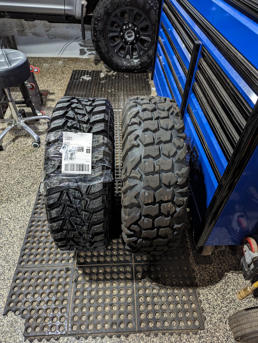

Alright, new vs old side by side both dismounted. The old one has about 1000 miles and has been mounted. The new one is very similar size.
Old tires were EFX motovators. 30x9.5r14

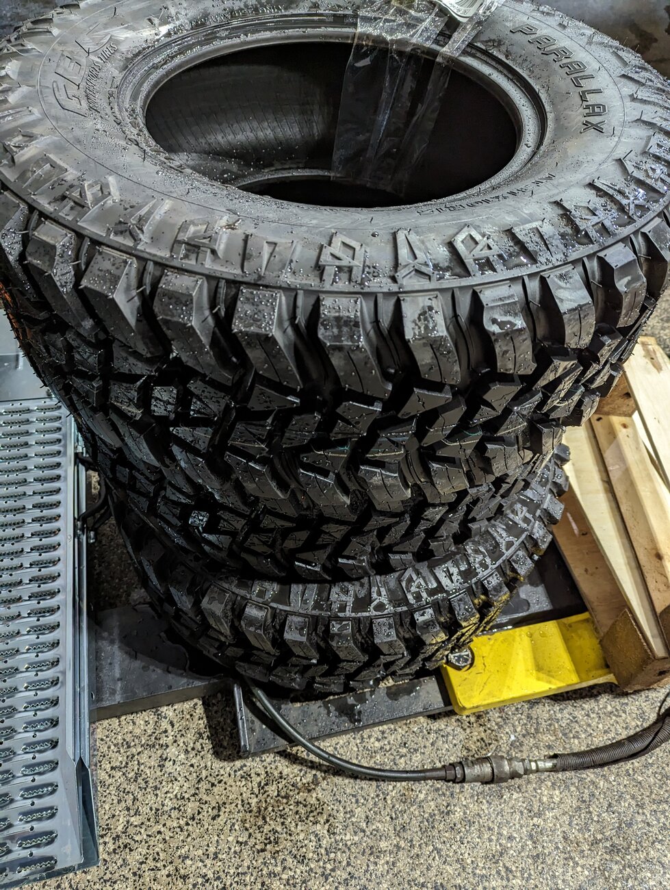

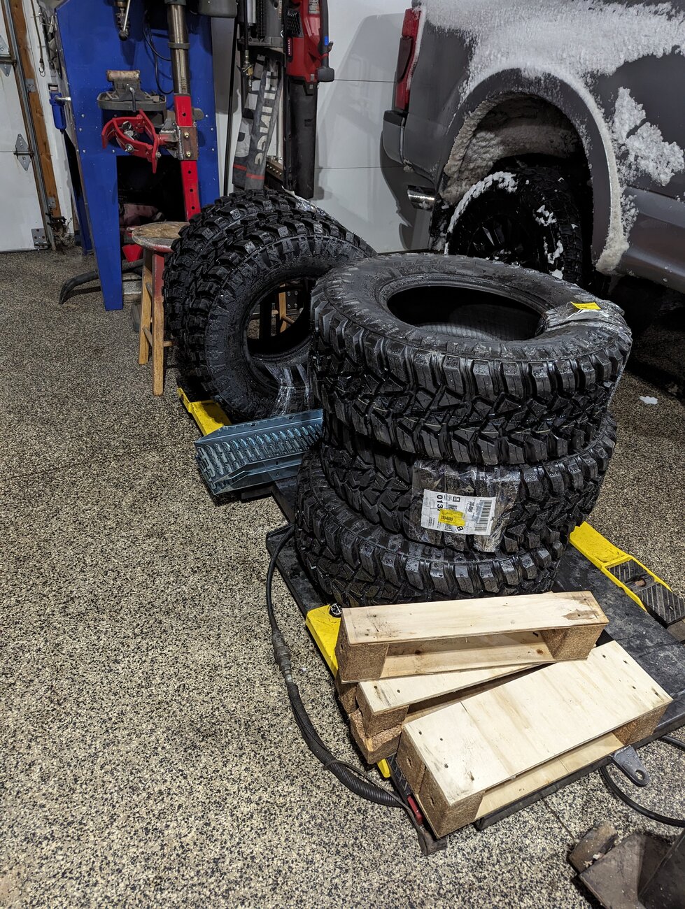

Got all 5 mounted today.
30x9.5r14 EFX motovators next to the new 31x10.5r15 GBC Parallax. The parallax is definitely lighter. I'll weigh them for comparison before I put them on the machine. The sidewall is quite a bit less aggressive but the tread blocks are very deep. Overall they are a little taller but a little narrower. I have them at 10 psi for now. The 10 ply side walls are stiff and they nearly seated the bead just mounting them. I think this will be a good low pressure tire
