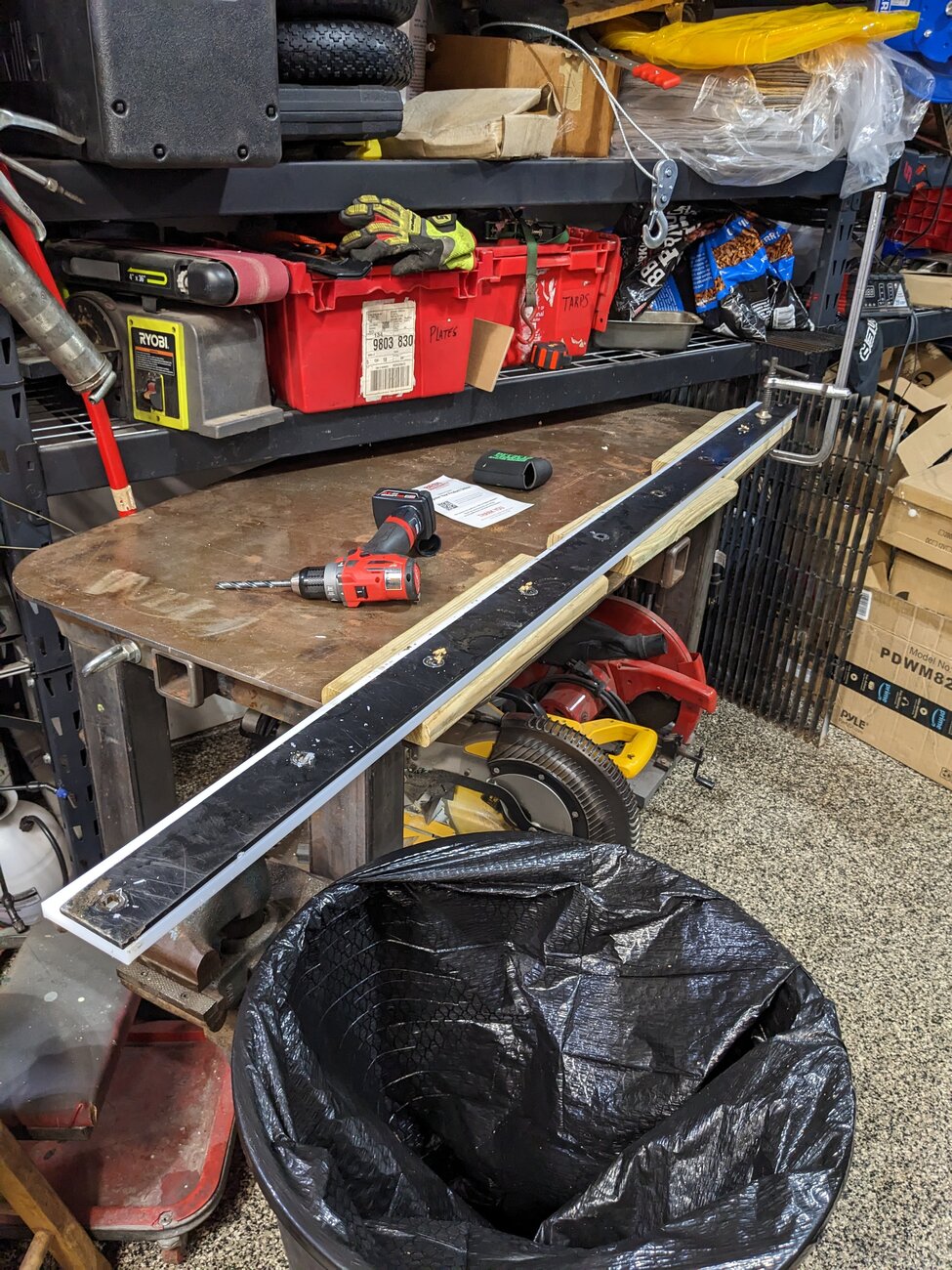

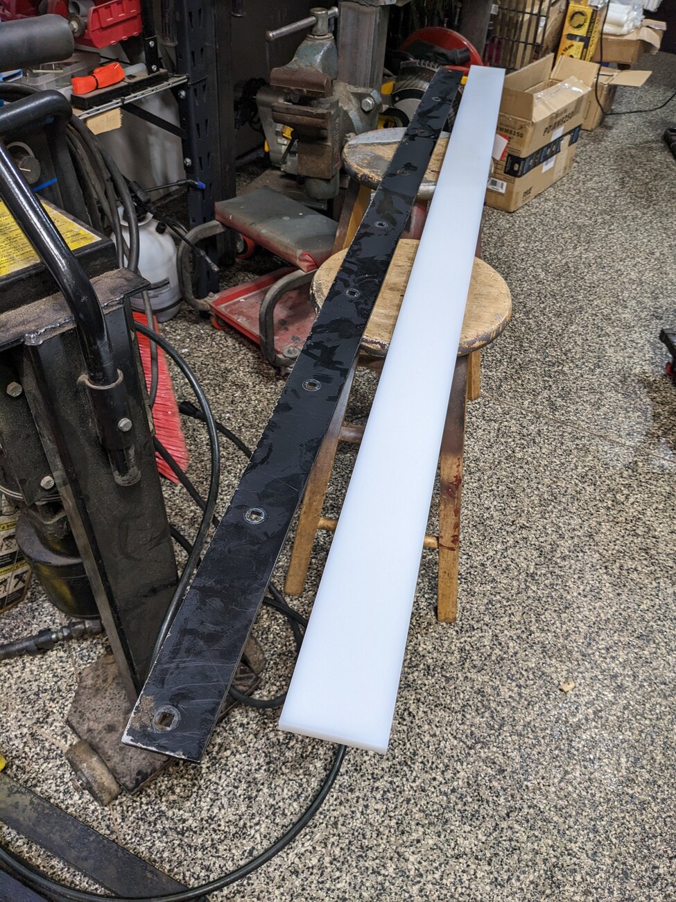

Made some snow plow upgrades today. Steel wear bar was showing some wear and is really loud on my concrete driveway. I picked up a 3x72" piece of 1/2" UHMW and made a new one.
Since it will probably come up, overlay the original wearbar and drill the holes to 2 size larger than the original carriage bolts but still smaller enough to fit in the square holes. Mine are 3/8 bolts and I used a 25/64 bit. I put all the bolts in place and heated the heads with a torch. I put blocks on bothe sides of the bolt and tapped the hot bolts into the plastic. The piece dropped right on the plow and the carriage bolts stayed tight as I tightened them by hand. They tighten down with the flange flush to the surface with light compression on the UHMW. Overall it feels really solid and only cost $25
