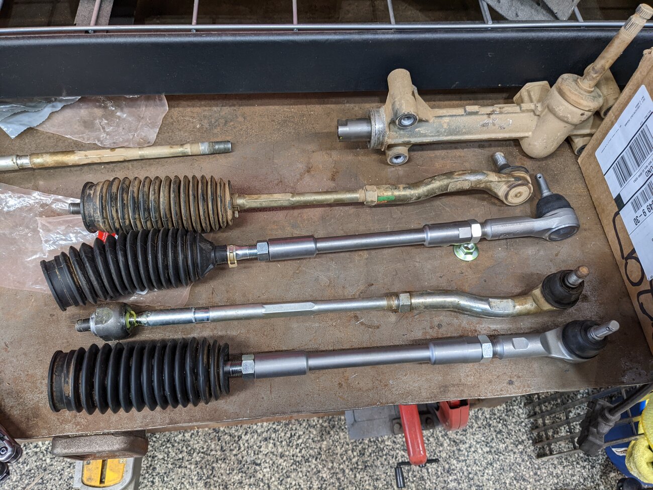

My 2022 tie rods came in today. Honda has already updated the parts manual to make these replacements for all the 2016-2021 machines and they are beefy with the exception of the smaller m10 but on the taper but they improved the nut to have a much larger flange. Pics and part numbers attached.
The new tie rods are 3 pieces and the inner tie rod link is now an M16 vs the old m14.

Steering rack went in without issue. Tie rods were wrong from the dealer. They were for a Talon X. My 2022 Pioneer tie rods should be here today or tomorrow.

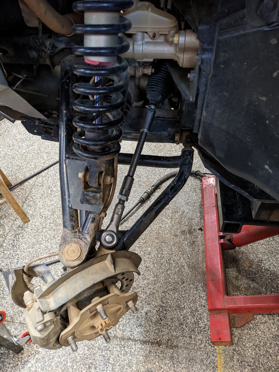

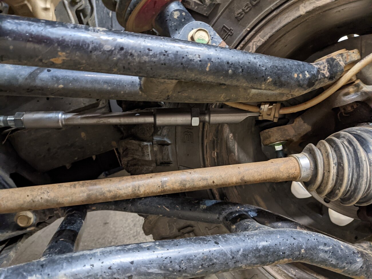

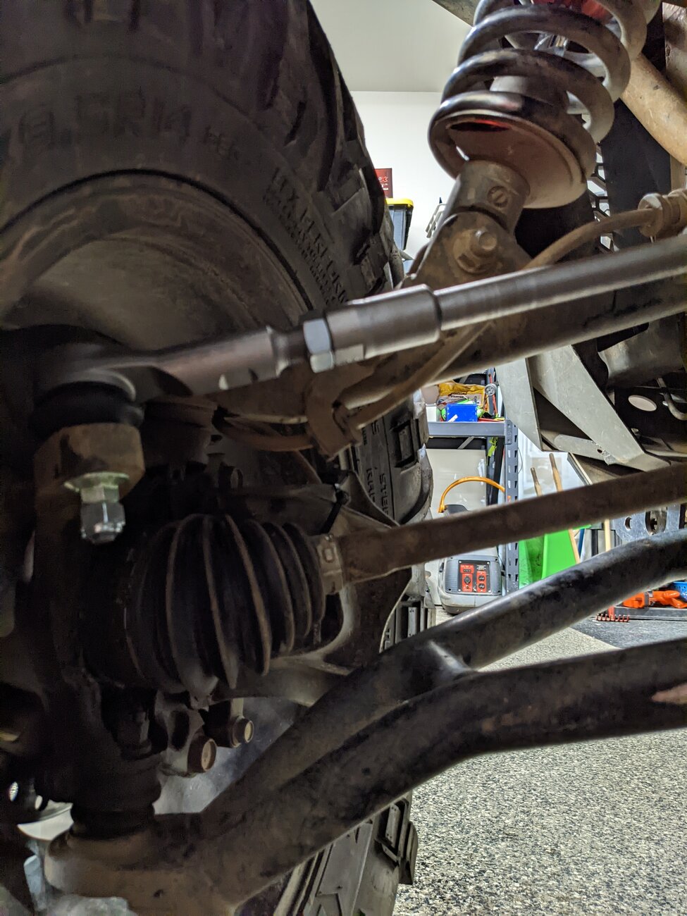

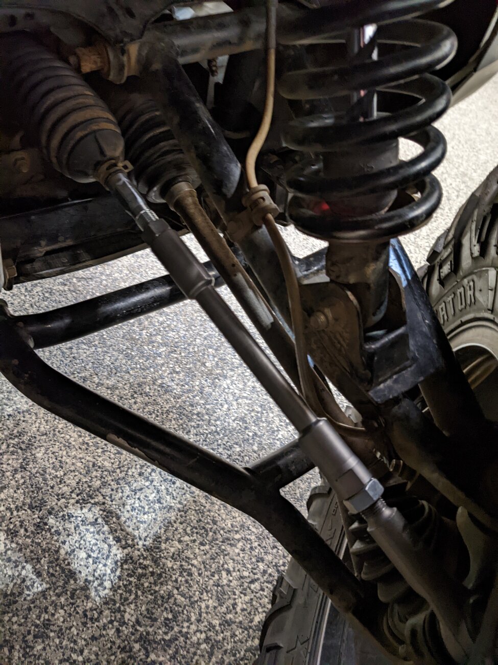

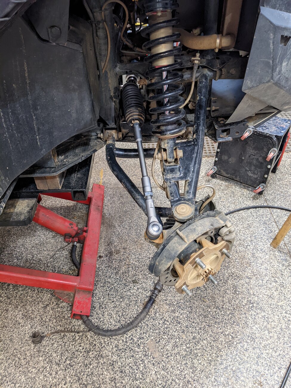

2022 Pioneer tie rods are a confirmed fit and they look good too. The outers match the Talon X and the inners are a beefier middle tube that the original tie rods. The geometry keeps the tie rod from rubbing my tires are full lock and pinching the brake likes with SuperATV arms.

Tie rods double nutted for her pleasure
