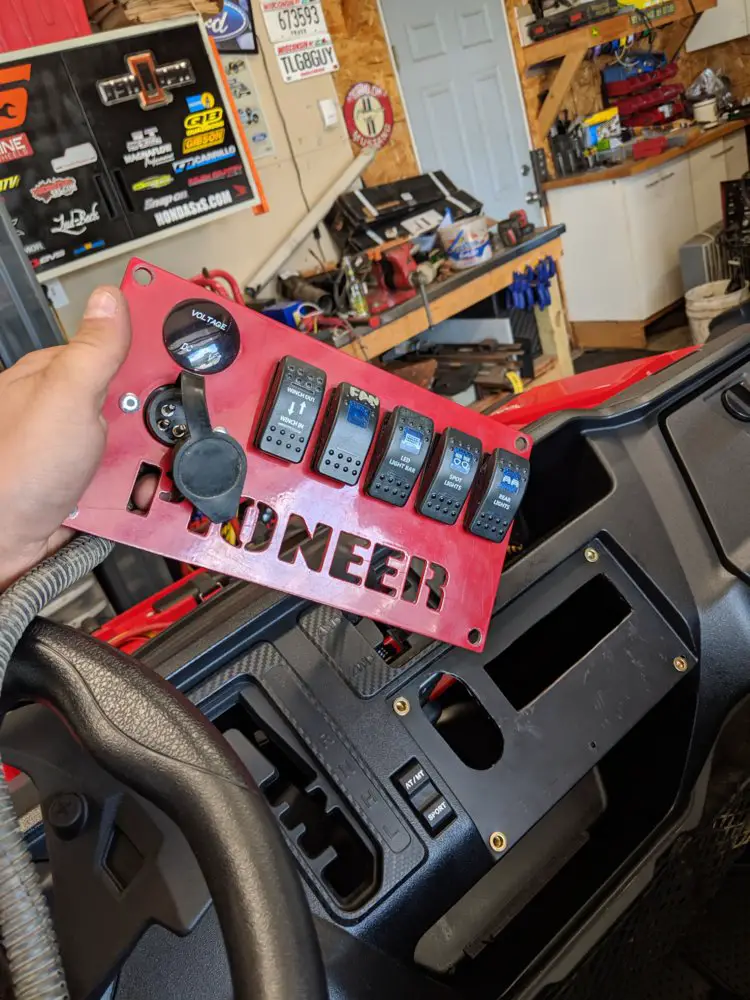

What is the plug under the voltmeter for?
It's the winch remote plug for my rear winch. I wrapped up my installation of my rear Superwinch Terra45 and I upgraded the front to a Traveller 6000 due to a corroded and damaged motor on my second Terra 45 and no parts available. I'm excited about the 6k front winch, similar line speed and power draw to the Superwinch and a wireless remote.

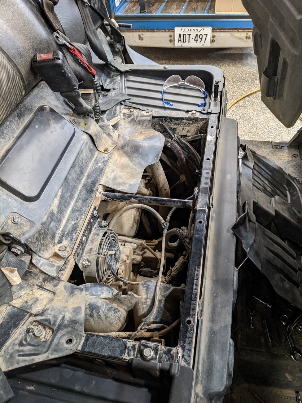

Been watching the 2022 parts thread and my 2022 upgrades have begun

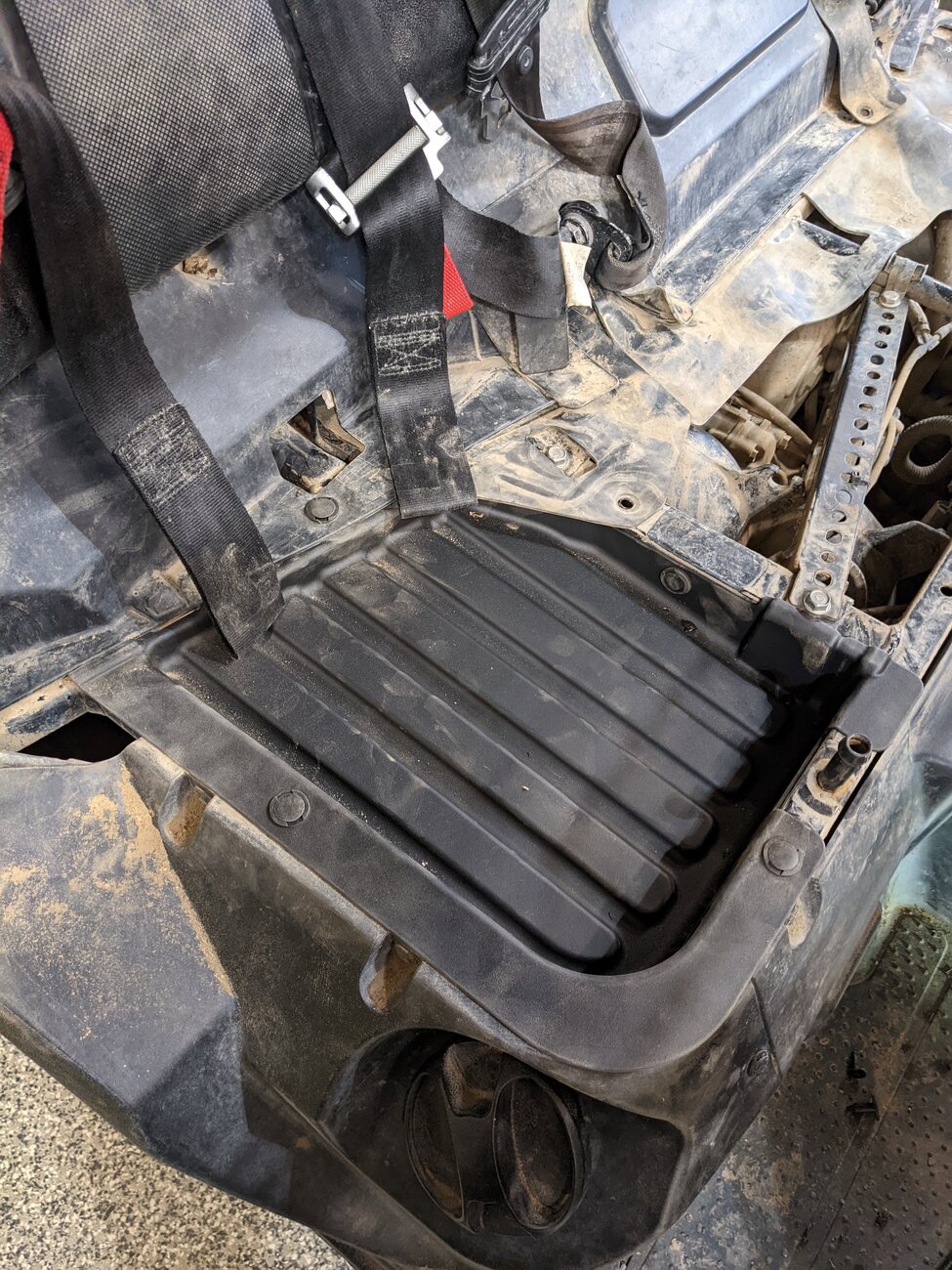

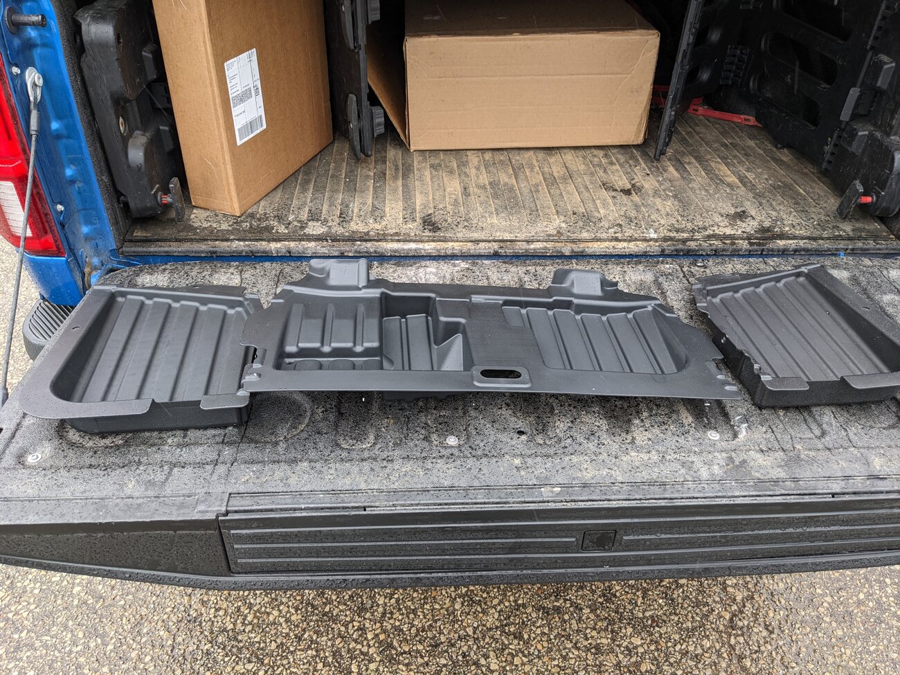

First up 2022 under seat panels
PXL 20220407 210859968

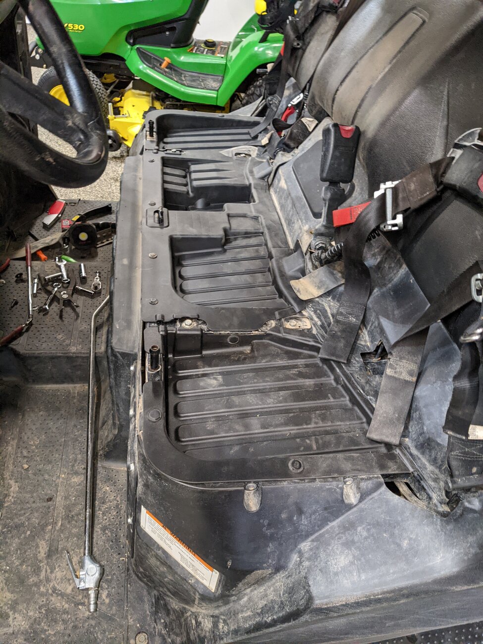

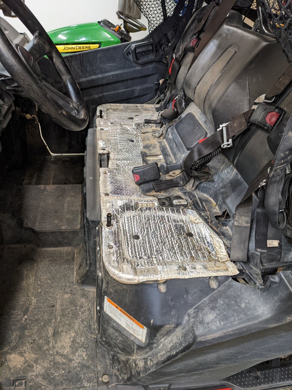

My under seat fan needed to be relocated and the new panels don't have the push pin holes but I added them. I really like the air gap under the seat. I'm hoping a little airflow between the seat cushion and engine compartment will help.
Old s***
PXL 20220408 191337857
Old fan location and right panel installed. Right panel dropped right in.
PXL 20220408 194225154
New fan location and left panel installed. I kept the seat belt rubber added with the Honda product improvement campaign
PXL 20220408 204228855
Center panel installed and push pin holes added. A sharp unibit works well for finding the holes in the seat frame, feel around for the soft spot and the unibit will guide to center as it drills
Old s***

Do you think it’s going to block the heat any better now that you’ve handled and installed it? I’m curious.
My expectation is that the large air gap will slow the heat transfer to the seat and allow some air flow between the panels and seat. The previous rubber flaps didn't seal well and didn't fit well so this can't be worse. Likely adding adhesive backed foam and foil will improve this new set up but I'm going to run it as is for a bit. With a tune and underseat da, it's not that bad. But for less than $100 at least this isn't a giant bandaid piece of junk

Those voids would hold a decent amount of foam insulation if one was so inclined... could probably help block the heat even more.
I'm looking forward to your test results... I'm inclined to copy if it works well.
I’ll be waiting for your over time review but it looks to be better than the rubber for sure.
