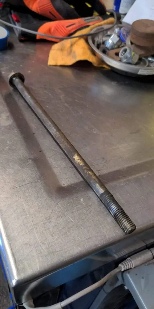

The last 2 rides I've been fighting a wandering alignment. I think I figured it out. Fairly confident I bent the upper a-arm bolt riding with the guys in the UP which kicked my steering wheel left. We played with the alignment but it still felt sloppy. I bought toe plates and thought I had it better but it still seemed to change steering wheel position on center once I started riding. 130 miles into a 160 mile ride on Thursday the culprit came out.
I skid to an abrupt stop about 1 vehicle width off a trail. The steering wheel was pulling hard right, I was steering right, the machine went left. The front tires were dragging so hard I barely had to brake.
IMG 20200920 171957

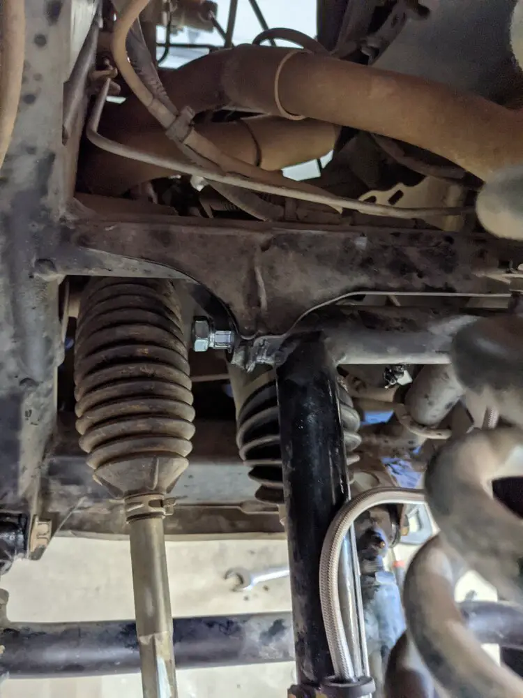

In a state of confusion I looked at the left front tire and noticed it wasnt steering. No big deal we have spare tie rods.
IMG 20200918 192302
That's not a bent tie rod
IMG 20200918 192304
Upper a-arm bolt broke. Well I had a spare one of those too. I guess you could say the weld washers, beefed up a-arm tabs and grade 8.8 bolt worked. Bolt broke but the new one slipped right back in. Had it fixed in about 20 minutes

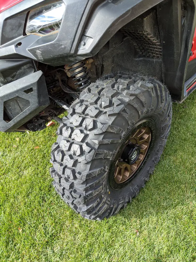

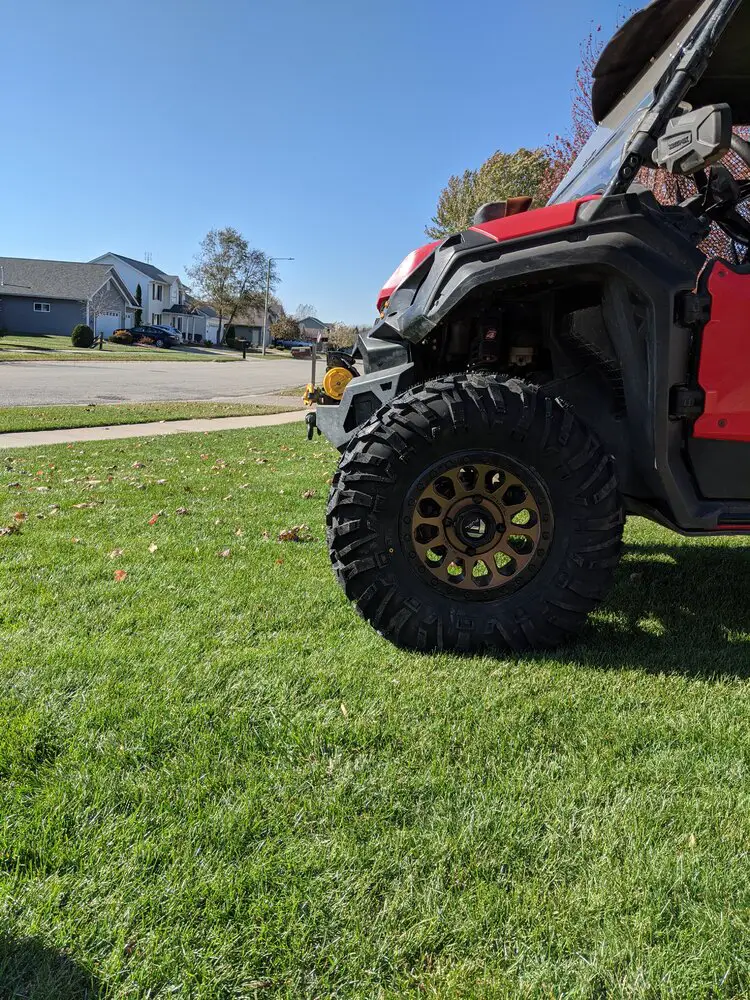

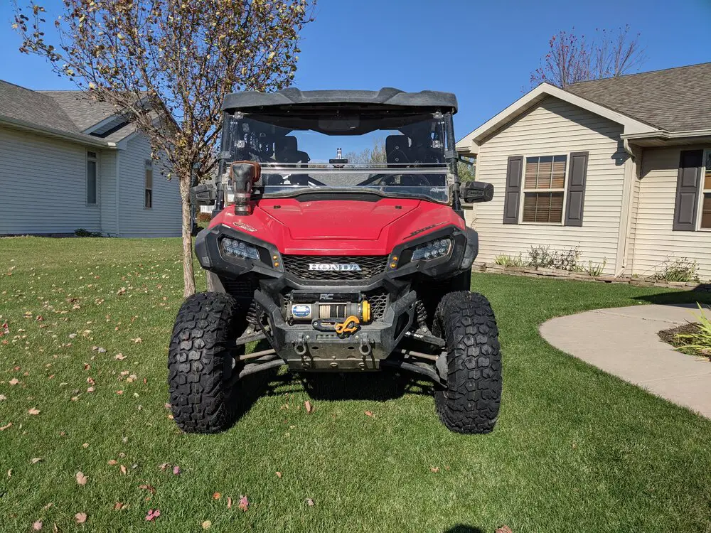

There's a chance next summer will be hard on parts. Out with the Quadboss QBT846 in a 28x10 and upgrading to EFX Motivators 30x9.5.
Old tires were 54 lbs mounted, new ones are 66 lbs mounted.

Looking forward to having some side lug for climbing ruts

How much air pressure are you running in these bad boys?
The new tires look rock hard at 12psi. They have a 1250 lb rating at 15psi so by comparison the old tires were 535lbs at 24psi, I ran the 28s at 13.5. I'm guessing I'll be dropping the pressure to 8-10psi
Ran my ITP's at 7.5 yesterday in rock crawling trail cruising mode, that included a couple of two foot rock ledges and a lot of nasty rocks. No winch was used. Today we revisited a trail that had been shut down for several years, it was rough, we were crawling over and down creek banks with two foot high rocks, got very interesting and no break downs. About flopped, had to gas it and hit the the big rock on the down hill side to keep me from going over. We had a blast

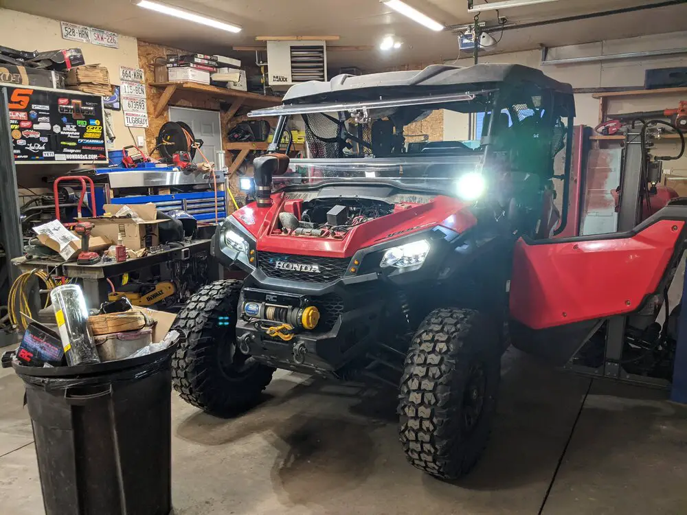

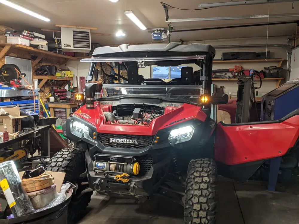

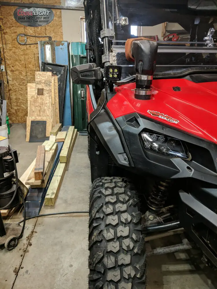

With my 28s and forward arms, I found my headlights were always dirty. I'm not convinced these will be a lot better but I added a-pillar cubes with daytime running lights. They are Rough Country lights and brackets.

Let me know how you like those, I’ve been looking at a set of those to add up high for some side lighting.
They look good. I wanted another pair of X5s but RC doesn't sell them anymore

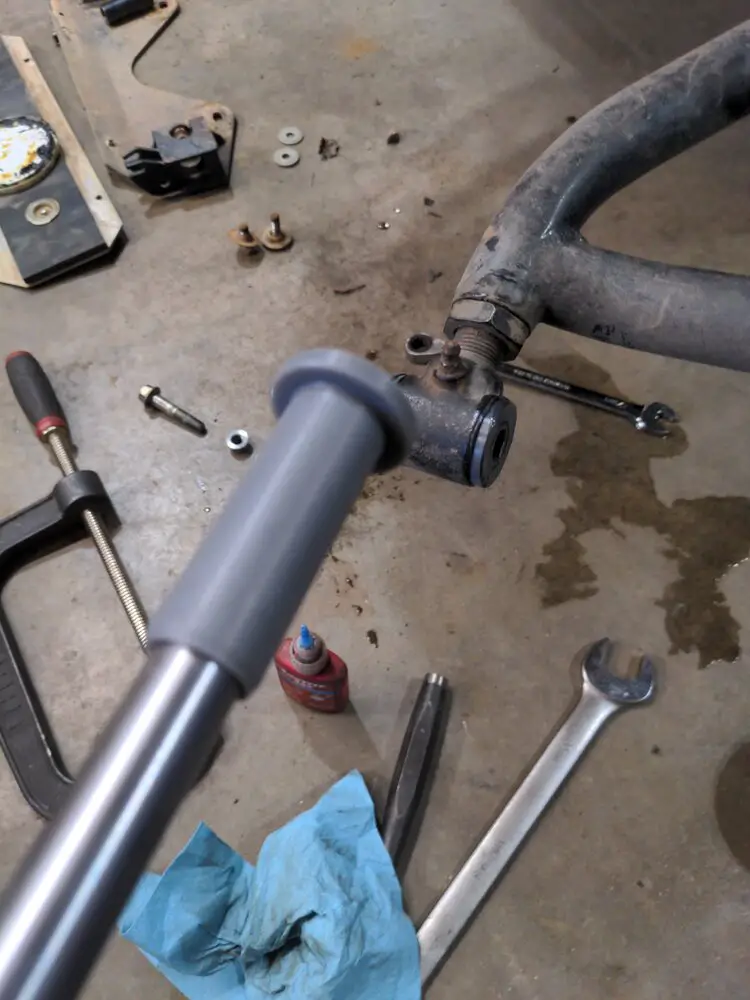

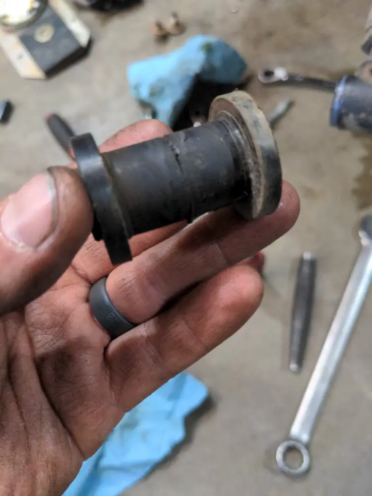

My garage products front a-arm bushings finally came in. Really nice product.
Pins and bushings are high quality and fit very well. I lubed everything as I installed them.
IMG 20210122 142323 01
The stock bushings looked pretty rough. As I recall I installed the arms without removing the bushings and lubing all the surfaces.
IMG 20210122 142100 01

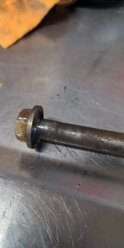

I replaced both upper control arm bolts and added a jam nut. From what I can tell the right upper control arm bolt lost clamp load and started to bend as it wore through the threads
Received 1780962332052049
Received 1337839093241247
Let's hope this solves the problem. It's likely the broken driver side upper bolt from August was due to lost clamp load too.

My passenger side never loosens up. I added a jam nut on my drivers side and it still loosened up. I'll have to see if I still have the bolt, but it looked like it worked the nylock nut loose then stretched the threads and loosened up. That was before I put the RB3 bushings in that would actually take grease. New bolt, nylock nut, and no jam nut and it was still tight after 3 days in TN. I drilled out a bolt for a castle nut and cotter pin if/when this one works loose.
