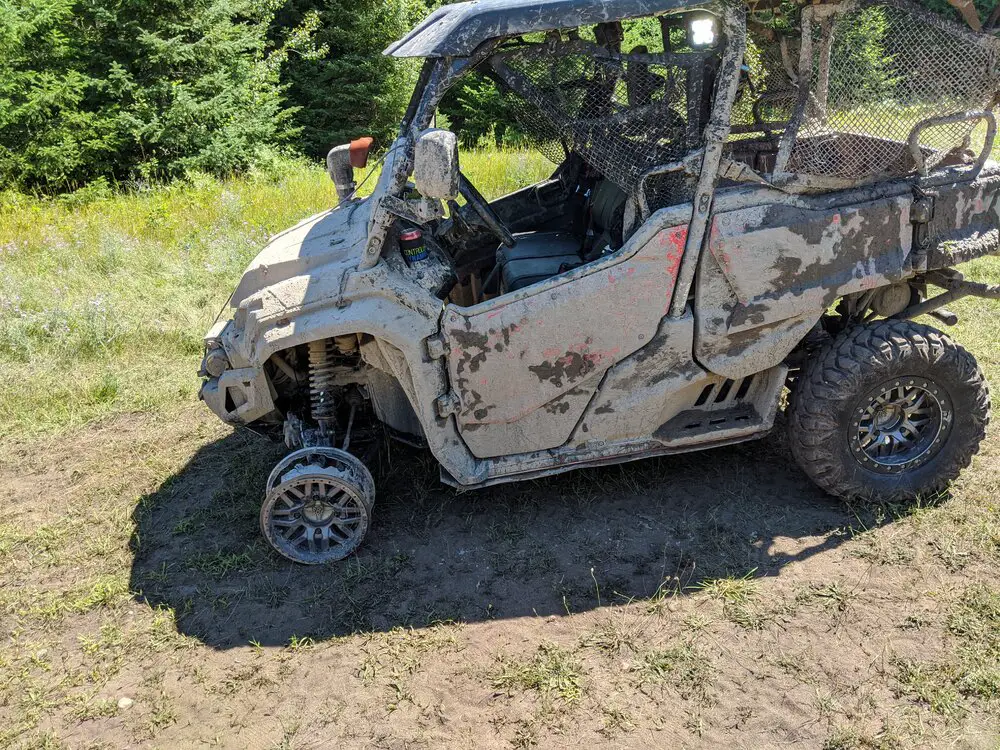

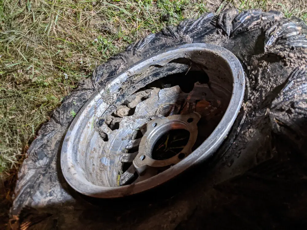

Had a rough night last night. Got stuck in deep gravel and mud. In an effort to rock it back and forth both front wheels shattered. Bent both front rotors and caliper mounts and broke the left front rotor off the hub. The rocks got bound in between the calipers and wheel. Both wheels blew out at the same time and the tires went flat.
Looks like both front tires are still good. Pile of parts on order to get this thing running for next weekend.
View attachment 216140View attachment 216141View attachment 216142
I thought 1 spare wheel and tire would be ok...

We had to take the smallest trailer in our group and tow dolly it back. With the left front rotor broke off it wouldn't roll

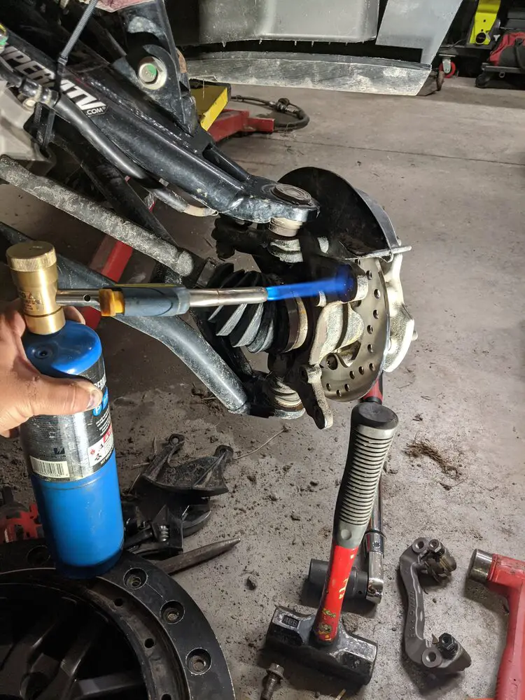

Bought 4 new wheels today. The 2 replacement Raceline wheels won't make it here for our next ride on Sunday. Currently working on squaring up the ears on the left front knuckle to fit the new brake caliper and mount.

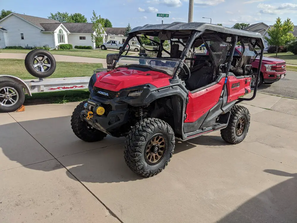

Good to see her I one piece again
Ready to rip.

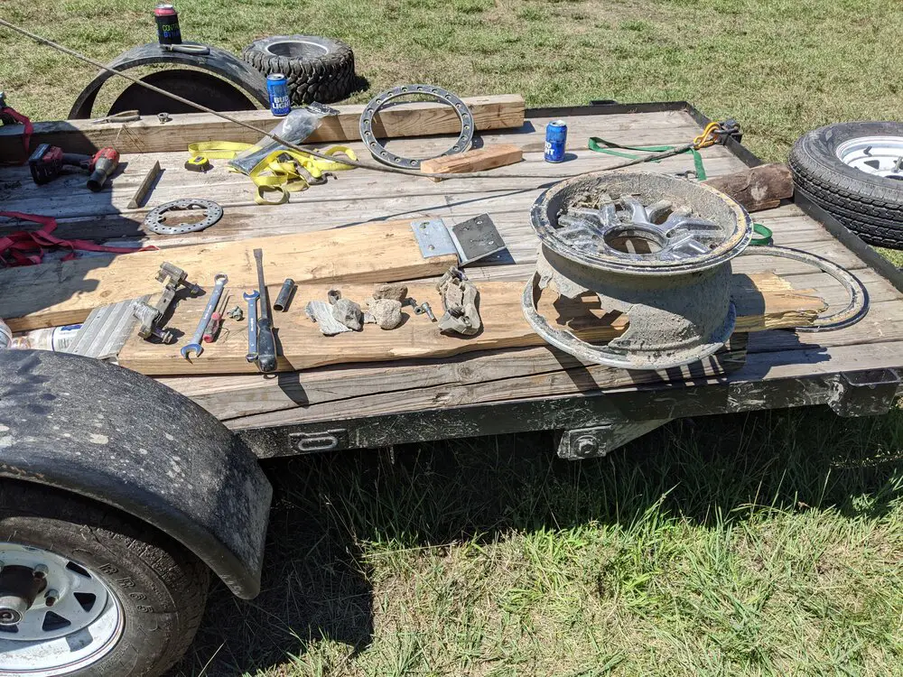

Official damage report from Drummond Island weekend 2020
2 cracked front wheels Raceline Ryno Beadlocks
2 damaged front calipers 1 bent, 1 heavily rock damaged
2 bent caliper mounting brackets (1 broke/cracked)
4 bent caliper slide pins
2 bent front rotors
5 broken rotor bolts (replaced all 8)
1 bent knuckle (pounded straighterish?!?). On order but not gonna be on for this week
All the front brake pads destroyed
1 broken mirror
If anybody has interest in 2 Raceline Ryno wheels in decent condition, let me know. 14x7 5+2

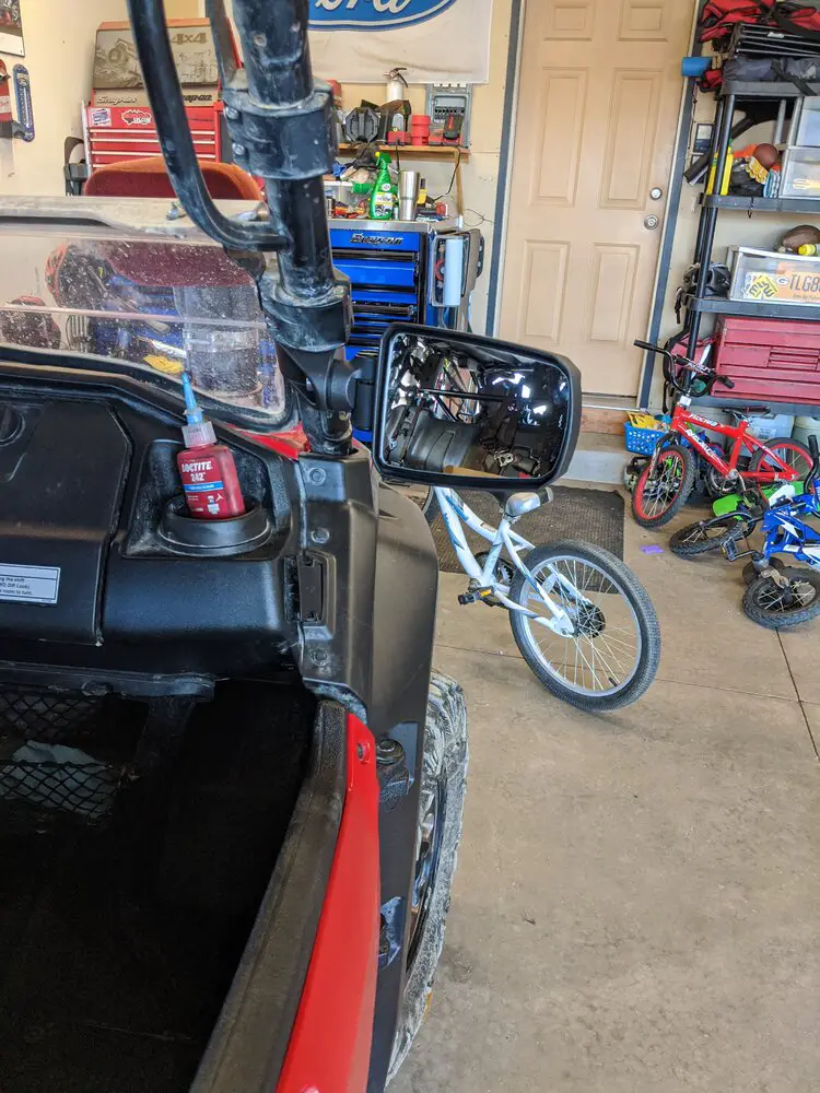

Does anyone make mirrors that don’t reduce the size of everything?
8,240
62,204
I couldn't stand my chase light being offset to 1 side so I bought a pair of amber lights to replace it.
Nice, those look like what I used. Thought about scuffing mine to diffuse the light some. I only used one in the middle so I've still got an extra if it doesn't work out.
